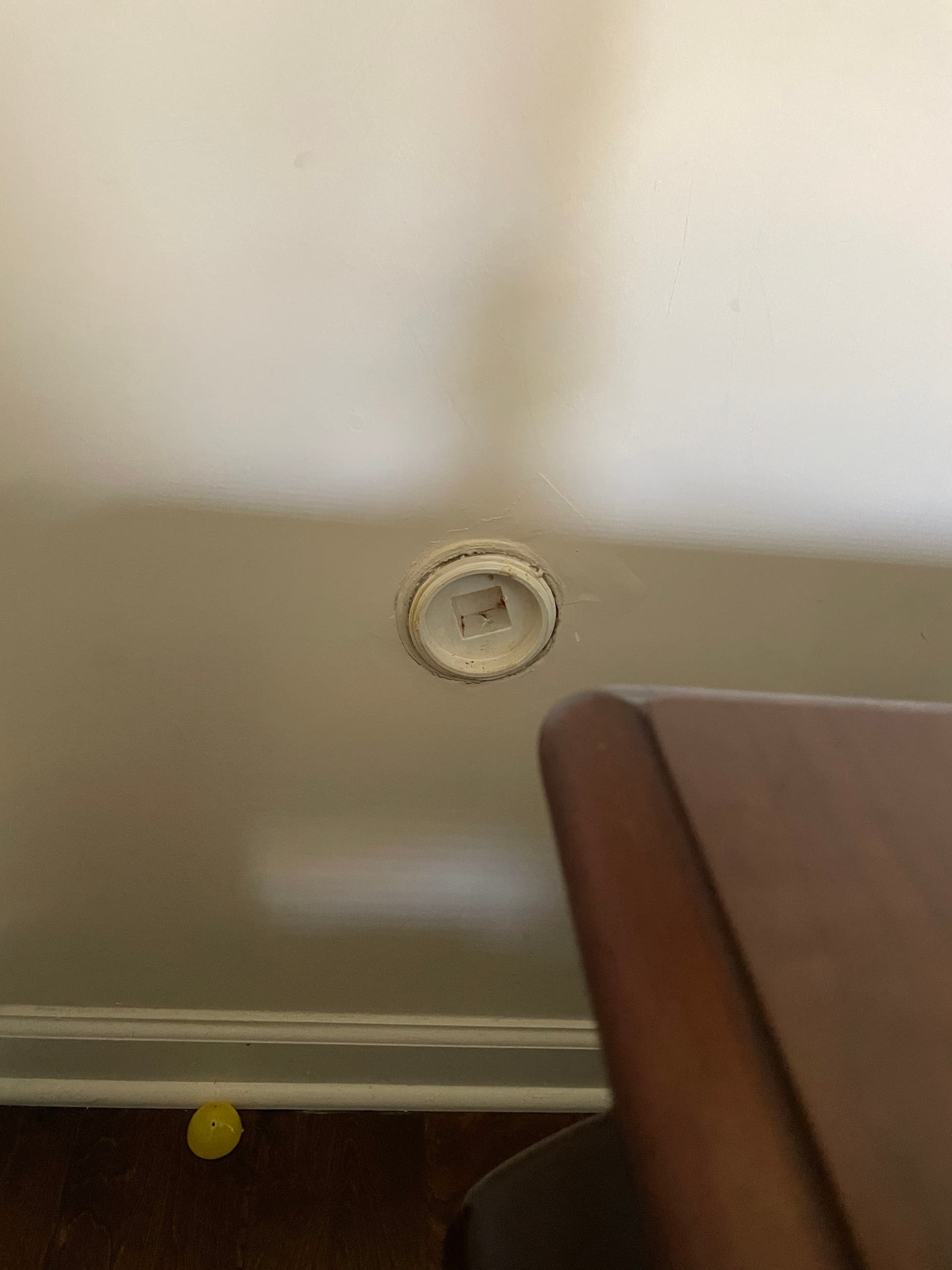

I wasn’t sure if this was interior or plumbing. There is a plumbing clean out in the living room. What would be the best way to handle this. in report: “For your information this is a plumbing clean out. This is not a defect purely cosmetic”
Why comment? If I did comment it would be for information purposes.
One sanitary sewer clean-out is located in the living room. Lateral clean-outs are located in the front yard. This is for your information.
IMO no comment needed.
I would be happy that they left access to it.
I’ve seen some that drywalled right over it. Cosmetic problem fixed, until you have a back-up. :wink:
Write what you see.
I would comment as informational. I wouldn’t be definitive about it unless it was opened and confirmed. Something like that would make a nifty wall safe. :wink:

Never seen an exposed inverted vertical drain waste pipe clean out plug on a living room ceiling, ever. As well what appears to be a steel column to support structural flooring beam loads in such close proximity.

5.4.4 Cleanouts for (Concealed Piping)
Cleanouts for concealed piping in finished walls or ceilings shall be accessible through access doors or cover plates which provide clearance for removal of the cleanout plug and insertion of the drain cleaning equipment.
Observation: Inverted Vertical waste drainpipe clean out plug exposed on the living room ceiling. Missing access door or cover plate to conceal the waste plumbing cleanout plug and waste pipe.
What photo are you looking at?
From the OP.
Missing the clean-out cover!
This is the wall not the ceiling.
I will write it up as informational. Only reason to comment is that is because it is so noticeable especially once the furniture is moved I don’t want the client to think this was something I missed. Or something that they wish they would have known about.

Never seen an exposed inverted vertical drain waste pipe clean out plug on a living room wall, ever.

1: The clean out plug is deficiently installed. It is inverted.
2: The wall assembly, framing and wall board, do not allow for the waste plumbing pipe and clean out plug to be hidden and accessed.
What downstream “restroom,” “washroom,” “toilet,” and "lavatory, laundryroom is within close proximity?
Observation: Inverted Vertical waste drainpipe clean out plug exposed on the living room wall. Missing access door or cover plate to conceal the waste plumbing cleanout plug and waste pipe."
Recommend a licensed plumbing contractor property assemble an access and door or cover to conceal the plumbing clean out plug and piping.

I think what Robert is trying to tell you is that he thinks your picture is poorly lit, poorly focused, composed from a bad vantage angle and you should think about taking some photography lessons and aquire some equipment such as lighting to greatly improve the quality of your reports.
The home inspection report is the work product that we deliver to our customers. If you include crappy photos in your report it will reflect awfully on your competence as an inspector and you will have a hell of a time convincing anyone that you know what you are doing.
Next let’s fix your narrative. A clear narrative is essential to your reporting.
There are three components that you should strive to include in any narrative.
  1. state the issue
  2. describe the ramifications
  3. recommend a course of of action.
For example:
“A sewer cleanout cap was visible next to the wooden end table on the left side of the living room by the fire place. This is an odd place to install a sewer cleanout and may be considered by some people to be an eye sore. I did not remove the cap to verify that the pipe system is clean inside or in fact if the cap is easily removed because doing so is beyond the scope of a standard home inspection. If the presence of a sewer cleanout in the living room bothers you, consider having it relocated to another location by a licensed plumbing contractor.”
Or something like that

The image certainly appeared focused vertically, looking up, not horizontally - laterally at the wall.
The subjects angle of orientation should have been taken further back to include pictures, furniture, and distinguishable flooring.
