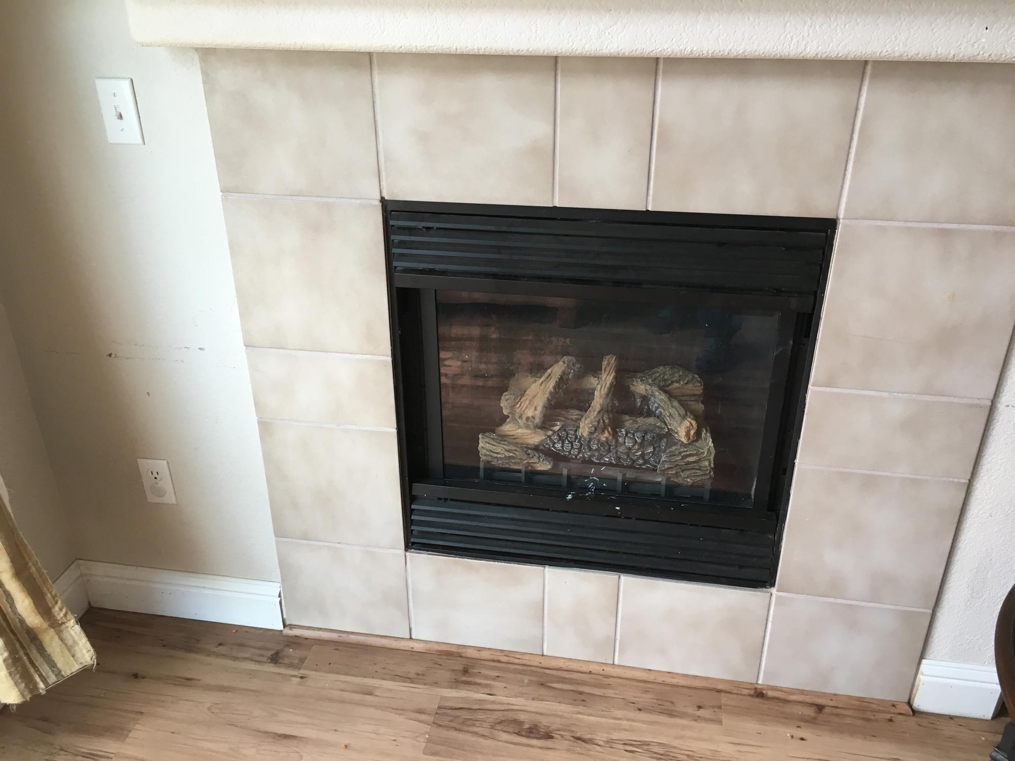

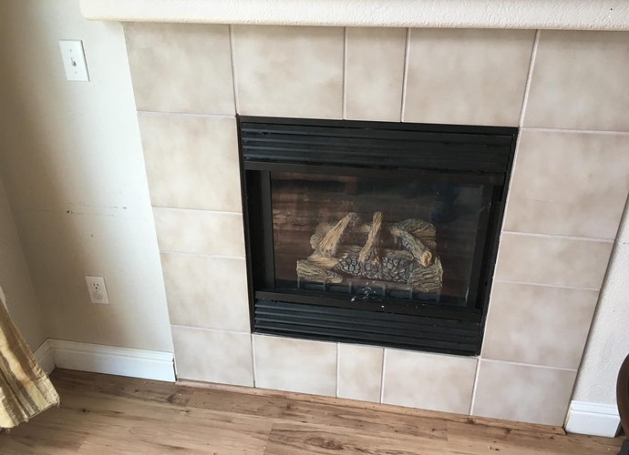

The 2 images are of a gas insert fireplace. As seen in the darker color of the infrared image, cold air is entering the interior of the home around the fire place, as well as the outlet to the left of the fireplace. Energy loss.
Nice photo, Jason! What camera are you using?
