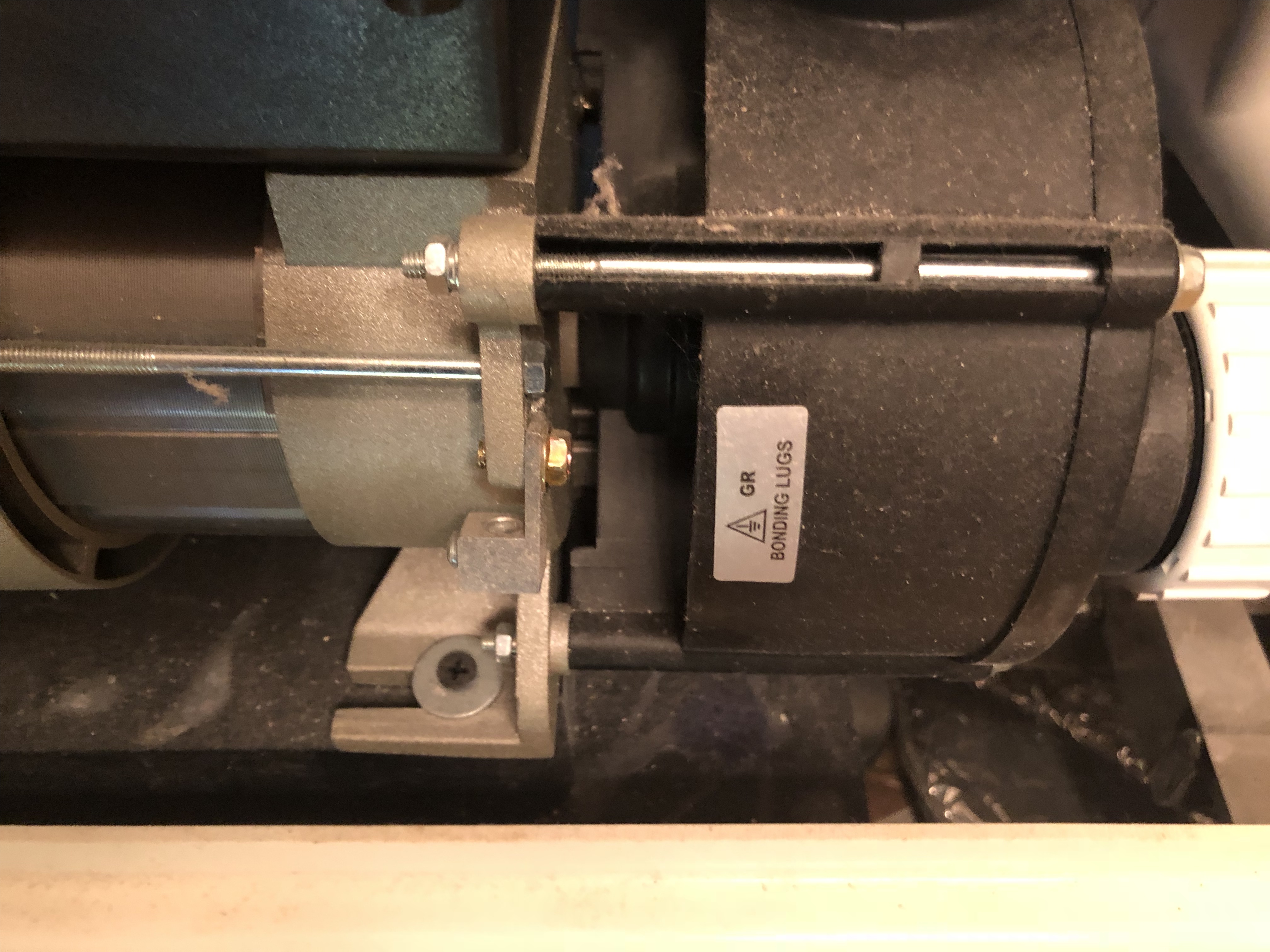

Jacuzzi motor bonded or not?

Suppose the tub has one motor and is plumbed with plastic pipe. Where would the bonding need to be?

Exactly! But what do you do when the cover is off of the unit when you arrive and there is a factory installed bonding connection looking right at you?

The curious thing about most of the Hydro massage pumps is that there are no metal parts contacting the water. Pumps are some kind of plastic with rubber impellers. Same thing is true of washing machine motors. The motor itself is either double insulated or equipped with a grounding plug into a GFCI.

I agree with all of that. BUT the OP’s question is about Bonding the motor/electrical components, Not if the motor is grounded or not. In the photo above what would you Bond the motor to?
All the pipes are plastic
LOL, I only changed one word to clarify what was one of the most misinterpreted code sections in the previous versions of the NEC. I guess that someone didn’t like this change because the entire section was re-written in the 2017 to include the bonding of metal parts within 5’ of the tub like a pool.
