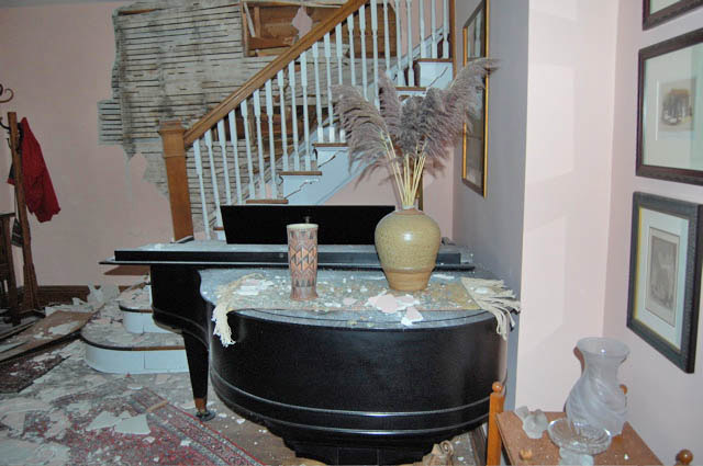

http://www.pioneerlocal.com/wilmette/news/474354,g4-chimney-071907-s1.article
Pretty windy day for you :lol: :lol: :lol:.
How about something to hold the goddarn thing from falling over. ha. ha.
Don’t think I would lean a ladder on that puppy to check it out. ha. ha.
Marcel
There seems to be little to be said about the craftmanship. Except what the ____?
The chimney is probably leaning because the mortar on one side eroded faster than the other. Keep your crowns high, young men.
When that falls might create a mess.

Great pictures of the leaning chimney. Needs support, correction and TLC by a well established, competent, qualified contractor.
Did you also see the condition of the shingles? You get two problems for the price of one. Check out the newer shingles on picture three from the left. Wonder what else could be deficient in this place?

Back to the leaning chimneys. Lots of chimneys with that gentle curve is the result of the mortar joints “expanding” on the convex side as opposed to deteriorating on the convex side----due to differing freeze/thaw cyles on the North and South sides of the chimney and direction of prevailing weather.
