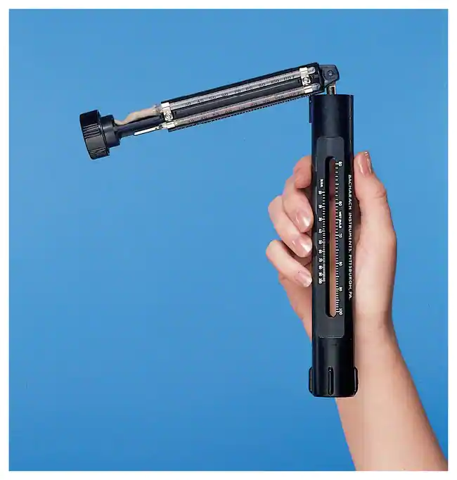

Anyone know where I can buy a good inexpensive sling psychrometer?

I have the exact one, still in the box if you need one! :wink:
I have one as well. Just not that particular model. My days of needing it and many other tools changed from when I transitioned from HVAC to home inspection. They are packed away as their use far exceeds a home inspection. My response to the humidty meter statement is in regard to inspectors having unreal expectations when the simply buy a tool.
