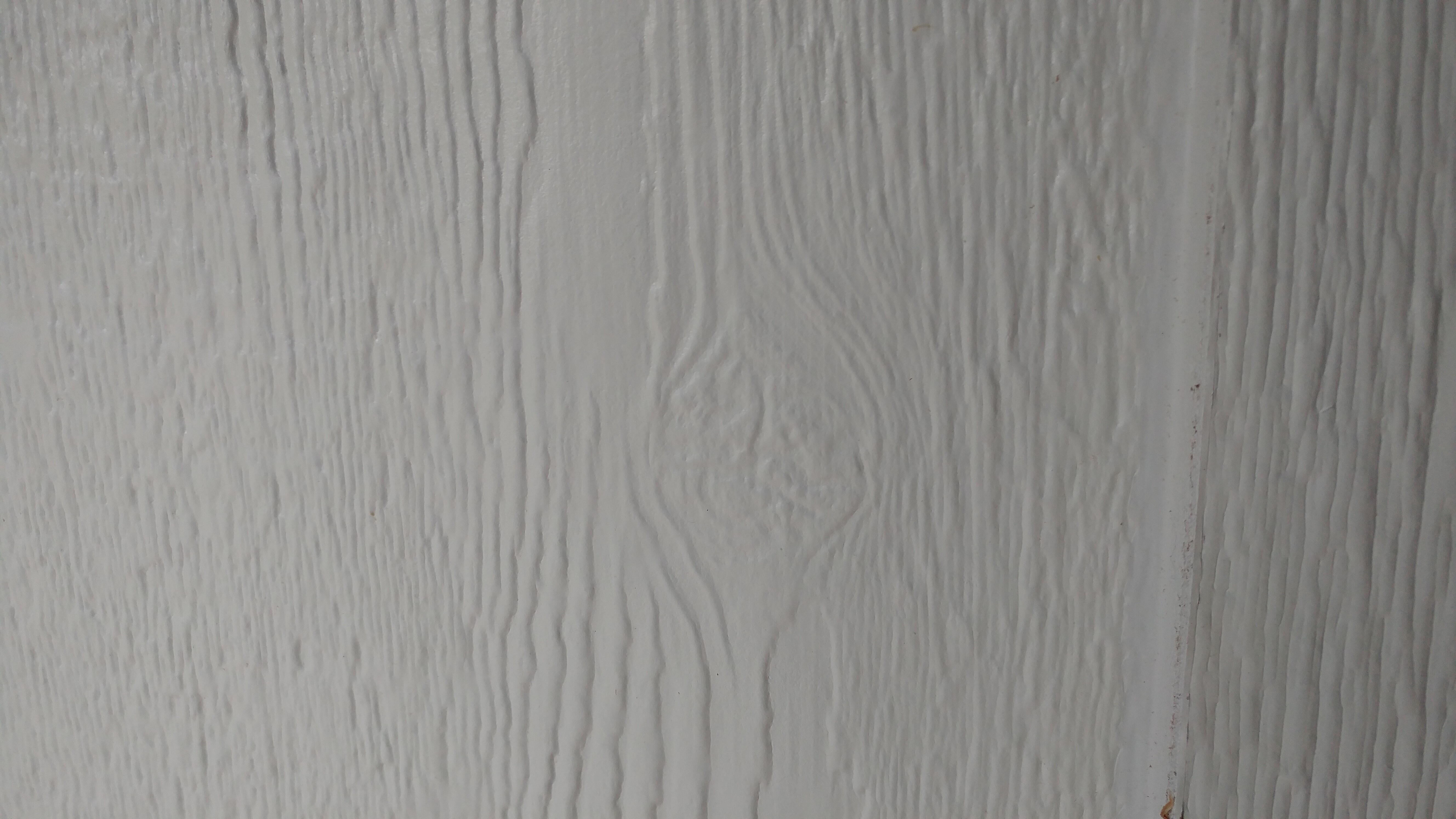

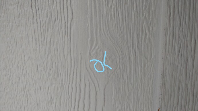

This is from an inspection today. I’m pretty sure this is LP siding but onsite and now looking at pictures, the more I stare at the knot, the more I think my eyes are playing tricks on me. Any confirmation or correction would be helpful.
Any pictures of butt joints, end joints or bottom edges? Any swelling, saturation or delamination?
Compare with this Joe:
LP

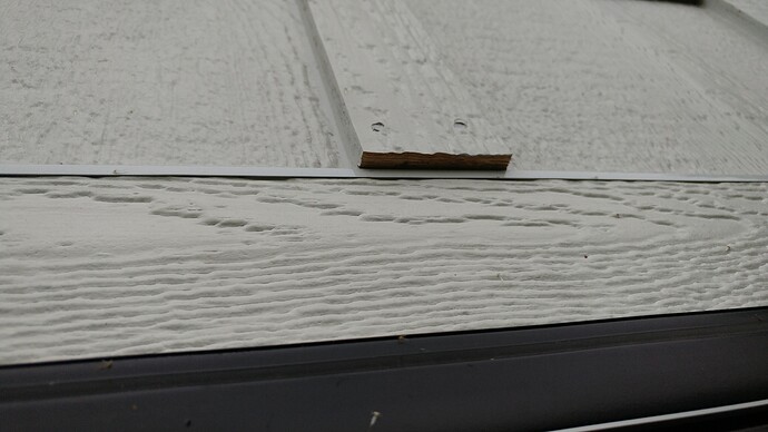

Brian, there was no swelling or delamination. This house was renovated over the last year or so and siding is new. Here are a few more photos:
IMO, that is a composite wood siding. Some people call it hardboard. It is not cement fiber siding or sawn plank board. LP is a brand name, stay away from brand names unless you watched it come out of the package and installed in front of you or it is stamped.
Those cut edges should be painted.
In your final photo, that is OSB plywood (oriented strand board) and it is not exterior rated. It will deteriorate as installed.

It’s probably actually a strip of LP Smart Side. That is what the unfinished side looks like. If my bearings are correct on the orientation of the picture, it is not meant to be installed like that. At least they did paint the exposed face.

It looks like Smart Side siding from LOWES. :thinking:

T1-11 OSB siding.
I feel like the grain on T1-11 is no where near that pronounced. It is a smoother texture.

Definitely LP which used a OSB panel as the base coat. If it is meticulously maintained and painted it can last decades. Although sold as a lower maintenance exterior siding is still actually a high maintenance product and the lowest cost siding on the market. So you will see it on a lot of starter and low end housing. That knot repeats if you look at a larger area.
