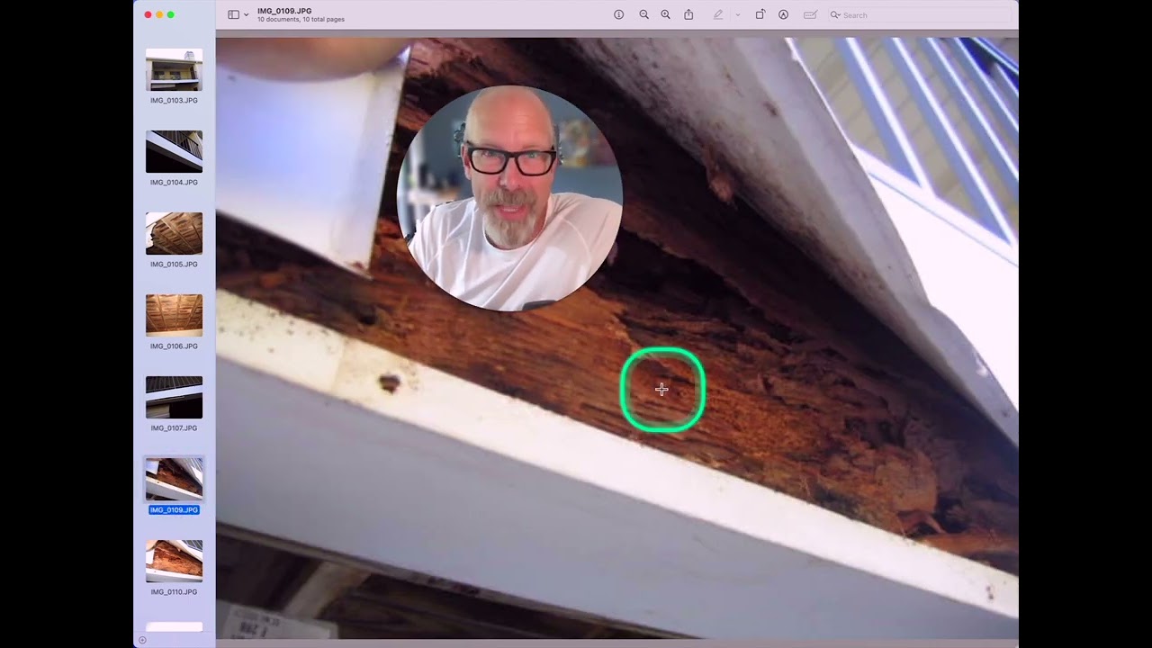

Material Defect at Rotten Deck Beam
A home inspector should check under aluminum capping on wooden load-bearing deck parts because that’s where hidden problems love to hide. The aluminum might look like it’s protecting the wood, but it can actually trap moisture that gets in through tiny gaps or worn seals. Once water gets trapped under there, it creates the perfect conditions for wood rot and bug damage that you can’t see from the outside. This is especially dangerous on load-bearing components like beams and posts because they’re holding up the entire deck structure. What looks like a solid, well-maintained deck component from the outside could actually be rotting away underneath that shiny aluminum cap. By the time you see obvious signs of damage on the outside, the structural integrity might already be seriously compromised. That’s why experienced inspectors know to look for ways to peek under capping or recommend further investigation when they can’t properly assess these critical structural elements—because a deck collapse is definitely not something anyone wants to discover the hard way.
