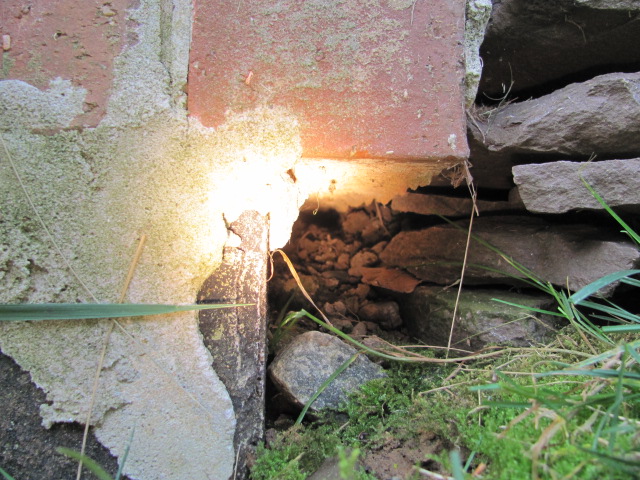

Full two story brick veneer front with only 1" of foundation support. Home is six years old, no evidence of wall movement. I guess the wall ties are holding the wall in place.
Picture #1 looked like there was an angle iron under the brick.I’ve seen angle iron attached to the foundation and the brick setting on that.
No angle iron present.

Needs 2/3rds support.
Corbelled, unreinforced masonry can overhang a foundation wall by up to 1/3 it’s bed depth with 2/3 bearing on the concrete wall.

Just to clarify your response, at least 2/3rds is unsupported (2 1/2"). Agent contacted the builder regarding a structural warranty, builder claims the warranty only covers the 1st year. I plan to follow up on this one, would like to know the proposed fix.
2-1/2"x5"x5/16" galvanized steel angle bolted to the wall with quick bolts.
