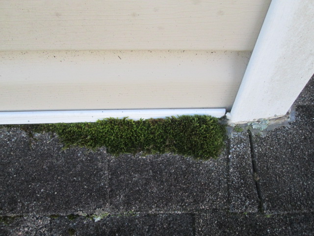

Does that roof on the front of that house have enough slope for asphalt shingles?
What flashing are you saying isn’t present?
Why is missing moss a bad thing?
Siding Contractor must have moved.
J-channel is right on top of the roof shingles.
The nails of the J- channel are about 1" above the shingles through the flashing. Good thing you don’t have snow.
Moss holds water, but lichen eat the asphalt.
Both are bad news for a roof shingle.
