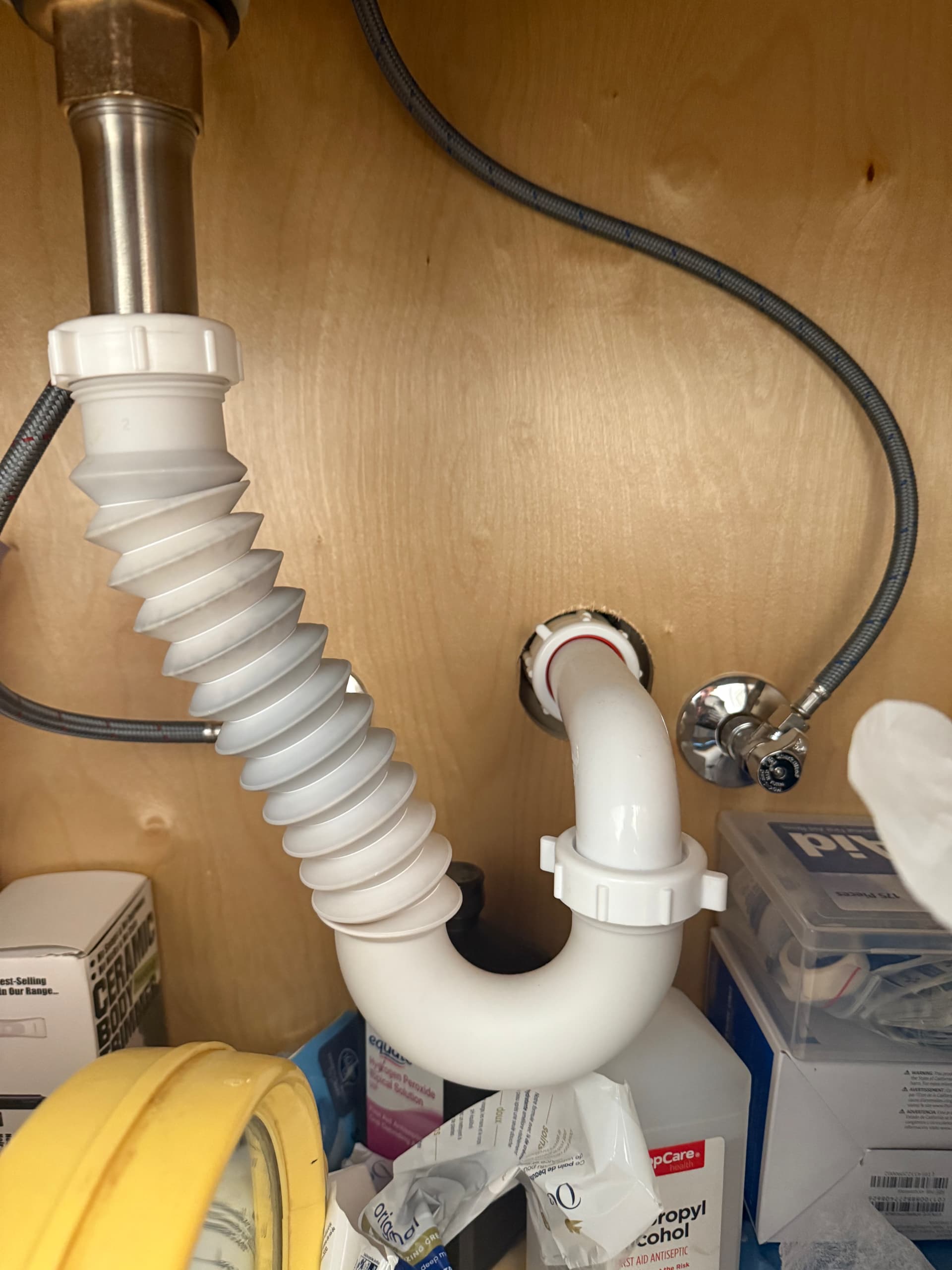

Hi everyone, I’m in the pre-certification process. I’m currently doing the mock inspection for the plumbing course and had a question regarding bathroom inspections. I was at a friends house and looked in the vanity cabinet to look at the P-trap and saw a flexible P-trap going. Is this is acceptable? Has anyone ever came across this before and how did you describe it in your report? I provided a picture of the P-trap I’m questioning. Thanks in advance for any helpful advice.
The pipe needs a smooth interior.
See that in bathrooms fairly often. As pointed out drain pipe should be smooth on the inside (code - to prevent clogging).
Be aware there is a similar product that is grey and you will see in kitchens occasionally. Although corrugated on the outside it is smooth inside and code compliant.

It’s not allowed by code, if that’s what you’re asking.
All the time. They sell them in retail stores.
Personally, I don’t make a big deal about it. Here is my standard narrative…
Ribbed, flexible drain pipe was used at the sink. This type of drain pipe accumulates debris more easily than smooth wall pipe and is more likely to clog. Recommend monitoring for slow draining and take corrective action as needed.
