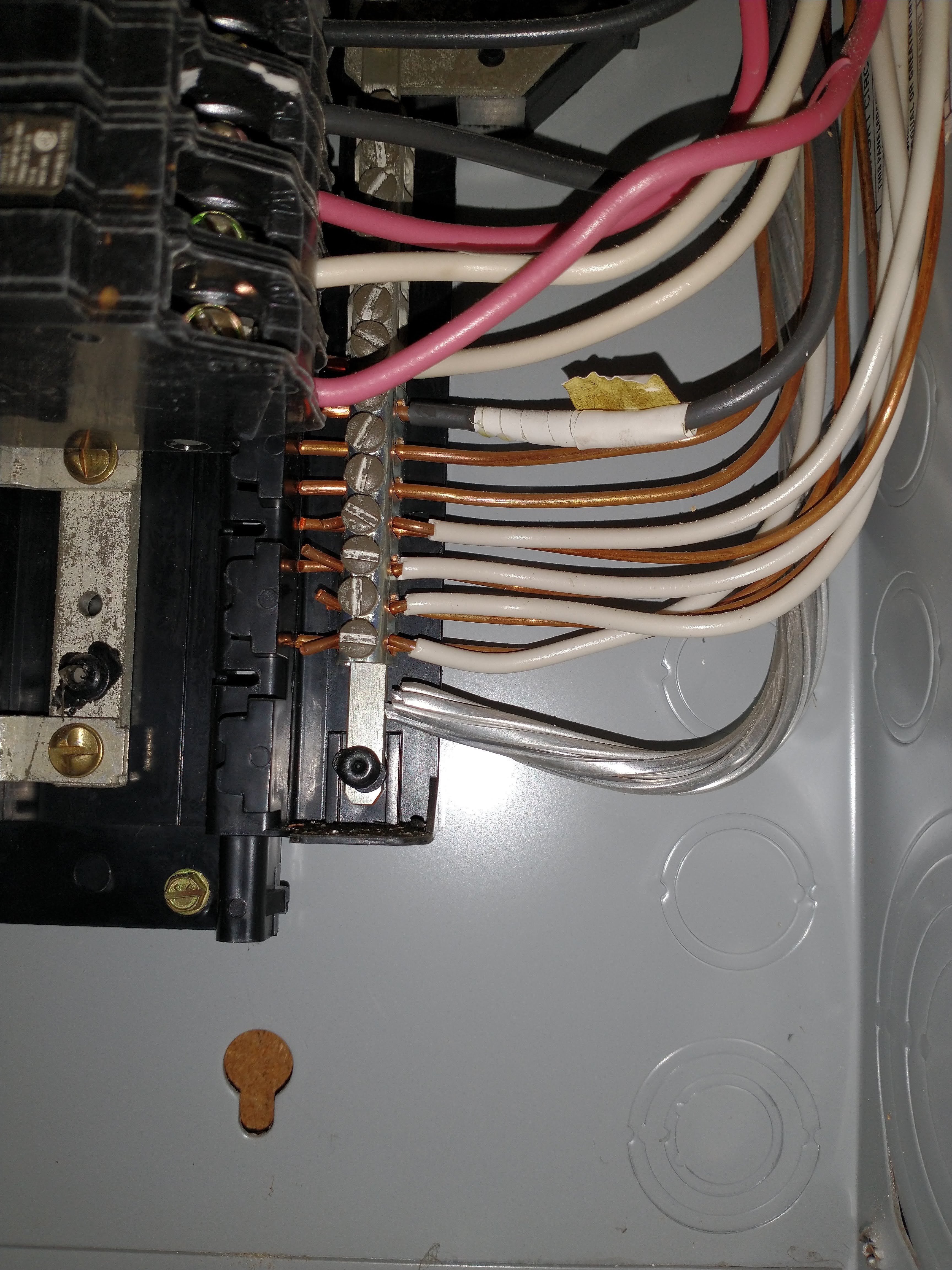

Multi strand aluminum ground wire
Narrative for this defect?This text will be blurred
What do you think as a narrative?

How about just saying the panel is not properly bonded to earth ground. Recommend a “licensed” electrician, none of that qualified stuff.
I see neutrals & grounds on same bus
Even though I cannot see the left side buss, there are multiple things incorrect about that installation. When you know there are multiple deficiencies but don’t know if you can describe them all accurately, I suggest defaulting your narrative to a general & all encompassing “Improper electrical panel installation. We/I recommend full evaluation & correction by a licensed or qualified (whichever you prefer) electrician”.
That way you did what you were hired for & didn’t provide incorrect information. Afterwards, dissect all the different deficiencies & learn them well for the next time.
From what I can see (some are assumptions since I can’t see the entire panel), I would write:
Observed multiple deficiencies concerning sub panel. Some of the more significant deficiencies include but are not limited to:
  • Grounded (neutral) conductors & grounding conductors improperly bonded within the panel. (Should be separated)
  • Did not observe panel to be bonded to the ground
  • Grounded conductors (neutrals) improperly double lugged at buss terminal
  • White color conductors (typically reserved for grounded/neutral) not properly marked to identify as being used as ungrounded or “hot” conductor
    I recommend a licensed & qualified electrician fully evaluate the panel & correct all deficiencies necessary in their expert opinion.
This way if you didn’t want to or forget to mention another deficiency, you are covered by say “included but not limited to” & by recommending “Full evaluation & correction”. You also put the onus on the electrician as an “expert” to identify all deficiencies as well as putting it on the client to follow through with your recommendation.
Improper conditions viewed, grounds and neutrals share the same bus, ground bus was not isolated from the neutral bus and appeared to not be bonded to the panel.
Among the other problems in the panel.
Remote-Sub-panel.
A: The neutral and ground must not be bonded in a subpanel.
The ground conductor is floating in the panel. No real bond observed.
Observation: Stray feeder ground conductor exposed in the sub panel.
Recommend: A licensed electrical contractor protect equipment from the stray ground cable.
There a multiple cables entering through a single connector which is not listed for the number of cables installed.
The feeder equipment grounding conductor (EGC) is not properly terminated on it’s own equipment grounding bus as required.
The bonding screw in the neutral bus needs to be removed.
Terminology is important try to avoid using the term “ground wire”. The bare conductor within the feeder cable is an EGC.

Since the bond screw is installed and grounds and neutrals are mixed on the same bus I would hazard a guess that the unterminated conductor is not even needed.

If I’m reading the tiny numbers right, that panel appears to be a GE TLM1212 which is rated for aluminum.
And in fact the two hots and a neutral appear to be aluminum stranded.

Aluminum for subpanel wires and feeders is 100% allowed, 100% normal, not a defect of any sort.
There are problems in this panel, but not the use of aluminum.
