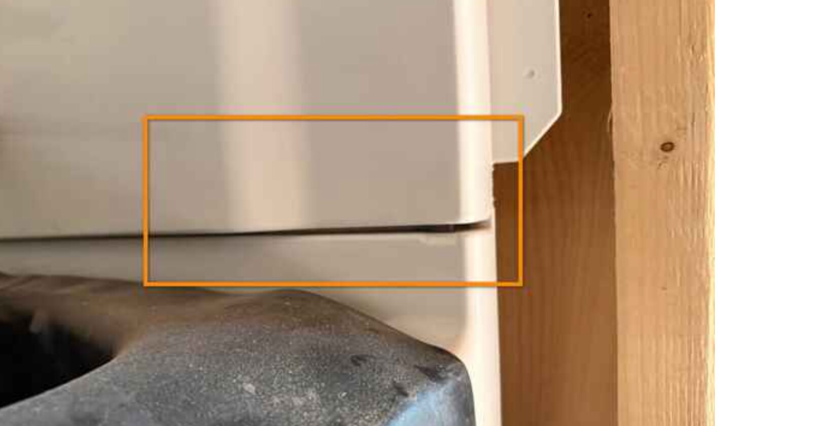

Sorry if this is a silly question. I am currently going though a new build as well as trying to become a certified inspector. I see People that fearmonger all sorts of stuff on the socials.
my builder pretty much ignored me on this issue and said this will not leak and is a non issue. The instructions say 1/32in gap between the insert and the tub and I would assume approximately 1/16. I can fit two credit cards but not a third. it’s only on the part that is outlined the rest of it is snug.
what are you thoughts on this? any advice?
The wall was probably slightly out of square. It’s not a problem.

Non-issue. There is a flange on the tub that comes up behind the panel that prevents water from getting behind. (you can see the flange in the photo)
Sometimes the installer will caulk the very end, but that is just to prevent water from running in the groove, and out at the side, but that is the only real concern

No worries. They typically are engineered to fit sung and be water tight. Hot and Cold potable domestic water supply pipes and handle protrusions should be sealed.
Try to find out the manufacturer and the style of tub. From there you can download the installation instructions. That should answer you question.
Daniel Horton mentioned a flange. The tub mold/form has a built in vertical flange that fits snug against the structure. The flange creates a crucial barrier, preventing water from seeping up behind the finishing tile and up and into the wall cavity. It is a capillary break.

As long as you remind yourself to use the standard shower head, it shouldn’t be a problem. If you change the shower head for one of those removable handheld sprayers, it’s going to leak if you point it at the joints whether intentionally or not. How do I know? because I had a call back regarding this. Your average homeowner thinks the shower is 100% waterproof because its a “shower” so they should be able to spray where they want…yea…had to explain to them how the multipiece showers work.
Also, the outside end corners of the horizontal joints should be caulked. Even with a regular shower head, water can easily get into the vertical joint on the opposite side wall. The water runs down the vertical joint, hits the horizontal area at the top of the tub. Due to the water tension or w/e the water doesn’t like to drain out of the small gap left between panels at the horizontal joint and ends up getting pushed out of the end joints and causing damage to the nearby drywall.
Now, that doesn’t mean you can just have as large of a gap at the joints as you want because the larger the gap the less overlap, which is less water protection. I’d still call it out if the gap is 1/8 inch or larger. Remind the builder to fix it at pre-drywall so he doen’t have to tear the drywall out to adjust the panels or rely on caulking because of poor installation.
