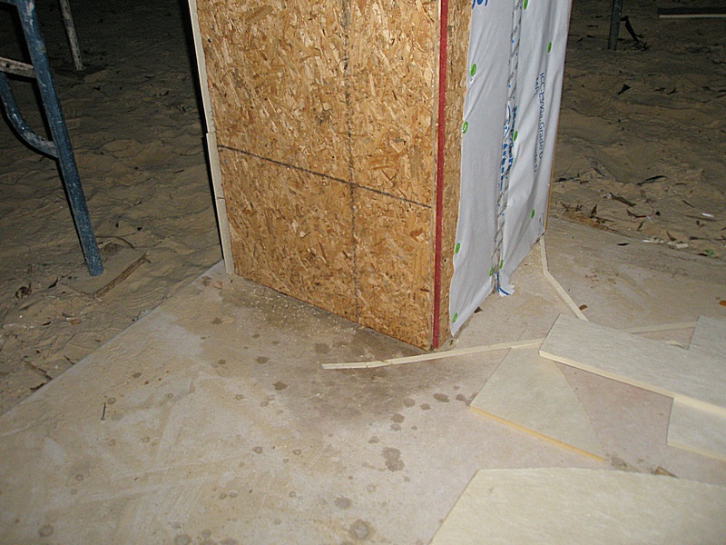

No weeps , no moisture barrier,soffit lights,hard roof intersection on the right side.
I hope they used green board on the interior walls .:slight_smile:
No way to seal up the outside corners where the brick and stucco meet except for backer rod and sealant, Like that is going to happen.
The roofers did not run the flashing up the wall high enough for the 2" clearance needed for the stucco and properly lapping of the moisture barriers. To name a couple other defects.
from a draw last week, they are getting ready to do the stucco. I asked the builder if they were going to trim back the osb from the concrete. He said to just process the draw and move on. :smiley:

Do we really need moisture barrier?
http://i280.photobucket.com/albums/kk164/cab1961/nomoisturebarrier.jpg
What happens when the stucco man gets there before the concrete guys?
http://i280.photobucket.com/albums/kk164/cab1961/column.jpg

You guys always build on grade?
Foundation should finish a minimum 8 inches above grade on all sides…
Suspect: water infiltration
Cause .Foundation elevation and Veneer elevation from grading is to low. xx inches. Looks like zero.
Lack of weeping ability for the veneer.
Suspect: No or improper flashing.
Recommendation. To trench the area sounding the foundation a minimum of 6 to 8 inches.
Sloped residential building peremptory too 2 low ends for water collection.
Install a dry-well at both termination points of the trenching for water collect and slow dispersal into the loam…
Possible Suggested repair.
Examples:#1 Void to be filled with a geo-fabric then clean aggregate. ( owners desired circumference and color. 1/4, 1/2 inch ) pea stone
2# or a layering; geo-fabric on the bottom of the void as the first example explains. Standard aggregate 1/4 1/2. 6 inches high, geo-fabric on top and and ceder mulch above the grading by 1" inch. Settlement will occur. Maintenance needed for ceder mulch.
Recommend a licensed mason redo the bedding CMU ir cement stone joint at the foundation sill plate.
Repair: Cut a curf 1-1.5" deep and apply a 5/8" or thickness desired backer-rod and apply polyurethane caulk.
Install anti bug weep vents every 8 feet.
See if you can find the architectural prints and what the call was for on the veneer Mr. Funderburk.
Re-inspect the home after 6 weeks for moisture intrusion. As long as the sill plate and any moist wood has had time to dry.

Its the distance from the grade that is the key in the veneer’s placement, or the deficiency. Same as last picture I commented on a couple of months ago Joe. The veneer is to close to grade.
If weep-holes where installed and the foundation and veneer are at or near grade level, more water would enter the void in the weep holes. Only weeps to counter a bit of this are bug stoppers.
