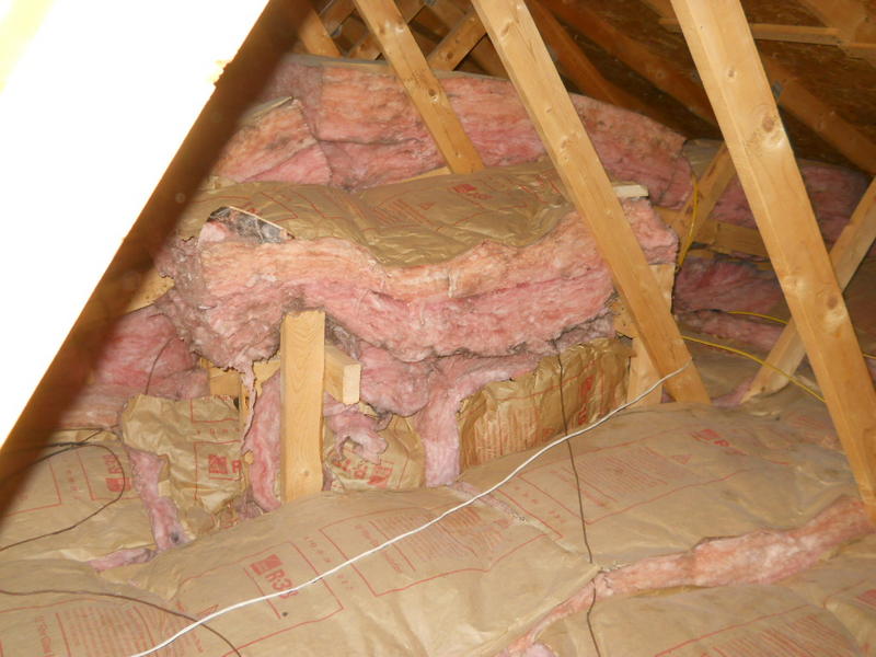

Comments? 2005 build. Maybe I am to picky.

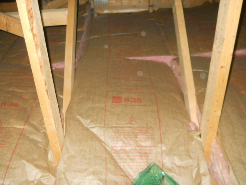

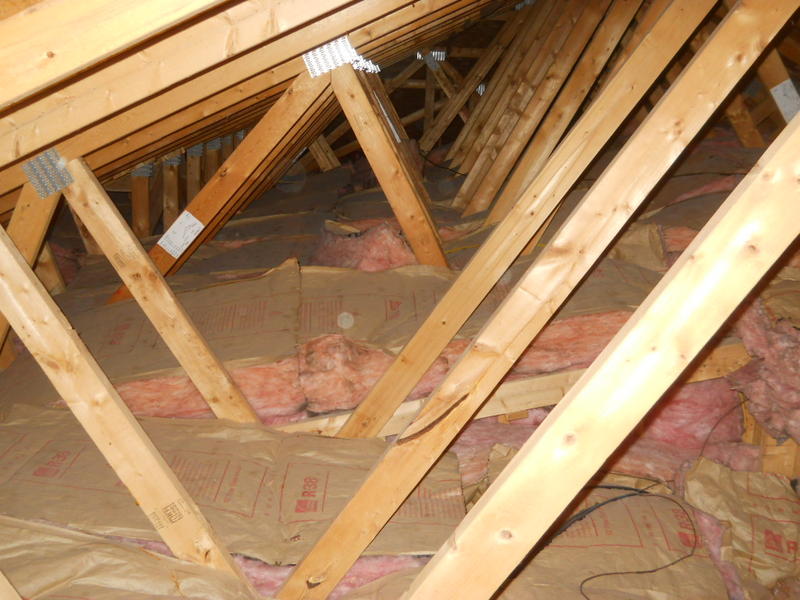

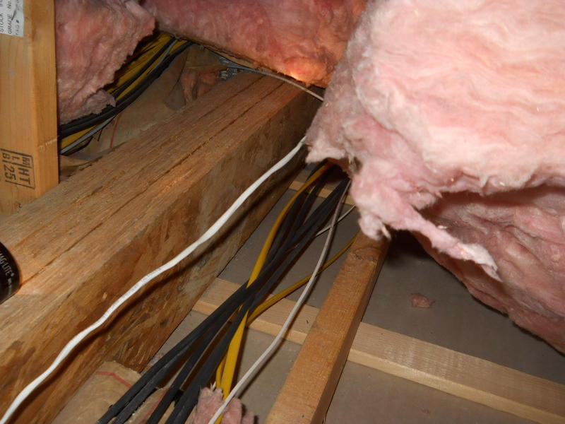

The insulation runs over pipes and beams. The manufacturers instructions call for all batt roll insulation to be placed paper side down on the ceiling board. In this present condition this is considered a fire hazard.
The insulation was installed with the paper side up. The paper side of the insulation should be flat against the ceiling board. When the insulation is paper side up, it is considered to be a fire hazard.

No, you are not too picky! Lazy a-s-s contractor!
brown down !
Looks like crap to me. Look at all that air flow going through that insulation too.
Nope your not to picky.

In the case of the photos, it does not matter because the paper does not even act as a vapor retarder due to the haphazard installation, but the key point here is that it was not installed per manufactures recommendation for optimum performance and it needs repair to maintain the insulation factor require for the attic envelope.
I actually recommended to install a blown cellulose insulation to fill all the voids creating the heat loss.
It truly amazes me how little it takes to eliminate nearly all insulation performance when improperly installed.
