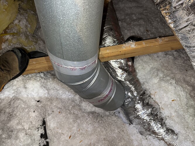

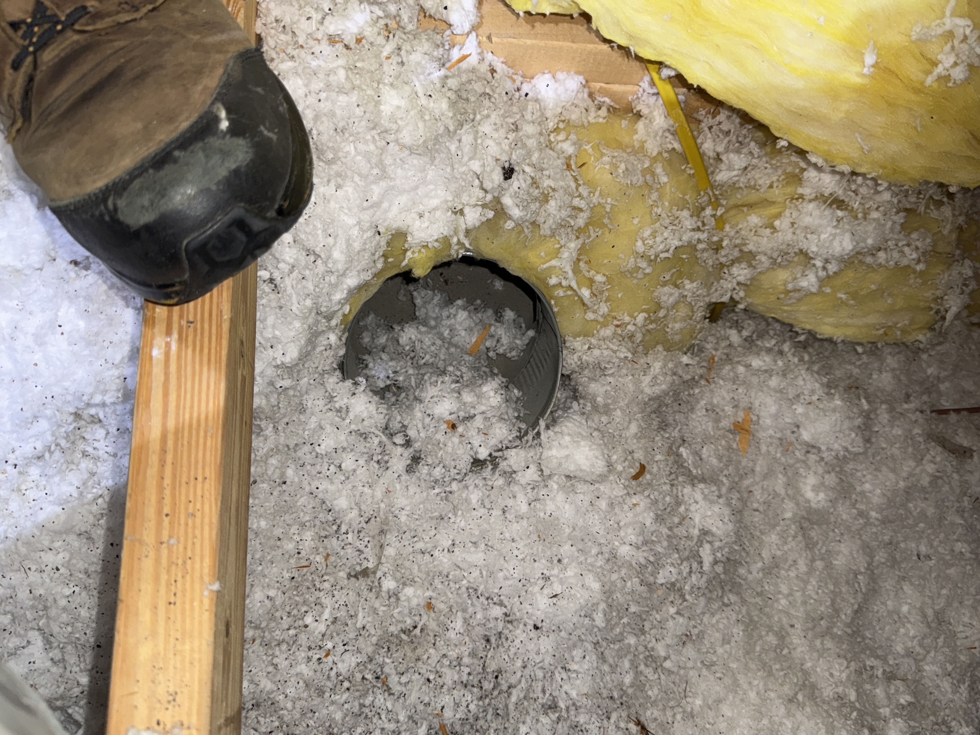

You are lucky that they even were able to get the vent through the hole! I can’t tell you how many times I’ve inspected new roofs and found out that they went right over the hole for the vent line. Including my own roof!
It’s not on a new build; it’s on a new roof. The roofer removes the old roof vent that has the pipe and replaces it with one that does not. Architectural shingles get replaced every 13-15 years here. Insurance companies flat out won’t insure you or will raise your rates so high that it’s more cost-effective to replace the roof. But you saying that makes me think that there is a misunderstanding by the roofer of how the vent should be connected if HVAC guys usually do the dryer vent :face_with_monocle:

At least the disconnected one you found was insulated. Most that I see in attics aren’t.

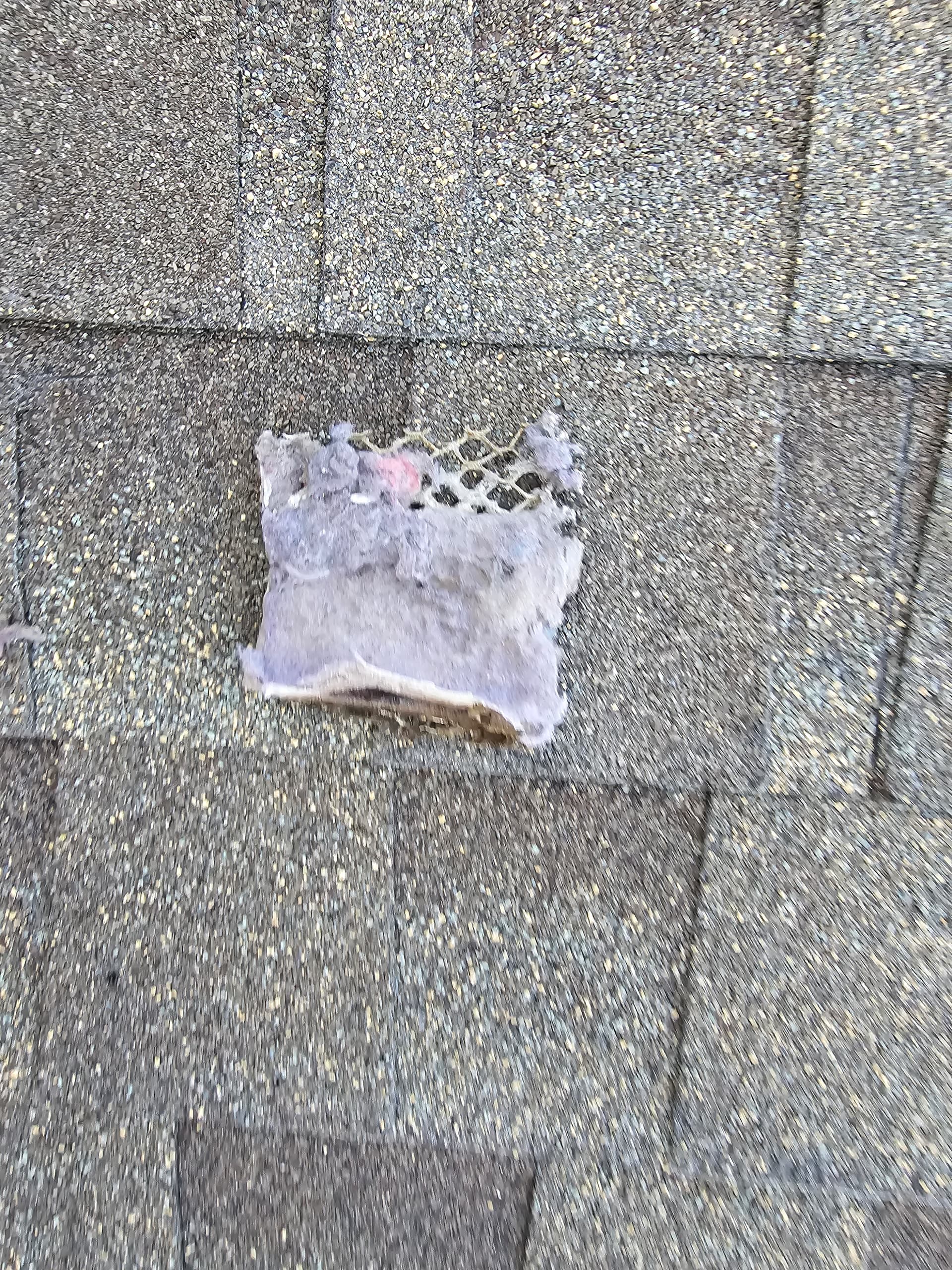

Dryer vent clogged on 7/12 slope two-story roof. There it’s no way to expect home owners to do maintenance like this.

I see problems all the time as well with dryer vents that are terminated on the roof.
This note is in the laudry section of every home inspection I do.
FIRE HAZARD NOTE: According to the U.S. Consumer Product Safety Commission (USCPC) 15,000 fires occur each year as a result of improperly installed or improperly maintained dryer vents. It is recommended to inspect &
clean the dryer vent every 6 to 12 months, depending on use, to ensure safe & efficient operation of the dryer.
Whenever I inspect a condo I add this to my reports.
It is recommended to make inquiry with the current owner and
condo association to verify that there is a dryer vent duct cleaning
service contract in place, or if that is the condo owner’s responsibility.

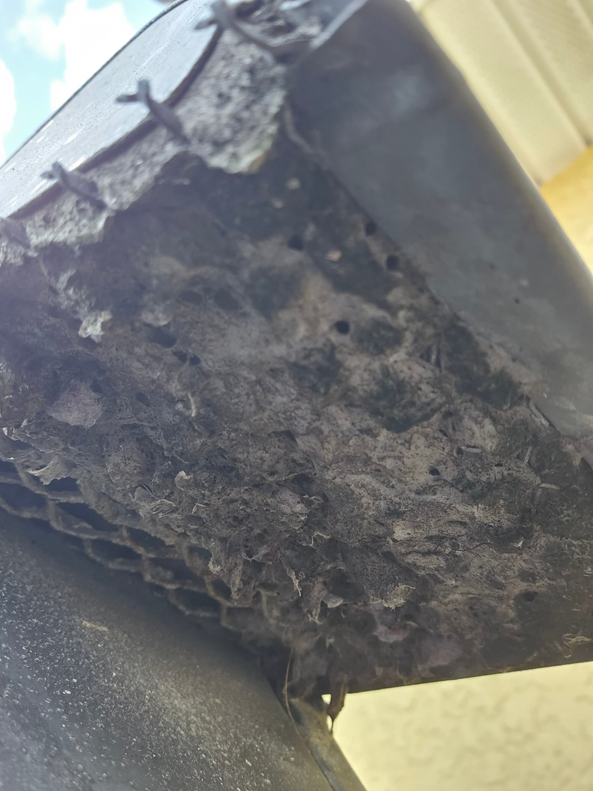

Do you guys think this roof vent might be an issue?
Looks like a case of the norovirus for the dryer vent :face_vomiting:
Just a self cleaning unit, Adam.
:rofl:

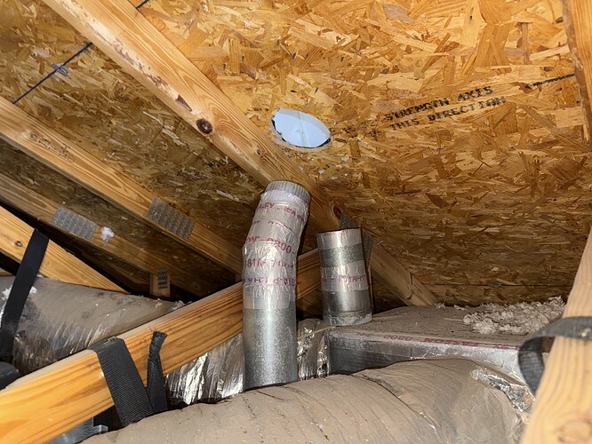

Had to post here again. DEC 2024 roof I inspected today. Pictured is a disconnected dryer vent and microwave vent. I’m hoping this picture gives more context of what I mean by the roofing company installing an improper roof dryer vent. There is no pipe from the vent for the dryer vent to connect to in the attic.
These are great catches. Ventilation is often overlooked, especially if it is missing. I do not think the roofers should be making this connection. Cross trade errors are very common such as HVAC contractors doing their own electrical work. This is acceptable but they screw it up more often than not.
For me, this is a simple write up in my report and then move along. Most of us have stopped being surprised, lol.
