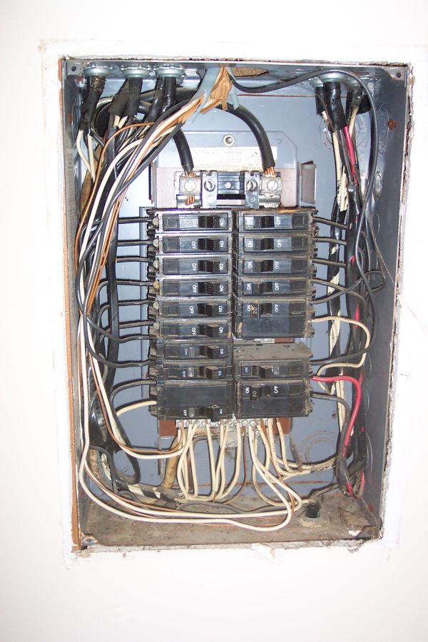

Originally Posted By: psmothers
Found this on my morning inspection today. The system was mostly ungrounded. The meter was a round 60 amp meter. The panel was a square D 125 amp panel. There was no main disconnect… Can anyone try to explain why?
Sorry Jeff I should have better stated my question. What I was looking for an explanation to was why an electrican would have installed the panel without a main disconnect. The only answear that I could come up with is that the home is outside city limits and never had to have permits. When did more then 6 breaker needs a main disconnect rule come in to play?

Originally Posted By: bking
I think the six breaker rule has been around for quite some time and somewhere I read that you should be able to turn off all power with “two swipes of the hand”
I would write that panel up for missing a main C/B, missing bushing at top and hot white wires.
Hey Kev,
Non outside either.

Originally Posted By: Steve Costa
I know this isnt what you were looking for, but that is actually a square meter base normally rated at 100 amps.
Originally Posted By: wdecker
I have run into a large number of no main disconnect boxes, usually in condos and townhouses.
I call them out as unsafe if there are more than 6 breakers (six throws).
I usually get sellers who bring in electricians who say that it meets code (which is, surprisingly, true in some municipalities around here).
When confronted by the seller or their agent, I ask if he is willing to put in writing (risking his license and E & O) that it safe. That shuts them up real quick.

Originally Posted By: Kyle Kubs
I see a lot of posts in this section talking about meters being rated at this or that, and I think there is some confusion going on… In considering what the service rating is, the factors governing would be the gauge of the service entrance cable, the rating of the service or main panel, along with the main disconnect and the rating of the meter BASE… The meter base being the glorified junction box that holds the meter and houses the connections to the meter (glass bubble thingy…) After the crimp connections at the weather head (the handoff from the power companies service drop to the homeowners service entrance cable) the power company is only responsible for the meter itself, not the meter base to which the meter is mounted. In almost all areas the power company has sole discretion on what size, type meter is appropriate - The “meter base” (grey metal box) on the other hand is part of the structure and must be of the proper rating… and as Steve said this one is apparently a 100 - 125 amp meter base and is fine… You have what looks like a 100 or 125 amp service there… If the meter base was the little round type just barely bigger than the meter itself… that is an issue… That’s an old 60 amp. meter base. The power company alone (in most areas) determines what is sufficient for their equipment. I have installed several service upgrades from and old low service to a new 200 amp. without the service drop (line s from the pole) being changed… If they say it is ok for a 200 amp. service than it is good. Doesn’t matter if they are the same lines that were there for a 100 amp. service before…
Hope this clears things up a little for those of you not so familiar with the juice supply…
By the way I didn't hear you say anything about the gapping hole in the top of the panel that has wires coming through minus the benafit of the proper connectors...
