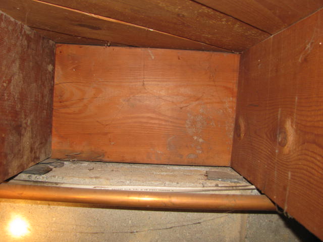

Home built in 1961, no sill plates, except at the garage foundation. Any thoughts as to why sill plates were not placed and the consequences?
I’ve seen it a few times and noted it but I’m sure nothing was done but we don’t have the earth movement that some areas have.
I have no idea why someone would omit the sill plate. It seems like more work to leave it out and have to shim each joist.
One runs into this kind of construction every so often. How is the framing anchored to the foundation? Some don’t even have anchors, and just depend on the weight of the house to keep in on the foundation. Not much one can do about it now; it’s built.
Not there because it was probably not required… I have seen many homes w/o sill plates…unless there is a moisture issue then there is nothing to worry about.
I suspect the shims were after the fact…
Needs anchoring, needs separation from contact with cement. But those are just code requirements.
Hi John,
Could you see any type of Fasteners installed anywhere?
Other than being a framing nightmare and fastening concern as well, really not a big issue being that old.
No obvious anchors. I realize there is no reasonable repair, and after all of this time the house is not moving. This construction method is one that I do not recall observing on past inspections. I thought the local inspectors would have noted the missing sill plates when the construction plans were submitted or during the permit inspections. Why would a builder attempt to level each joist with slate shims instead of placing the sill plates? This is why I like my job, you never know what will be discovered!

I find a large number of homes from the 60’s with the subfloor directly on the foundation. No sill plate. Large beams supporting 2x6 T&G and the ends of the 2x6 rest directly on the foundation. Some have tar paper separate, some don’t. Actually nice to inspect since there aren’t any joists to scrape your back on.

I have seen many basements that were built in the 1960’s, and never seen any with no box sill plate.
Renovated many buildings with my Father as a kid and never saw no box sill plate.
I have no idea what would prompt someone to not install it, considering all the extra labor that it creates building the darn thing.

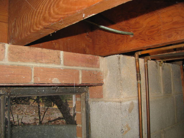

That third picture really bothers me though for the fact that the masonry and brick too good to be 48 years old. The testure and smoothness of the CMU face back 40 years ago when I worked in a block manufacturing plant, did not look that good.

Marcel,
You noted concern regarding the condition of masonry components shown in photo #3. I now have to think that the lintel should have been a single concrete pre-formed lintel instead of the steel with brick as shown. i have attached an image of the rear wall (1st image), the basement window is the same as shown in photo #3 of original post. Take a look at the slope of the concrete footing and also note the appearance of “newer” brick at the lower wall section, especially evident on the left side of the entrance. I will admit that i did not see the difference in the brick during the inspection, no excuse, but it there was a heavy rain during most of the inspection. Sometimes a photo will reveal things that may not be obvious during the initial inspection. All windows were original single pane, except most of the basement windows which were recently replaced. Mostly finished basement appeared to be completed long ago. Any thoughts on the possible added brick? Added one image of the side wall for reference. Thank you and Happy Thanksgiving to All!
Good morning John and Happy Thanksgiving to you.
Looking at your picture shows a substantial window size and on the first pictures it shows 2 bricks wide on steel lintels.
This set up would be two angle irons back to back and should have been at least 5"x3-1/2"x 5/16". It is also picking up the load of the first floor above and are not rated for that.
Masonry veneer shall not support any vertical load other than the dead load of the veneer above.
There appears to be a caulked joint in the brick above the window also.
The back door might have been added at a latter date, but I don’t see much difference in the brick facing.
There might be other things to see from other pictures, but just cover yourself best you can. :)
