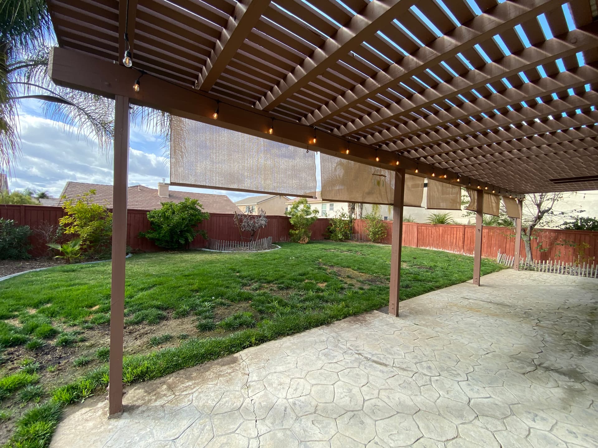

No visible joist hangers
Although I did see lag bolts on the ledger board, I saw no visible joist hangers. Would this be something to call out here? Thanks, guys
The rafters are supported on a 2x2 ledger. If it were a deck IRC no longer allows deck joists to be supported on a nailed ledger due water trapped behind the ledger rusting the nails. As a pergola I wouldn’t comment on anything other than general condition.
