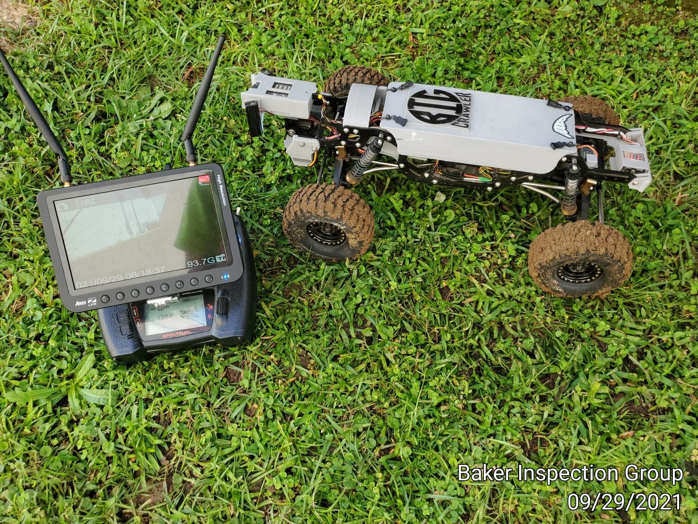

My own, the BIGCrawler. You build it to minimize those issues. Mine is very difficult to do both to. Depends on the height of the wall.

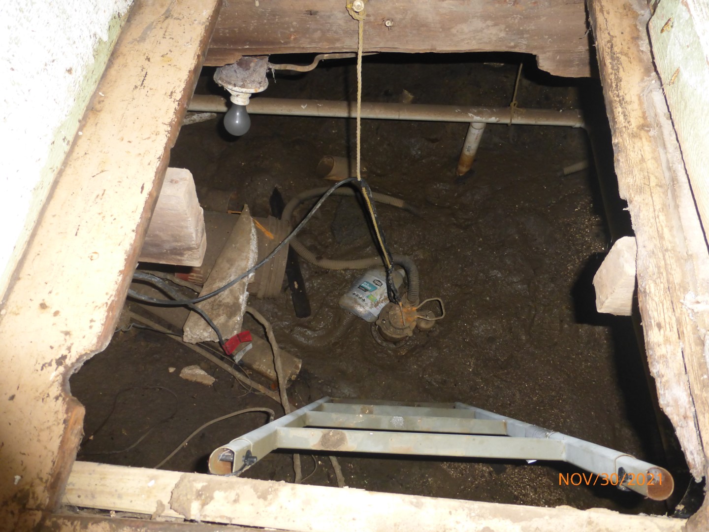

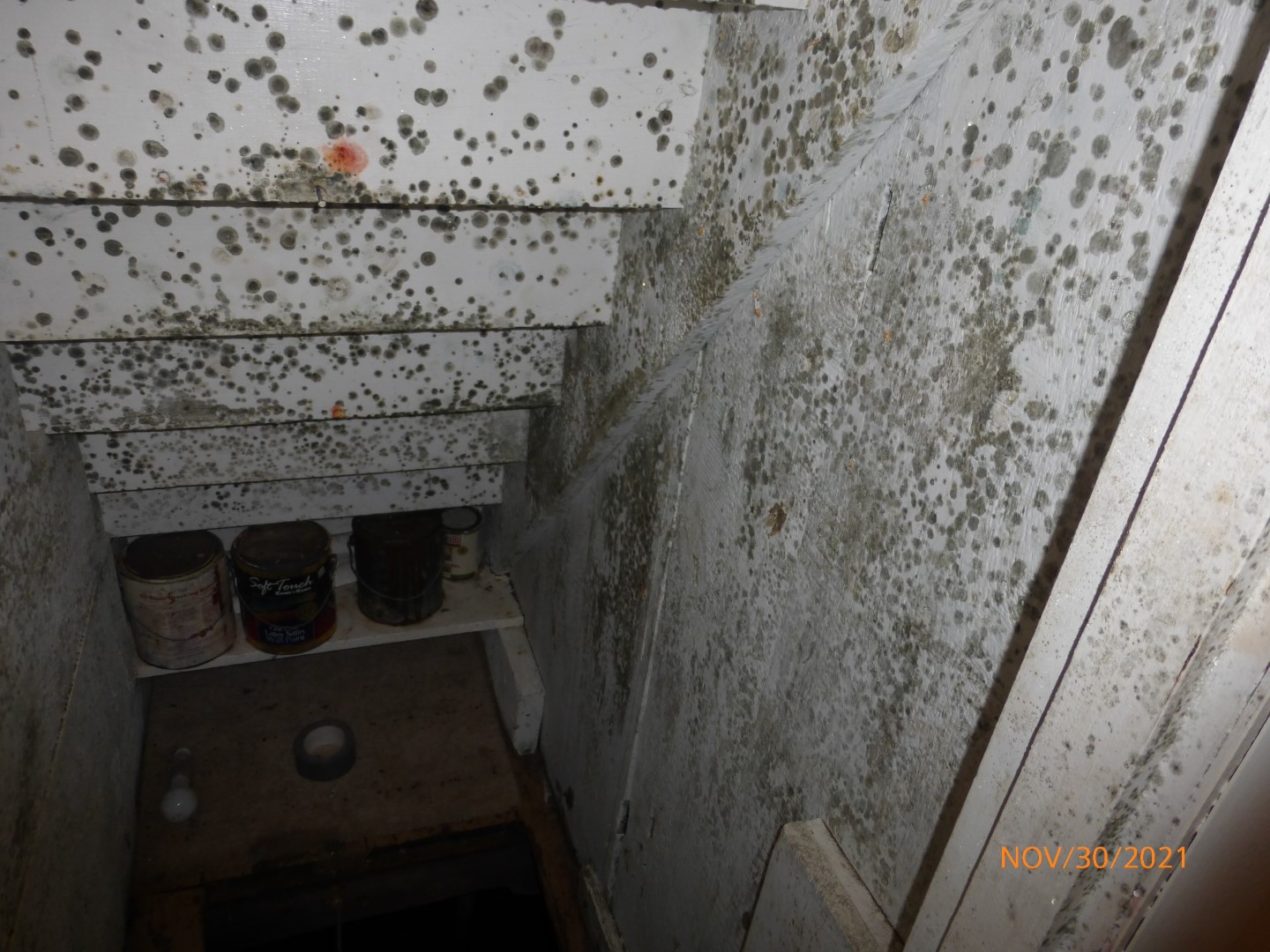

Yesterday’s “Red Flag”… (1900’s home, cs access interior closet, vacant for min 9 months)…
This was just the tip of the iceberg. I refused to let clients in the home for walkthrough without masks on (N95) and then only for short time.
Yes, they cancelled their purchase 10 minutes into the walkthrough!
Appears a bit muddy down there, lol. Love the sump pump that looks to have been hanging from the rope at one point.
Needless to say, I DID NOT attempt to access.
Would have been a fun one to do some “mudding” with a crawlbot.

It looks like someone would need septic pumper for that crawlspace… :face_vomiting:

These are situations where a camera rover may be the better choice. Just be sure to toss it in a bag when you retrieve it so that the interior of the storage case isn’t contaminated by the filthy tires and chassis. You’ll need to clean it thoroughly when you return to home base.
I met with a local shop that sells and repairs remote control vehicles… toys and really cool camera drones, etc.
Guy is going to build me a custom robot with camera for crawlspaces… Couple hundred bucks. Much cheaper if you look around locally. There was one online I saw for several thousand dollars
