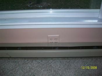

I recommend plugging your space heater in here…receptacle by Vince S.
hey, are those “half hots” on the bottom?
