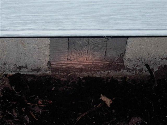

3.Wood beam exposed to the outside.

I have seen beams pocketed in this manner and exposed. If there is no significant deterioration then it should be capped so as to prevent weathering.

I’ve never seen laminated (or any other type) beams pocketed/saddled in the foundation like this one. How old is the structure? Wonder how this got past the local BID framing or final inspections. I know you have Termites and other WDO concerns in OH., maybe not as bad as here in Ga., but how was this missed, and evidence of previous or active infestations.

It appears that the building design was changed mid-stream and created these scenarios. The stairs were move from the original design intent and the framing configuration was dealt with the same way.
Extending the floor girder to the outside elements is a bad idea and an after thought that did not show any respect to the actual consequences.

Raymond and Greg, this home is 13 years old and the old sump pit is filled solid with concrete, and the end of the beam thats outside of the block was buried with mulch.I also recommended to the buyer to keep it clear of the mulch and apply a coat of paint.

I try to stay away with recommendations like that .
This could be just a bit above my knowledge and the legality .
I think I might have passed this on to _( Recommend immediate repair by qualified person ) .
You could be correct but what about if there is some
( Inside where it might not get a chance to have dried out ). decay in where you can not see or test.
Transfer the liability I think.
I try not to squirm away but in this case I would .

Yes after my post I too thought the layout had been changed. As to the beam it certainly is load bearing, eh? The full 8"! :slight_smile: :slight_smile: :slight_smile:
