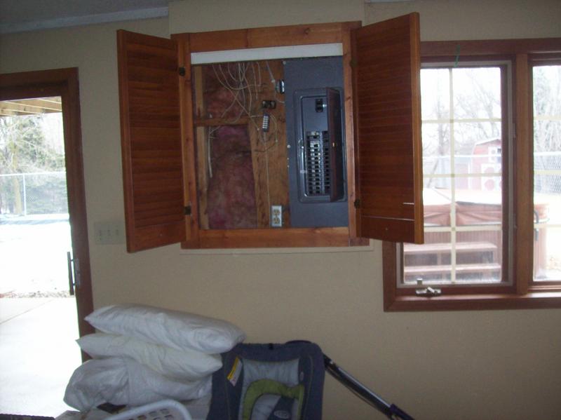

I always open “dead front” regardless whether the panel is new or old. How otherwise can I see the condition of the wiring? And missing something like this will not be good at all.
Agree I would never have seen this without opening the cover, I wear gloves…check for heat and listen for noise coming from within. If i see moisture and rust in the cover I use care and caution…if I proceed!
Art.38 The inspector shall open main service boxes & distribution panels when it is safe to do so. If he cannotopen these, he shall indicate the reasons in his inspection report.
How ironic…this was today. The cabinets were blocking the cover. I tried…but just couldn’t get it open without doing some damage to the cabinets or panel front.
Had the same issue the last 2 inspections. Documented and disclaimed. The client understood. But if it’s accessible, I open and inspect with proper protection.
So then you checked it. If that can not be done i will return when it can be done with A extra charge to the seller, or Write it up to be checked by a electrician Btw i have removed trim with seller permission . And no i do not put it back on .

I open them all if possible, one time i left it open (off) as there was loads of water dripping inside and running down the interior of the box…i’d have not touched it if i knew the inside would be like that.
I left a notice and informed the listing REA, as to why re installing it was unsafe.

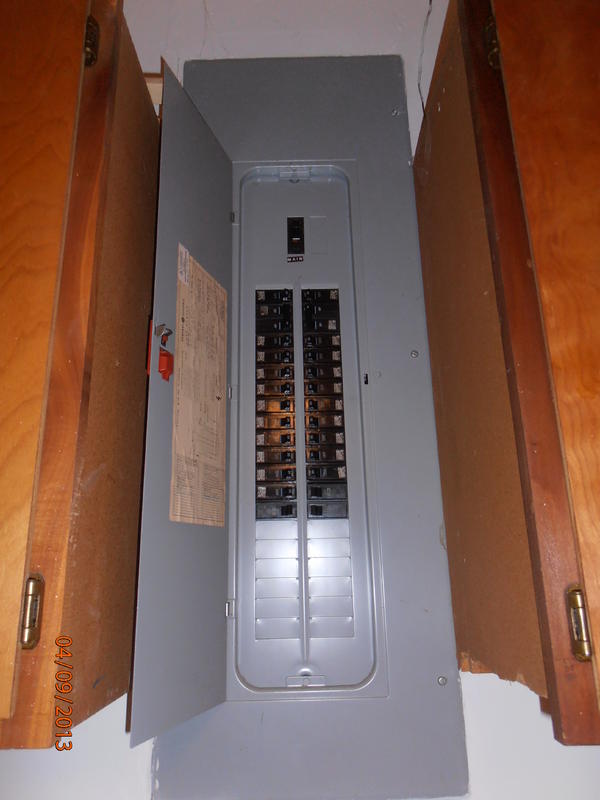

The interesting thing to note is that Federal Pacific panels should not be confused with Federal Pioneer panels.
The latter were manufactured in Canada and have never shown the problems seen by the same FPE panels in the U.S.
That said, as with all things here in the North, if someone thinks they can save a few bucks by going over the border and buy cheaper equipment there, there is always going to be a case that it happens, so all inspectors (especially those nearer the U.S./Canada Border should watch out for it.
The other thing to note is the FPE (Federal Pacific Equipment) Stab-lok breakers fit in Federal Pioneer Stab-lok AND Schneider Stab-lok panels. The breakers are also a subject of the major recall in the U.S. so try to ensure the breakers are also Canadian Manufactured, (More difficult as the label is sometimes on the side.)
In Canada, there were two Federal Pioneer 15-amp single-pole models NC015 and NC015CP made between August 1, 1996 and June 11, 1997 that have been recalled. You can see the Schneider electric recall notice here
