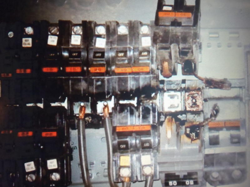

Sorry Roy are you afraid to register it does not cost anything.
I did not expect any to need to see the picture here as the write up says it all.
However I was also not aware that Len put in the safety feature.
Amazing.
What is amazing Kevin, is that you posted a picture which we can’t see without registering to some association?
Here you go Marcel!
That is better, Thanks!

This is about a delicate as it gets Claude. We all have the skills and training however things are changing and part of that change is affecting even the Electrician who has the power to open panels without removing power. From my understanding we are not service technicians so in light of this should follow all our training to remove the dead front as specified in our SOP with proper safety equipment.
If the power must be removed from the panel than we as Home Inspectors will need to add this as a must situation and power outage of the Home. My understanding is that we should not do this as part of SOP however again this may be required to make the call in the future.
As for the **Panel Dead Front **YES it needs to be reported that you are not able to inspect the Panel if in the process of the Electrical Inspection you run into a problem such as John is pointing out.
A picture of the condition is also desired along with the narrative.
Yes John leaning over the freezer would be one of those.
