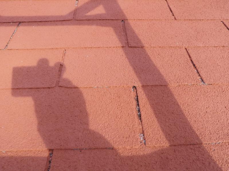

14 year old roof has been painted. Not in bad condition otherwise and have very good adhesion. Never seen this before does anyone think the shingles will deteriorate faster and make the attic hotter?

Here’s some info I found recently when I inspected a house with painted asphalt shingles.
“Asphalt shingle roof systems are vapor permeable because joints between individual shingles allow vapor to pass through. Some coating formulations are effective vapor retarders. Applying a vapor-retardant coating to an asphalt shingle roof system’s surface likely will compromise a roof assembly’s self-drying characteristics.”
“No evidence currently is available to correlate marketing claims with actual performance of field-applied coatings over asphalt shingle roof systems, and such an application subjects a roof system and its owner to specific risks the owner should understand before making a decision to field coat an asphalt shingle roof system. A thorough cost-benefit analysis may prove that known concerns within the roofing industry outweigh the potential benefits.”
“It may be “difficult or impractical” to objectively evaluate the physical properties and performance characteristics marketed for applications to asphalt shingles”
“depending on the coating type, field application over asphalt shingles may lower an asphalt shingle roof system’s vapor permeability”
Thanks Chris. It does not seem like a logical thing to do.
That’s how I feel. Looks like our guys used the same paint. :slight_smile:
look at that…I guess great minds think alike :mrgreen:
So if the joints are not sealed, like in Chris’ photos, then what is the problem? Both the roofs posted look a bit more like a “painting” than a “coating”.
