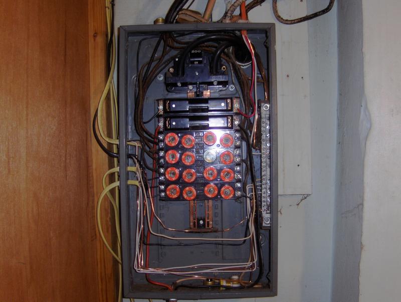

Here’s an FP fuse panel from yesterday.

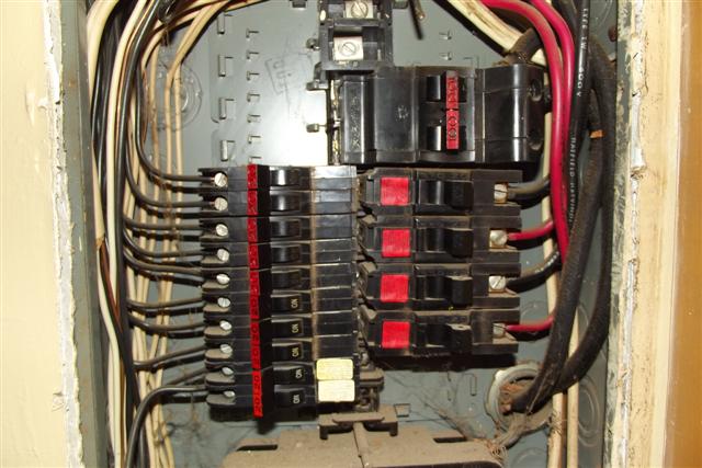

Here is one from this morning’s inspection prolly the most gruesome to remove of all the FP dead front’s it has the 100 amp main sitting to one side in alignment with the right side. Very difficult to remove with out tripping the main
The ones that have the main on top are even worse. Usually, I end up knocking out one of the side breakers to avoid shutting off the power to the home.
Ya mean like this one from yesterday and the day before and the day before and the day before that its a cake walk:D:D
I love the smell of a grounded conductor cooking in the morning–:smiley:
