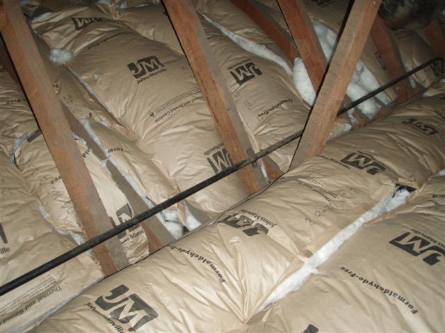

Isn’t the paper backing supposed to be removed when the batts are placed on the roof sheathing for fire safety?
Now that would protect it from fire, but defeat it’s purpose as a vapor barrier. We had inspectors tell us to either remove the paper where exposed, or flip it.

If the vapor barrier is left on it is supposed to face the conditioned space Thomas, ie the attic in this case.
There is not much vapor here so I rarely see any vapor barriers in attics.
Is it a fire hazard as installed and was I correct to call it out?
If you can read the warning, I guess it’s in effect.
tom
Non habitatable attics, crawlspaces and the like are exempt of having to cover the paper around here.
Non Habitable, thanks Larry. I think I will re word my narrative for the next report. I also think I will continue to call it out as it is written in red on the batts.

Does it say that on the paper?
Manufacturers instructions.
Steve
Don’t leave the paper exposed.
I have an answer.
http://www.naima.org/pages/resources/library/pdf/BI472.PDF
I would like to endorse this link and reiforce Brian’s statements and links on this post.

I see this vapor retarder exposed on most of my inspections.
It’s simple…Flip it all so that the vapor retarder is against the warm side of the buildinfg or seal it with drywall. It’s combustible and it should not be left exposed.
Thanks David and Marcel, had a homeowner (FSBO) not too happy with my call. The Fireman husband did not seem to understand what the writing on the batts meant. Specifically not to leave the paper exposed. They sell fire retardant batts.

Interesting Jeff how both your pictures and my picture captured the warning not to leave the paper backing exposed.
I do that on purpose, and insert that picture into the report. This eliminates the phone call from the seller asking “what does it matter which side is up?”
