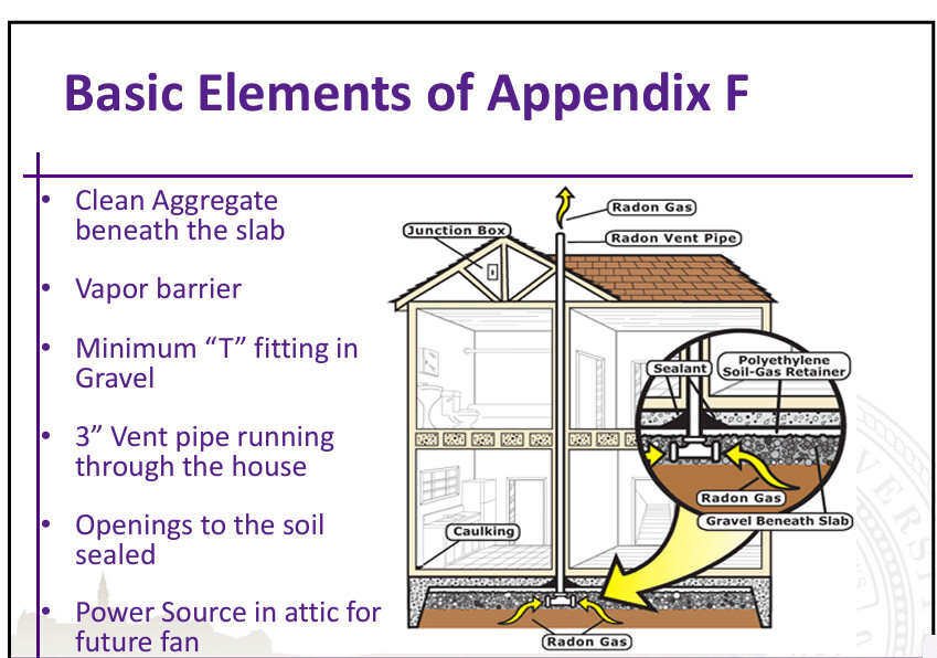

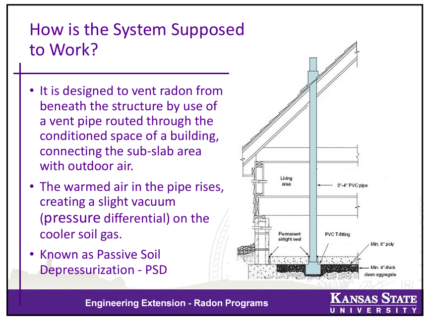

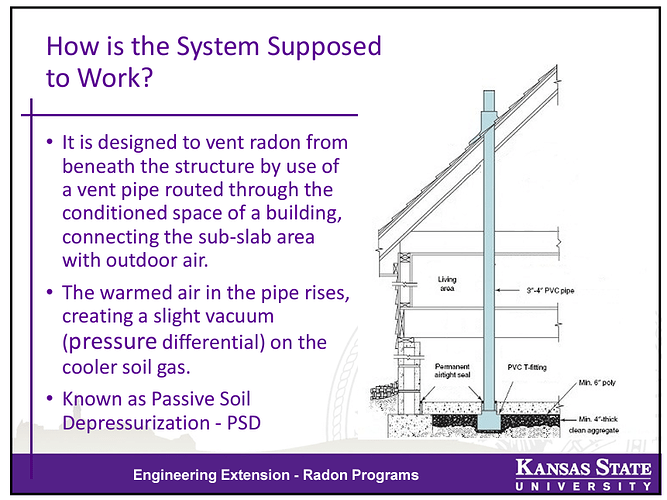

The pipe will terminate in gravel, but the gravel should be below the slab, typically a T-fitting or similar. Here is a quick image from the internet. But these systems are strictly outside a standard home inspection. Did you add inspecting the passive system? Perhaps in your radon testing agreement?

Based on Brian’s second graphic, it appears that no T fitting was added in the gravel end. Looks like your pipe just terminated below slab at the gravel. Less effective? Idk… :man_shrugging:
Mitigation systems don’t have a collection “chamber” per say. That’s what the gravel is for. Soil gases and air still travel through it. I have seen hundreds of systems installed without a T fitting or anything else. Usually it’s just a pipe shoved into gravel, and sometimes dirt.
