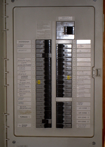

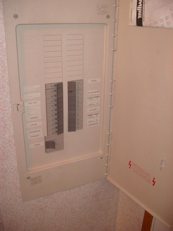

OK - here are some photos of the Trilliant product installed in my basement (1 of 2-200 main panels).
  1. Panel with cover open
  2. Closeup of panel
  3. Panel interior.
  4. Closeup of romex clamping arrangement
I’ll be glad to answer any questions.

Hi Frank,
thanks for taking the time do take those, those are the first images I have ever seen of those panels in use.
Regards
Gerry
The cable clamping method was one of the more innovative things about the Trilliant panel. This same cable clamping method was used in some QO and HOM panels manufactured in the early 90’s also, but quickly abandoned, for some reason. I might guess that when the Trilliant line went by the wayside, there was no reason for that cable clamping tooling to remain in service in an economical way.
