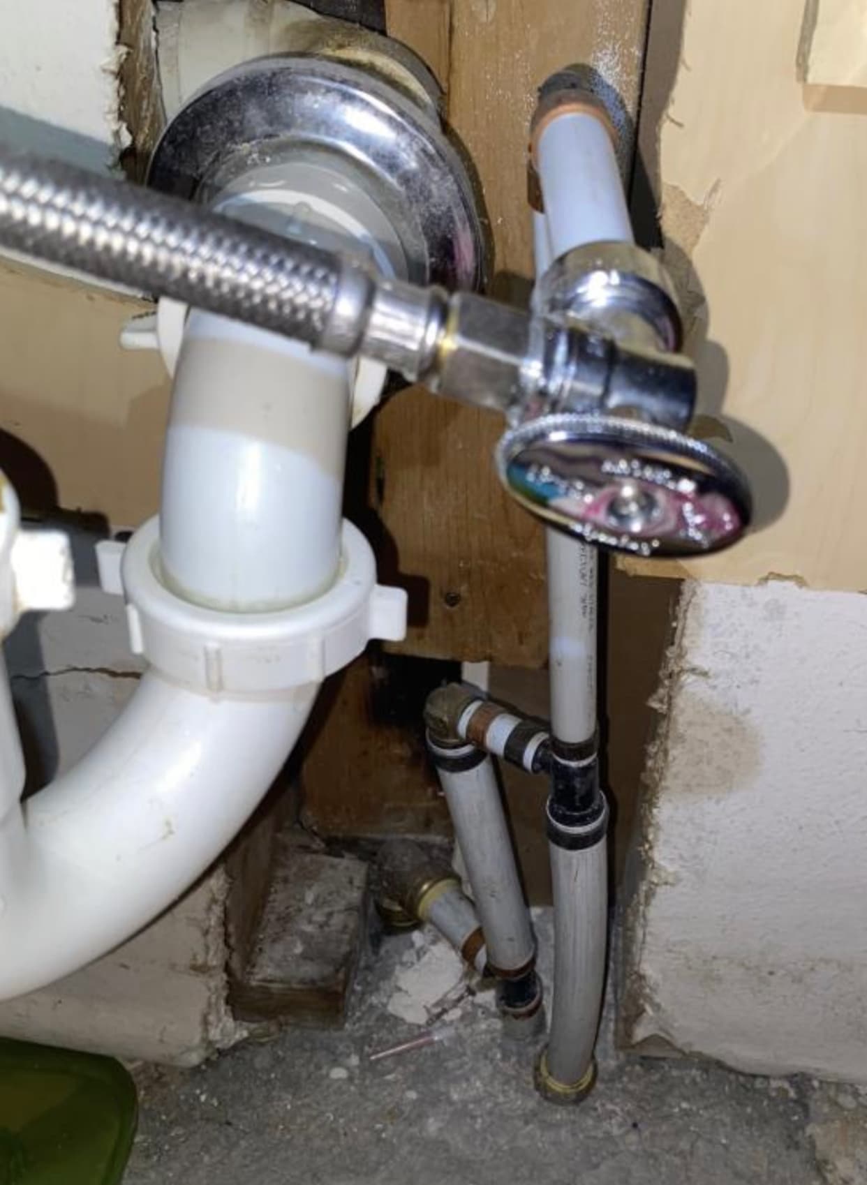

Only legible marking is the one see in the picture. What do you guys think ? Poly ? Townhouse built in 1992

That is it! Look for PB2110.

Did it have PB2110 on it? It looks like poly.

It very clearly Poly B. And appears to be a manifold system.

because of red/blue stripes?

The lack of angle stops.
Most straight run Poly is routed back to the central manifold .

Got sure Larry ! That’s why these guys are the best. Thanks everyone

So What’s with all the paint? To make it look pretty under a cabinet that no one cares about? Or to hide the PB2110 markings? Hmmmm.

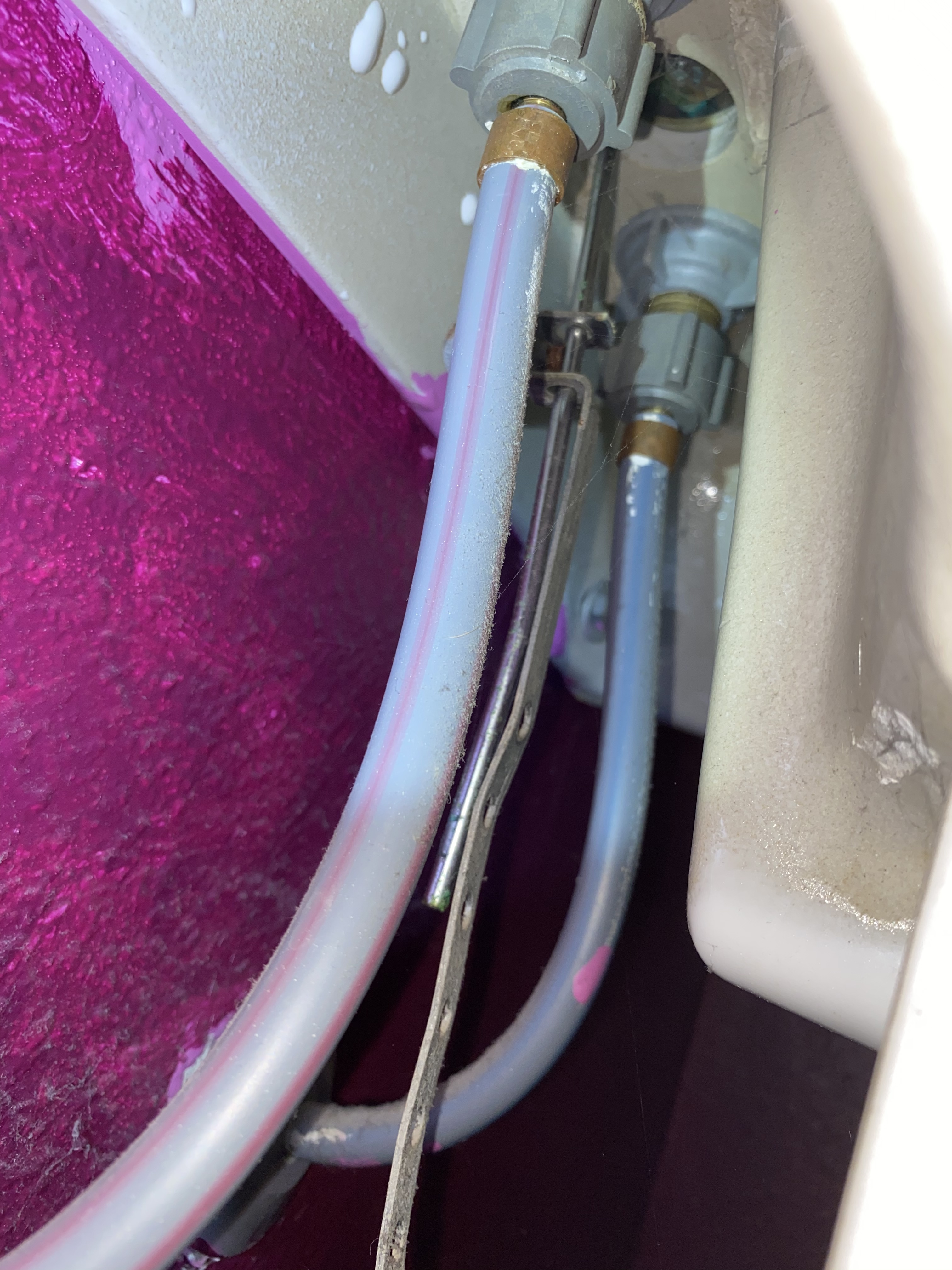

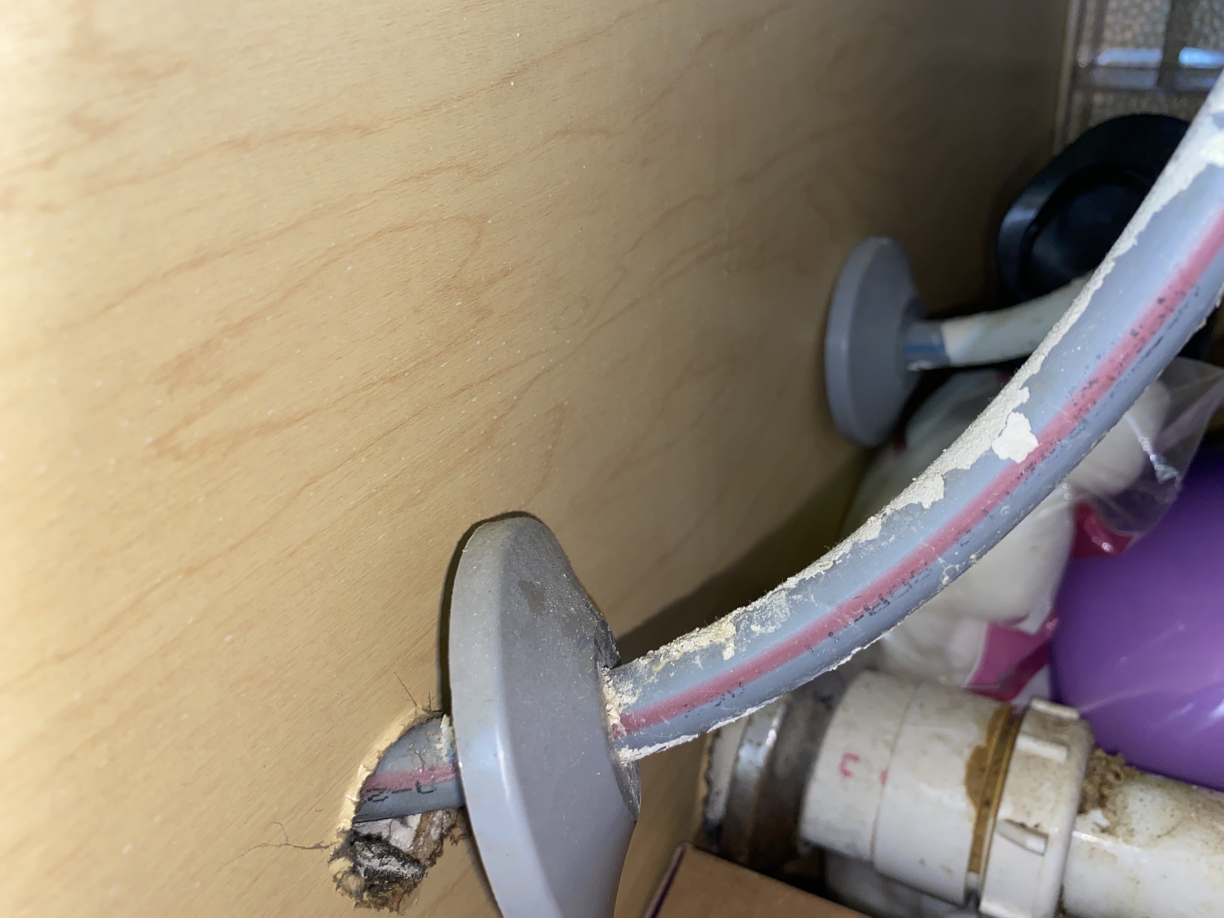

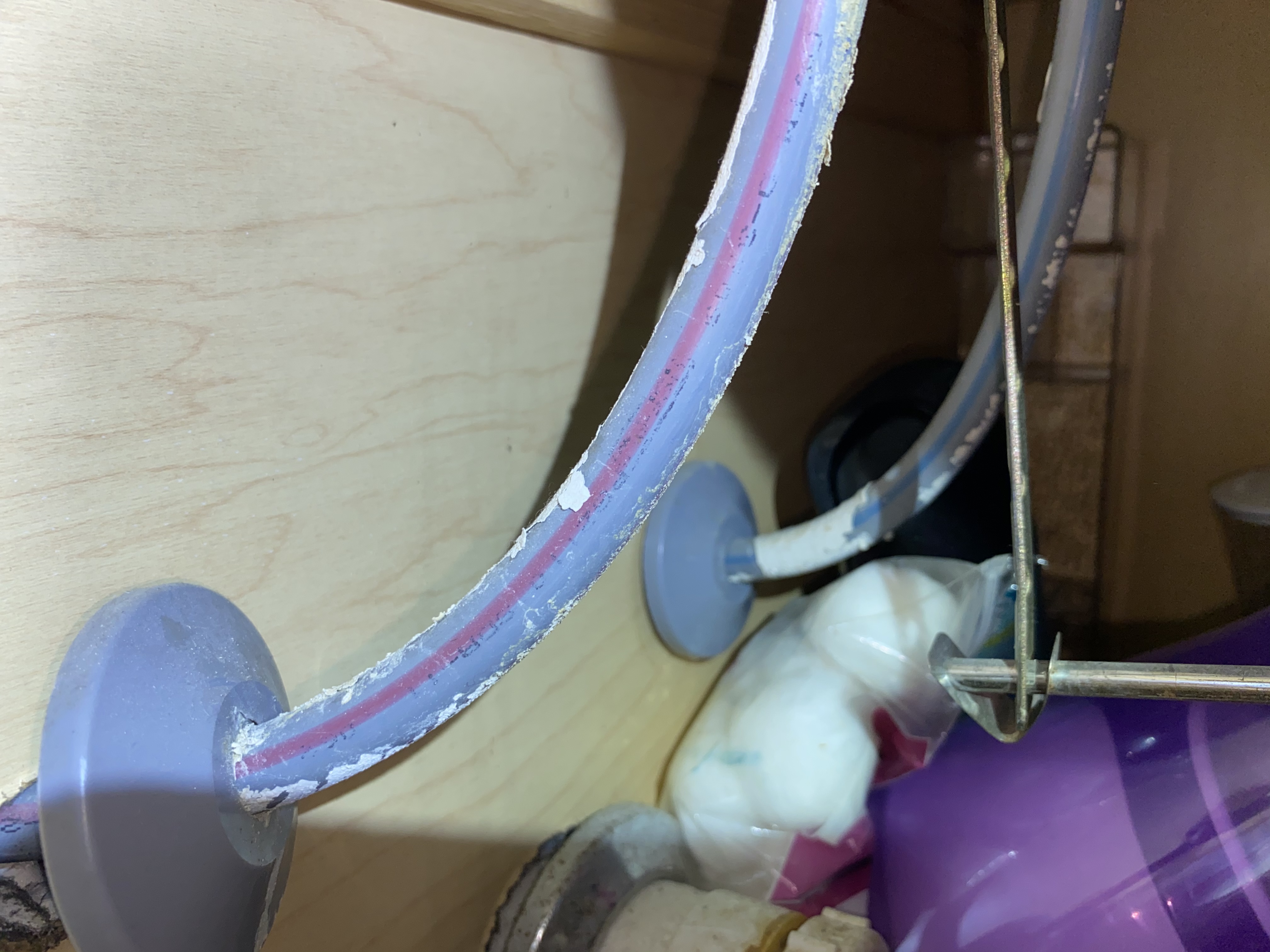

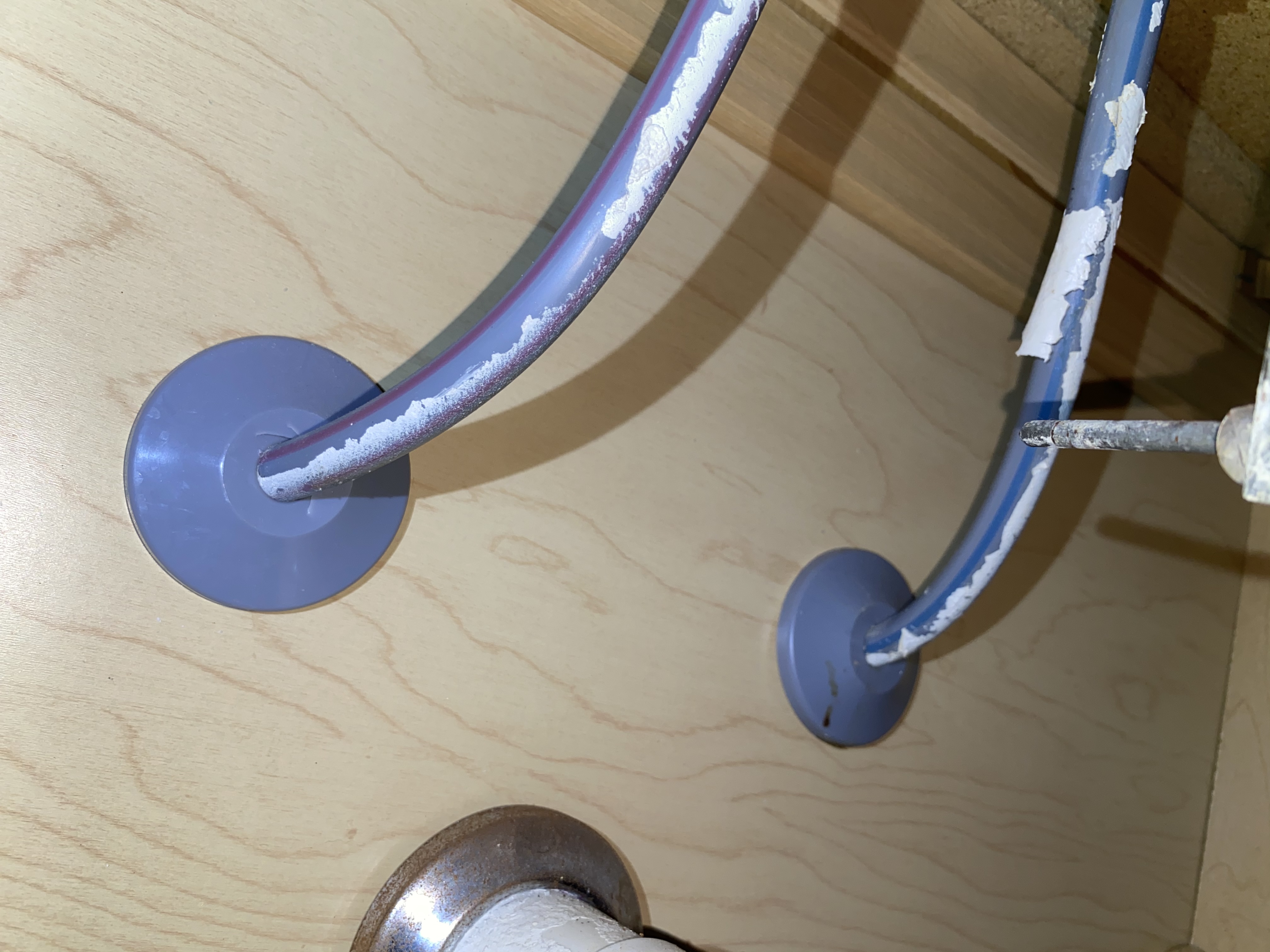

Poly or no? Any thoughts?

Curious, you’ve never seen PEX? That’s what those pipes are, BTW.

Lol I saw that too, but I’m only asking because the Previous four point has it marked as Poly, to me it looked more like PEX so just wanted to get others opinion.

Whats was at the other fixtures or in the attic, etc.?

Everything else in the home was cooper. Home built in 1984.

It’s Poly, just not the Poly you are thinking. It is Cross-Linked Poly ethylene
