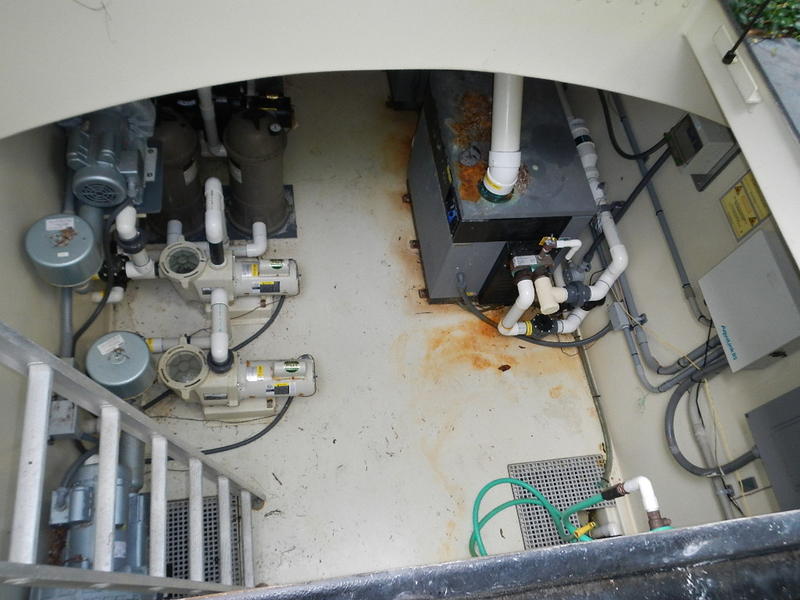

Larry…I think getting through to people that it is a self circulating system and just breaking it down piece by piece will help.
I remember I went a pool equipment area and there were 13 pumps! There was a ton of fountains and waterfalls throughout the property. But once you break it down and follow it through, its rather easy.
Also hit on Chlorine Generators, Heaters, Electric heater that feeds a gas heater, air blowers, check valves, how do you know an electric heat pump is working, just because the fan is moving does not mean the compressor has activated.
Weir doors, lights, most common leak areas and maybe how they get repaired so you know the circle of pool life and maybe even some costs.
Maybe a way to remember where the jandy handles WERE when you first started. I have seen guys twist and turn handles then have no idea how to get it back to the original condition and maybe some secrets you can share.

Russ, I hate those buried equipment rooms!!! I would have loved to see you searching for it though
