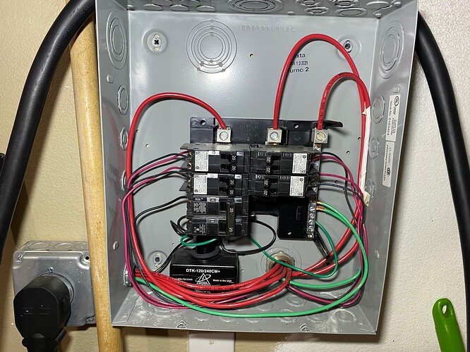

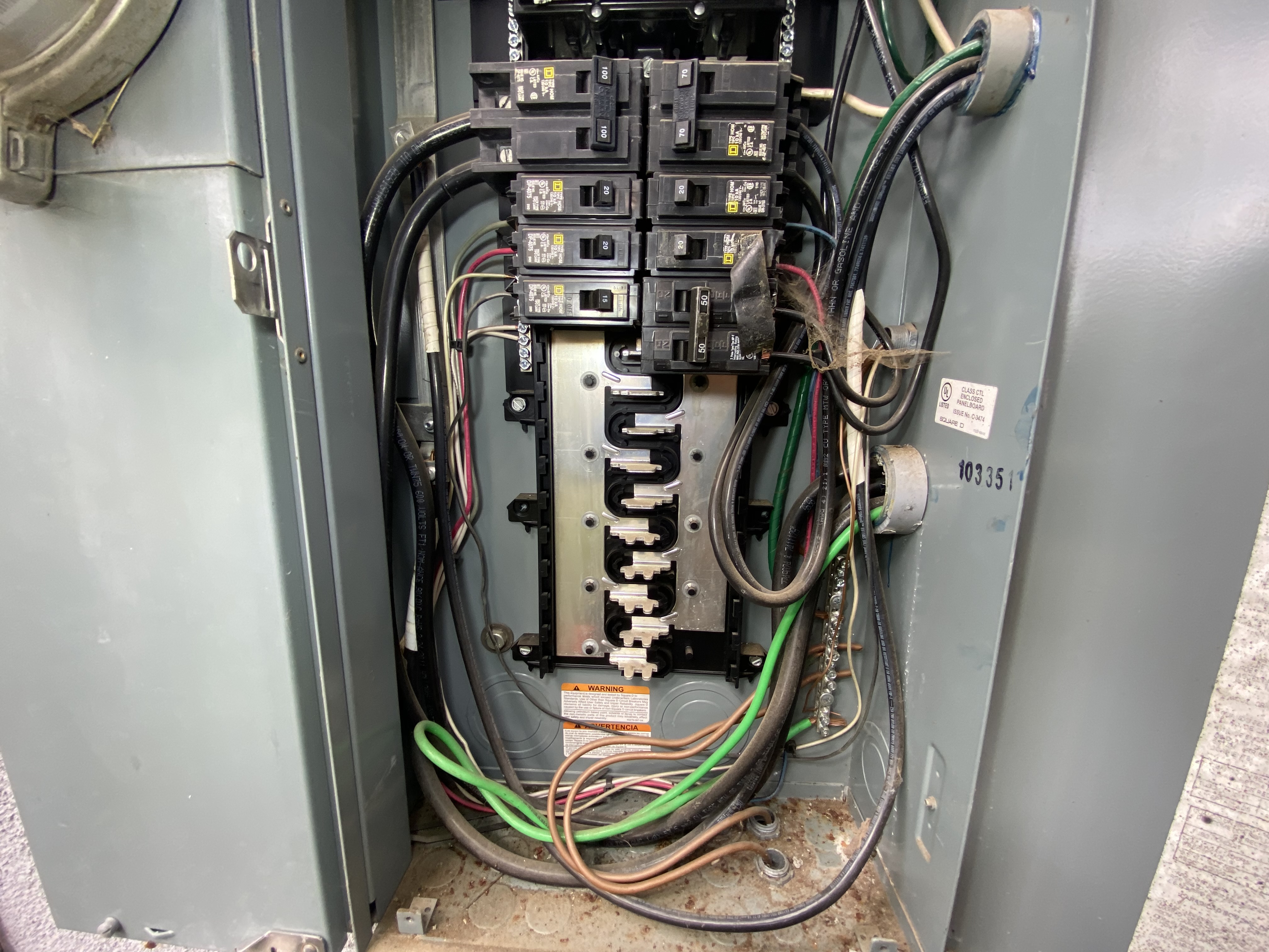

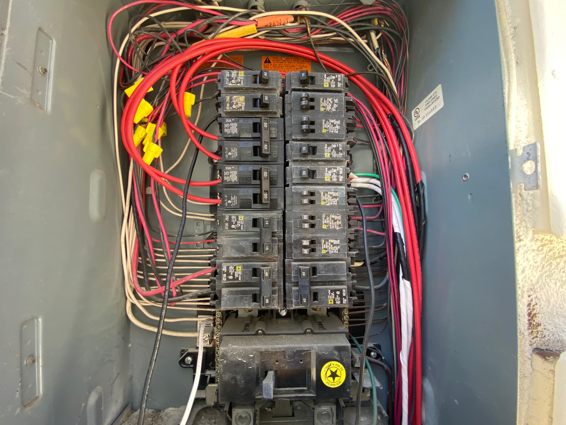

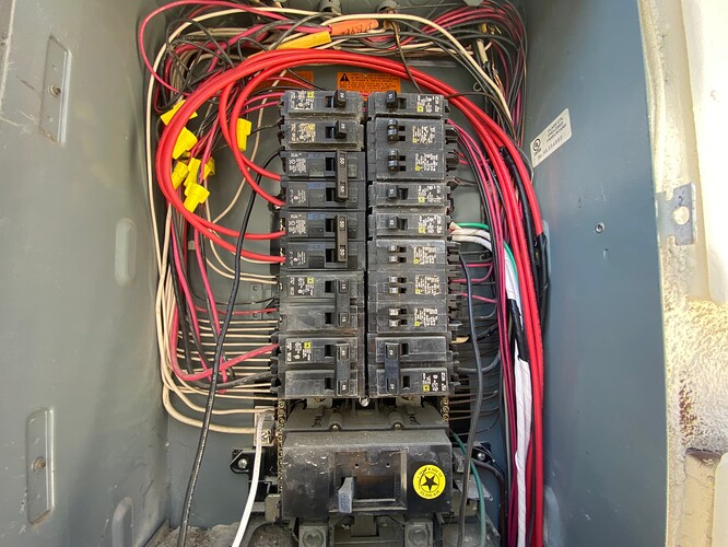

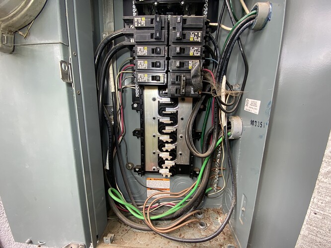

I recently came across this panel where the circuit neutrals did not extend to the sub-panel along with the ungrounded conductors. Are there any potential risks here worth recommending an electrician to take a further look? Thanks for your time.
Main
Sub
What is the sub panel for? It looks like it could be all 240 loads like electric heaters that don’t need a neutral, or a break out for a backup generator.
Also it appears handle ties are missing in the first panel (likely the second too depending on what it’s running).
If there are 120v loads in the sub, I believe technically the neutral has to come with the hot.
It looks like an amateur mess. Yes the neutrals need to be run with the ungrounded condcutors for their respective circuits. The sub-panel has EGC’s landed on the neutral bus which is incorrect. The #8 AWG red conductor cannot be reidentified as a neutral. Looks like MWBC’S without handle ties.
Theres probably more things wrong than just that.

Once you get to #4 AWG or larger then the red conductor can be re-identified with the white tape as shown in the photo.
200.6(A) Sizes 6 AWG or Smaller.

Write hard on this one, definitely a mess. Uncle Bubba special-“he knows lectric”
And the feeders (#8) are likely too small for that load
Speaking of more things wrong, I did see 14ga wires at 20amp breakers

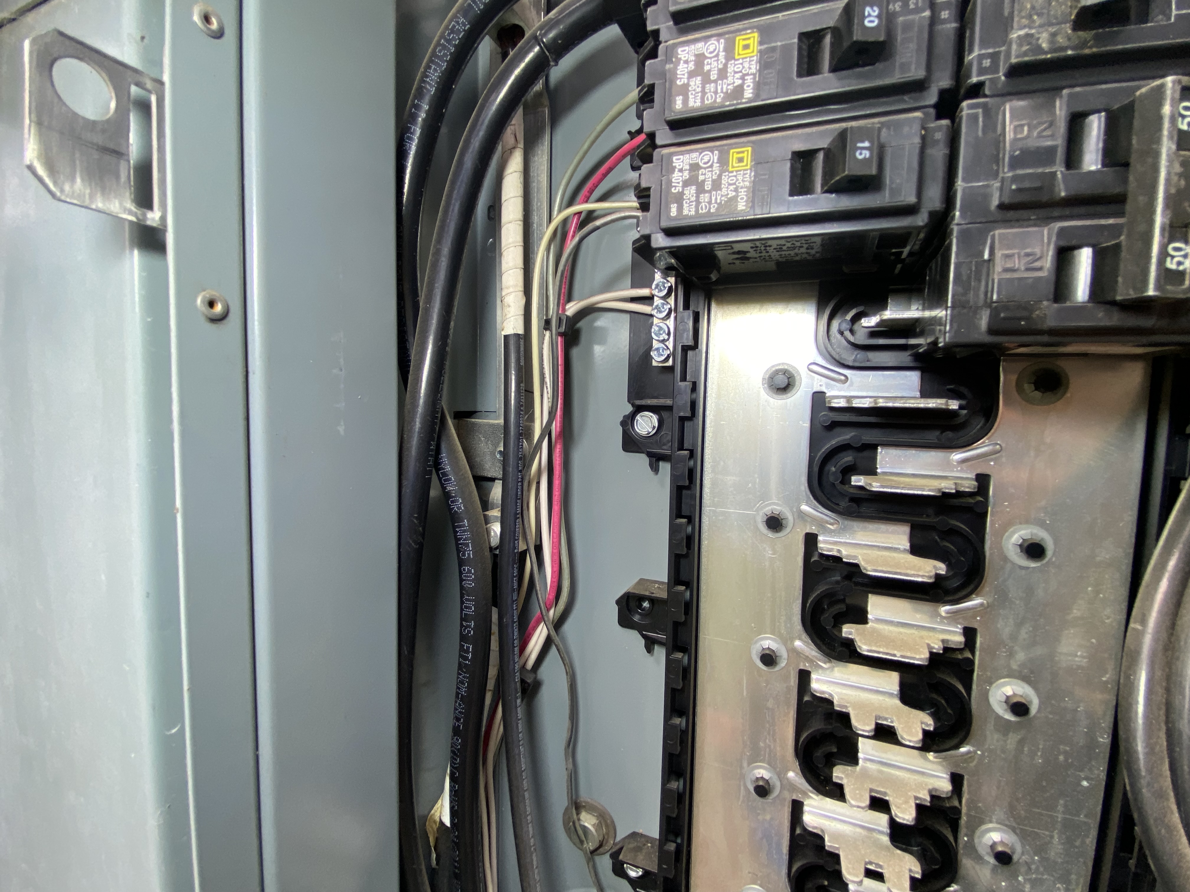

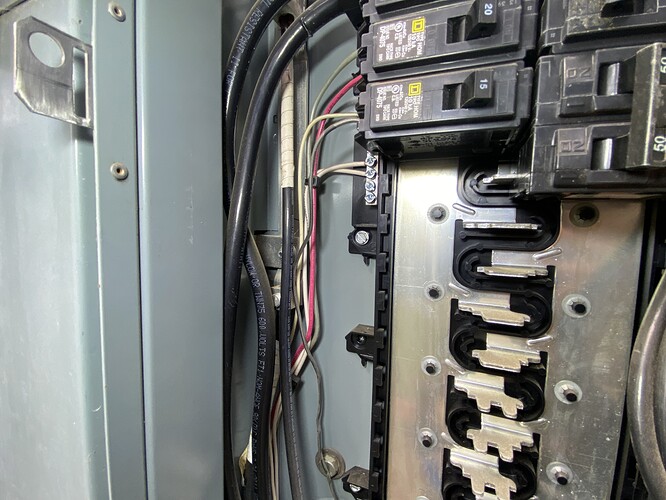

Robert, what about these wires, can they be reidentified as a neutral wire like this?
Number 4 and larger can be reidentified with paint or tape.
