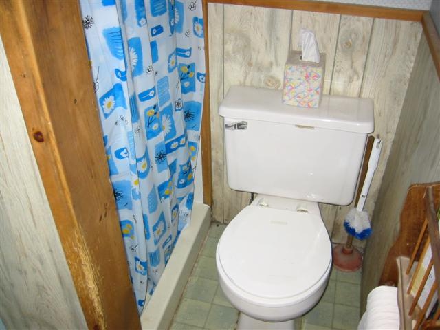

I really like posting the QOD based on some of the crazy stuff that I have inspected my self, so from yesterdays adventure in deepest NH here is a bathroom question ![icon_lol.gif](upload://zEgbBCXRskkCTwEux7Bi20ZySza.gif)

Originally Posted By: gbell
IRC P2705.1

Originally Posted By: roconnor
http://www.nachi.org/bbsystem/usrimages/I/IRC_FigureR307-2.jpg ]
Looks like the toilet might meet the minimum clearance provisions, even though it's pretty tight ... but the clear space in front of the shower entrance isn't even close to the required/recommended 2' clearance per R307.1 ... ![icon_eek.gif](upload://yuxgmvDDEGIQPAyP9sRnK0D0CCY.gif)
That bathroom should be reconfigured (maybe just turn the shower opening if possible) ... either that, or get additional health/life insurance and pre-paid slip-and-fall legal services for when (not if) someone with wet feet will slip on the tile trying to get out of the shower ...

Originally Posted By: aslimack
I’ll be serious for a moment. There appears to be more of a stain under the shower side of the toilet, suggesting that the wax ring may be, or has been compromised, by the inevitable bumping into that it must take when exiting the shower. That and what R. O’ C. said, regarding possibly suggesting the opening be changed to the left as appears to be possible. At least from what is available on the photo.

Originally Posted By: gbeaumont
Hi to all,
Glad you enjoyed that one.
the correct answer is that both the WC and the shower do not have sufficient clearances, the WC space was only 26 inches wide (should be 30 inches), and the shower enclosure obviously does not have the required 24 inches of unobstructed space in front.
