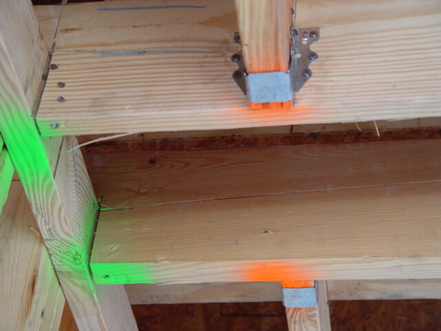

Originally Posted By: gbeaumont
Hi to all,
here's todays question
Regards
Gerry

Originally Posted By: bbadger
I am not sure of the right answer but apparently less than what is shown in the picture.
What people will do still amazes me.

Originally Posted By: James D Mosier
They should be OK, they’re marked with green paint. Green is good.

7
Originally Posted By: lclark
Does the orange mean they need to replace the joist with the split in it?

Originally Posted By: roconnor
James D Mosier wrote: |
They should be OK, they're marked with green paint. Green is good. |
Only if it's strong paint ... ![icon_lol.gif](upload://zEgbBCXRskkCTwEux7Bi20ZySza.gif) ![icon_lol.gif](upload://zEgbBCXRskkCTwEux7Bi20ZySza.gif)
Notice the split in the wood forming from the notch ...

Originally Posted By: bsmith
The poll seems to be fairly evenly split. What’s the right answer?
See IRC Figure R502.8 as a
guide ... compliments of
www.iccsafe.org.

Originally Posted By: tallen
I voted for 1/6th

Originally Posted By: lkage
tallen wrote: |
![eusa_doh.gif](upload://has2a0g32D0AAlDjAwVcrg3HnhX.gif)
I voted for 1/6th
So'd I...one third span areas are 1/6th I see.
