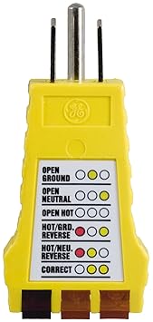

For sake of discussion… Answer 'C’ as written is not the correct answer.
Does this photo NOT show
http://ecx.images-amazon.com/images/I/710JUlA8stL.SY355.jpg
Sure looks like MULTIPLE problems to me.

Thanks Jeff, and you are correct. I wanted to say E: all of the above. I was trying to get my response in quickly.
The tester cannot detect multiple wiring problems other than the ones shown on the tester itself. So, in a case such as below, it would not be detected.

Simple three light testers cannot detect two potentially serious house wiring errors: (1) neutral and ground reversed at the receptacle. (2) a bootleg ground, where the neutral and ground pins have been connected together at the receptacle. This may be done by someone fitting 3-prong receptacles on a circuit that has no ground wire. These errors can be detected with a multimeter and a test load, to verify that the ground connection is separate from the neutral and is not carrying normal circuit current.
http://www.thecircuitdetective.com/outlet_tester_readings.htm
And also here;
Yes, a three-lamp circuit tester is inexpensive. But the truth is: These devices can be very inaccurate and give you a “CORRECT” indication when, in fact, the outlet has one or more problems. Following the indications given by the circuit tester can lead to additional problems later.
So it can detect multiple wiring problems, as indicated on the tester label. However, there are also multiple wiring problems that it cannot detect.
