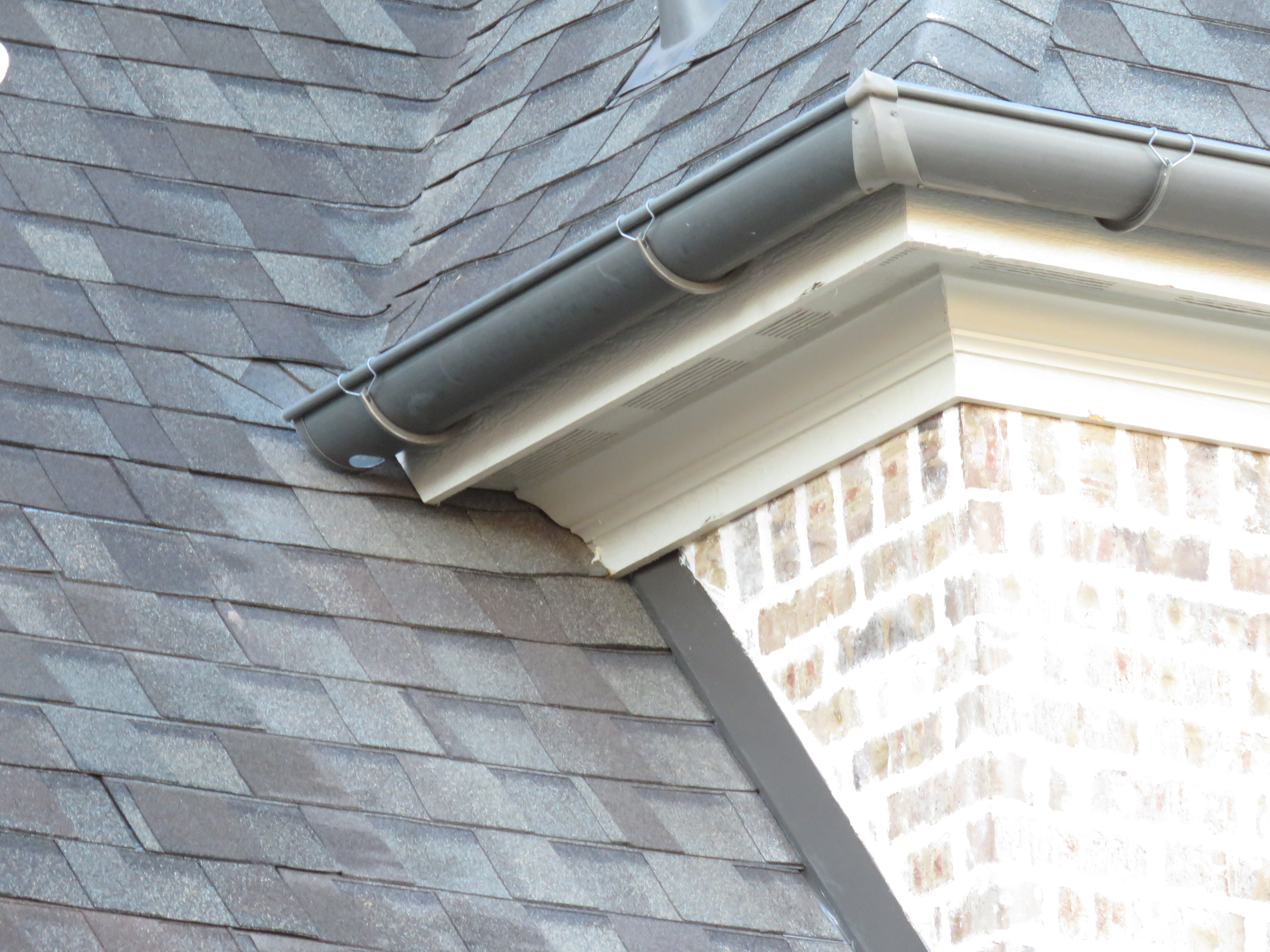

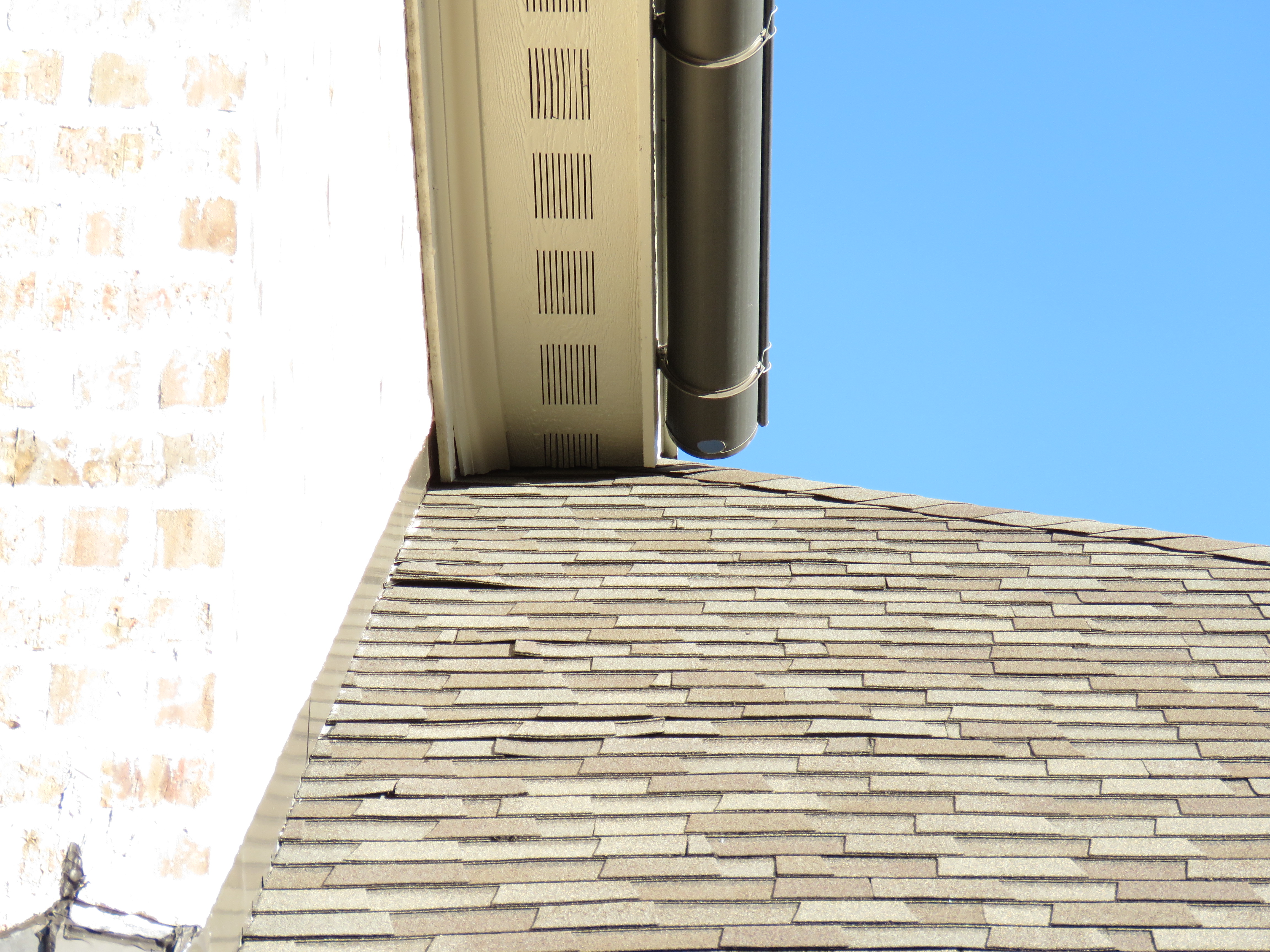

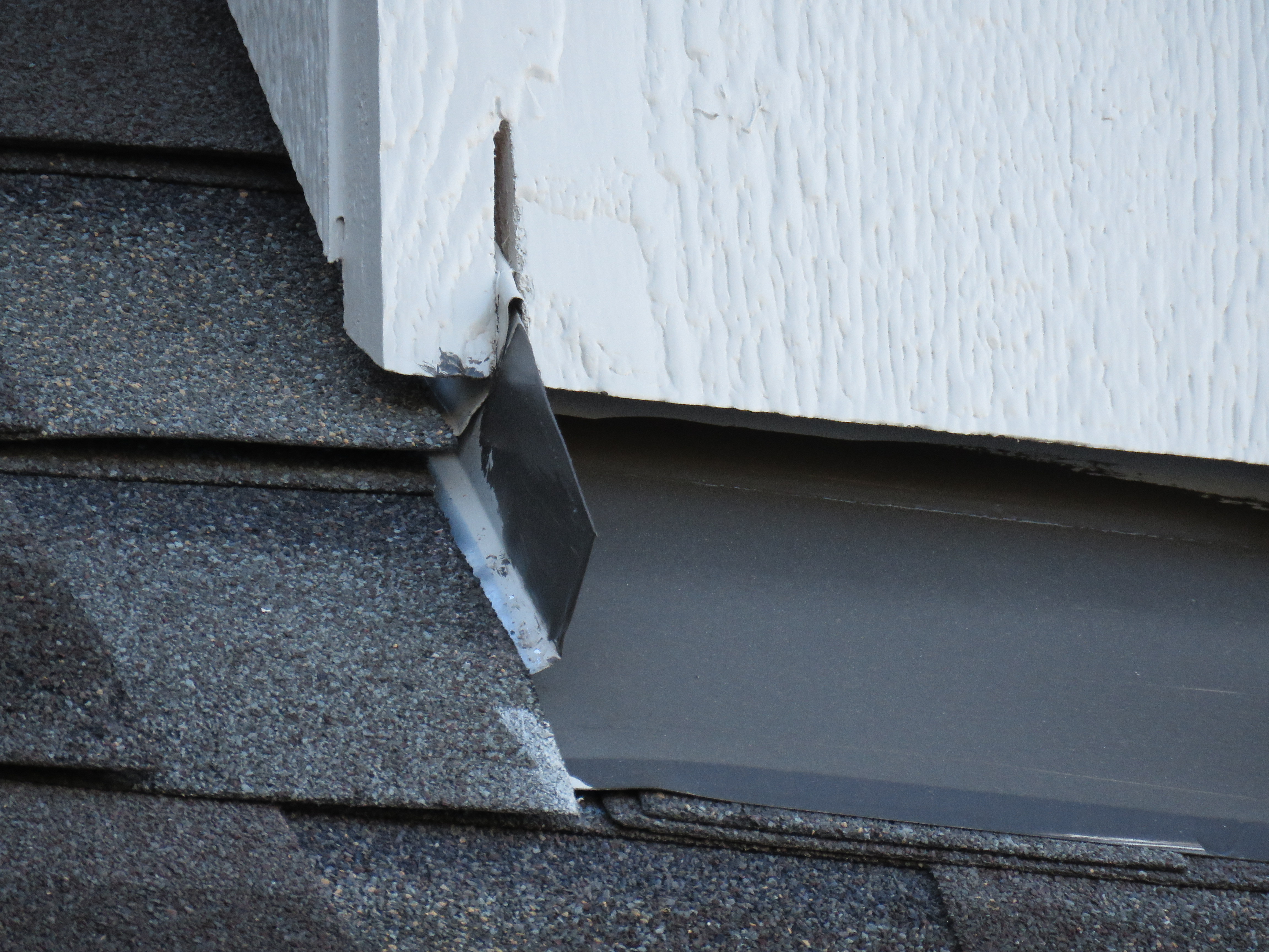

Question 2 – What is wrong in these pictures? The following information is to be used for this question.
Siding and trim is LP SmartSide siding and trim.
Shingle manufacturer is not identified.
Gutters are on site fabricated.

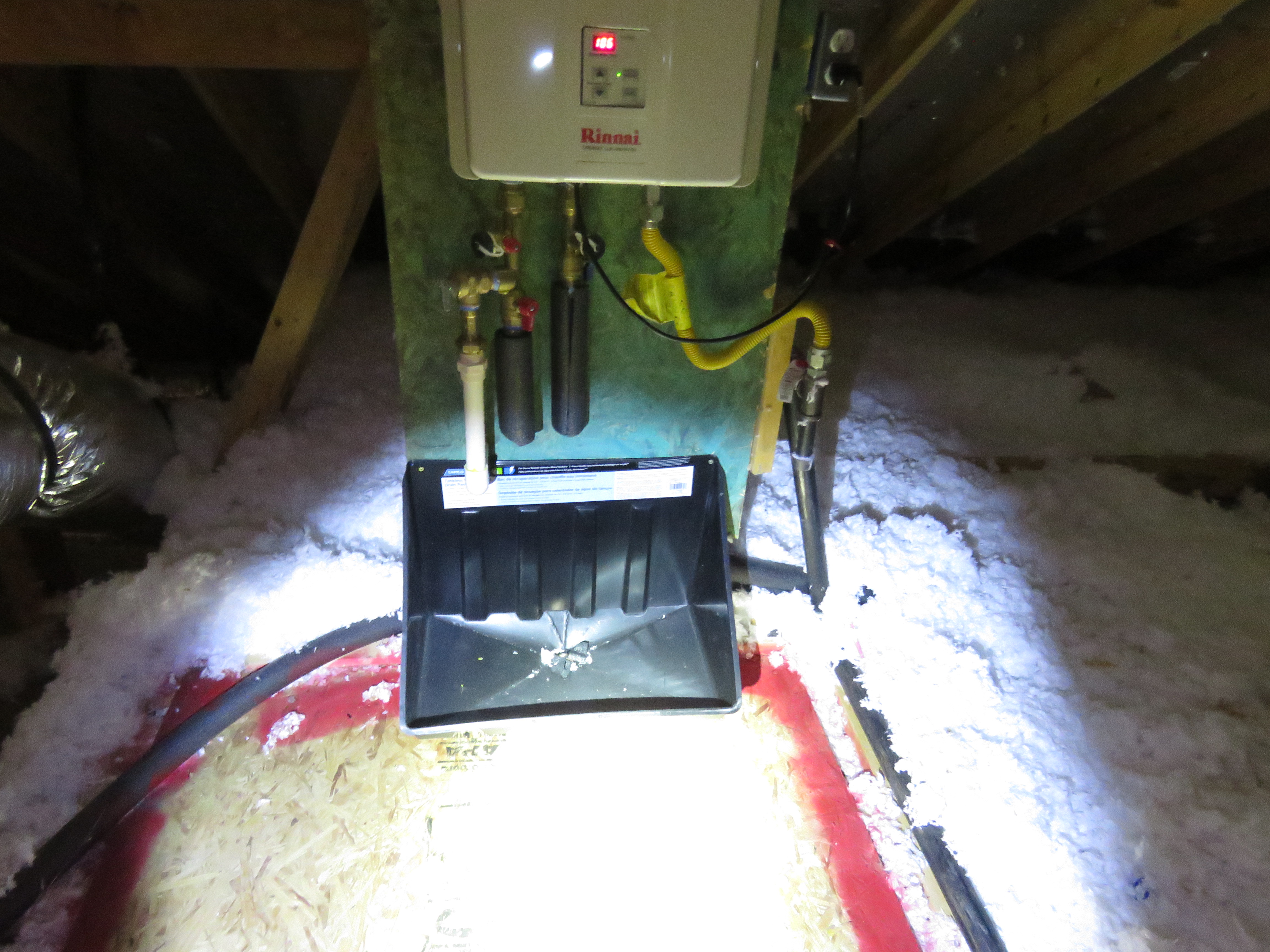

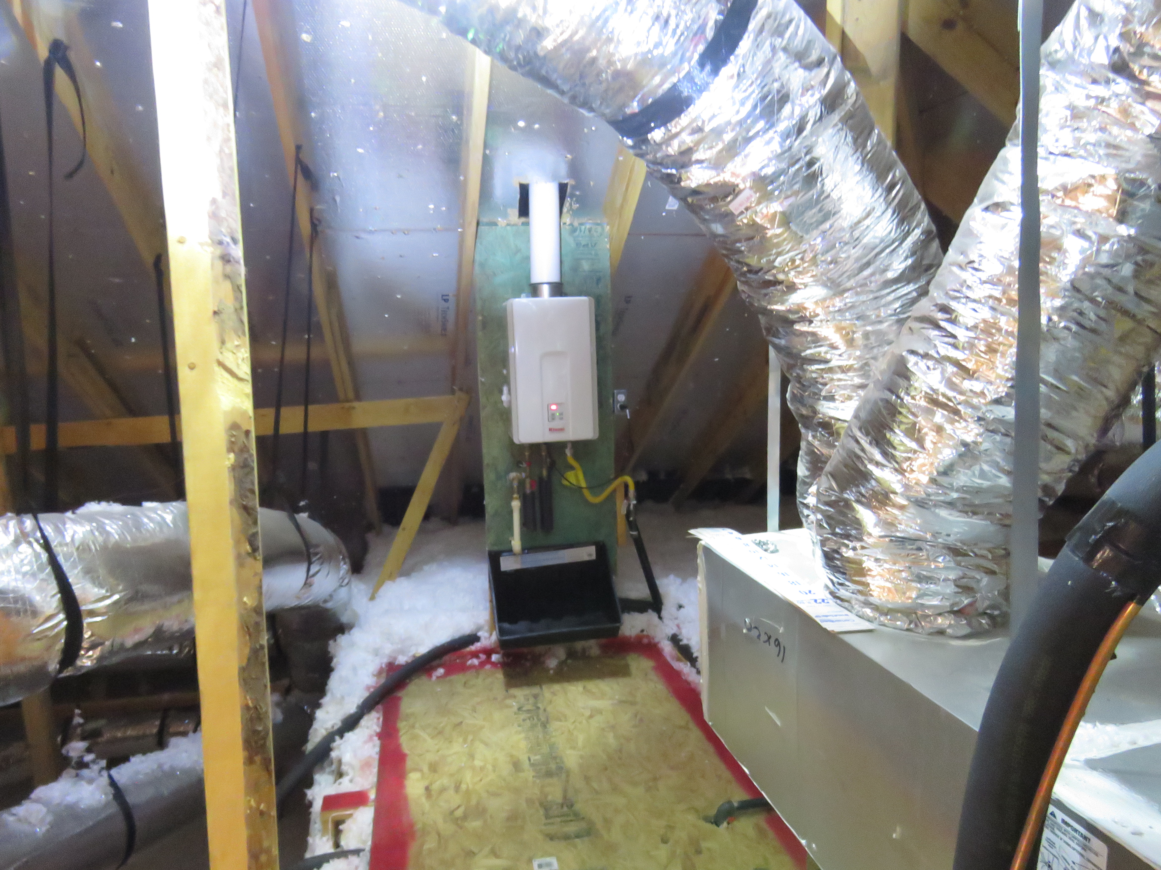

Question 3 – What is wrong on this new construction installation of a Rinnai V75iN tankless water heater.

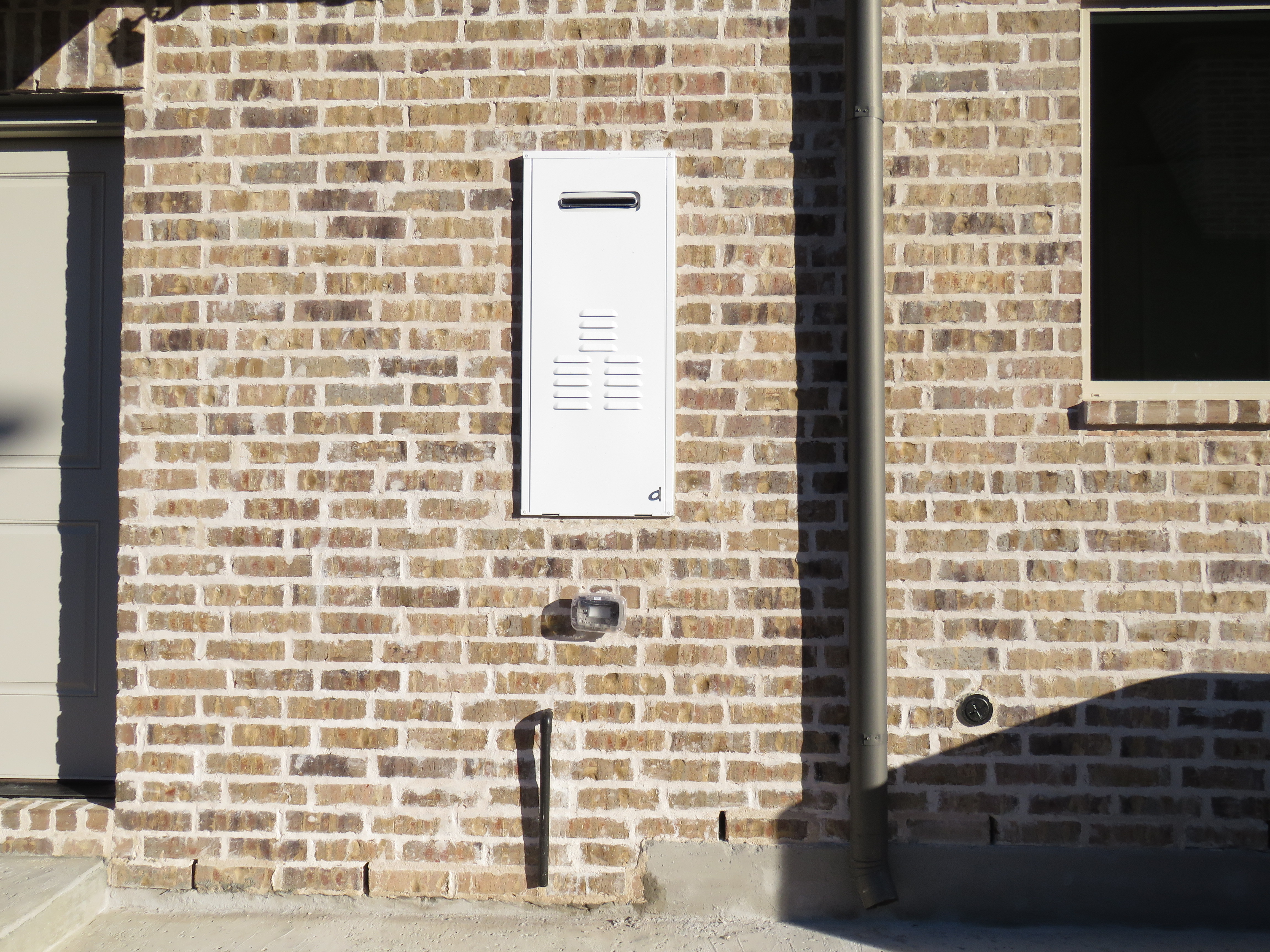

Question 4 – This is a new home final inspection. What is wrong with this tankless water heater? This is a Rinnai whose specific model number is not known but not needed for these deficiencies.

  1. The shingles at the base of the valleys don’t appear to be properly secured and are askew. Additionally, the LP material is in contact with the roof in multiple locations and it doesn’t appear to have the appropriate WRB or flashing installed per the mfg instructions. The flashing at the base of the dormer compromises the trim and again is improperly installed. Gutters without downspouts just make nice jets to damage your roofing materials, but it is just about the look, right?

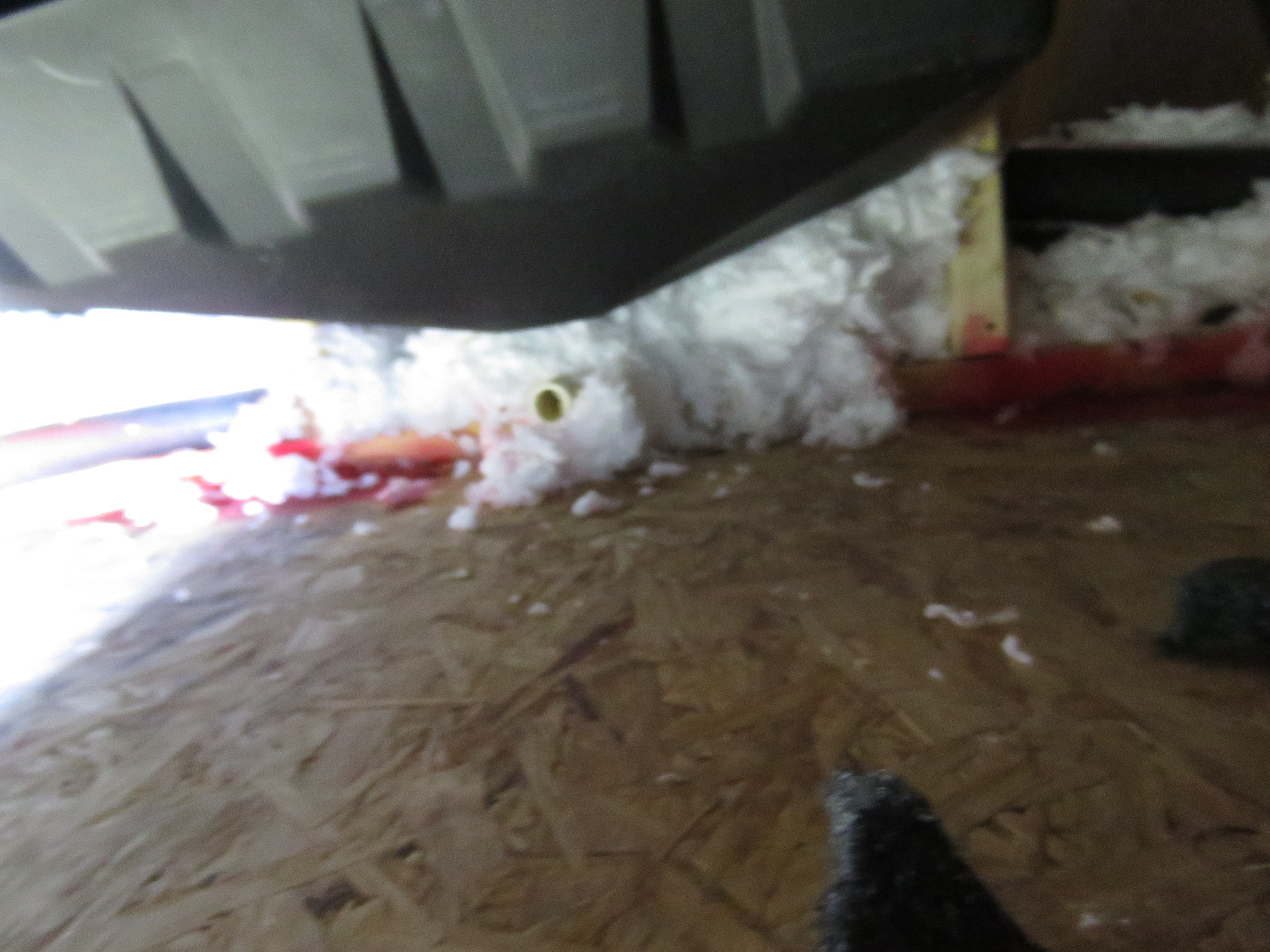

  1. The drain pan under the unit doesn’t appear to be connected to anything and if the open pipe visible below the pan is the TPR run that goes toward the back of the unit, then it isn’t routed correctly. There is no condensate line with a 3” loop installed on the nipple at the exhaust stack for vertical vent installations. Similar to this:
  1. I can’t tell (even zoomed in) if the weather resistant cover below the unit is a cut off switch - if not, add it to the list. The outlet in the cabinet is not secured, and I don’t see how the unit is powered for ignition with nothing plugged into either outlet. The TPR line may be ABS on the exterior of the home (unless it is painted black)

  1. Siding & trim are installed too close to roof materials. Water running down the shingles is likely to be wicked up from the ends of the siding & trim. (capillary action) This will cause moisture damage, premature wear & deterioration of the trim & siding.
    The manufacturer’s installation instructions require:
    -That flashing extend up at least 4 inches behind the siding/trim.
    -A 1 inch gap between the ends of the siding/ trim & the roofing material as well as maintaining room between the end of the gutter & roof or walls for maintenance of siding/trim.
  2. No condensate drainline & safety pan drainline not connected.
  3. No thermostat installed, electric power source not connected, cable not secured, cable not rated for damp location (exposed yellow sheathing portion but will likely be resolved when appliance is properly wired))
Answer 2 – There are multiple issues noted in these images.
The LP SmartSide products have not been properly installed and display the following issues.
Trim is not maintaining proper clearance above shingles.
Trim has been excessively cut where flashings have been run through and trim
has not been replaced or repaired.
Trim has not been properly mated together and not sealed at gaps.
Vented soffit trim has been improperly cut at vent openings. The material is
already bending and damaged at the louvered openings.
Although it may be difficult to see in these pictures the siding and trim cut
edges and uncut edges have not been fully painted to protect against
moisture damage.
The gutters have not been properly installed and display the following issues.
Gutters are being allowed to improperly discharge directly onto shingles
through holes at their rear ends. This can place concentrated water flows
on shingles and cause accelerated wear and large amounts of water at/on
trim and flashings.
One of the gutters is actually discharging directly on ridge cap shingles.
Answer 3 – There are two visible errors.
The unit’s condensate drain line on the flue has not been configured.
The safety drain pan has not been connected to the drain pan line.
Answer 4 – There are multiple issues with this tankless water heater. Of interest to note is that the AHJ actually passed these conditions on both a plumbing final and CO final inspection. Another reason for buyers to hire their own Inspector.
The electric has not been wired to the tankless yet.
An improper outlet box is in use inside of the cabinet.
The remote temperature controller has not even been wired to the unit.
