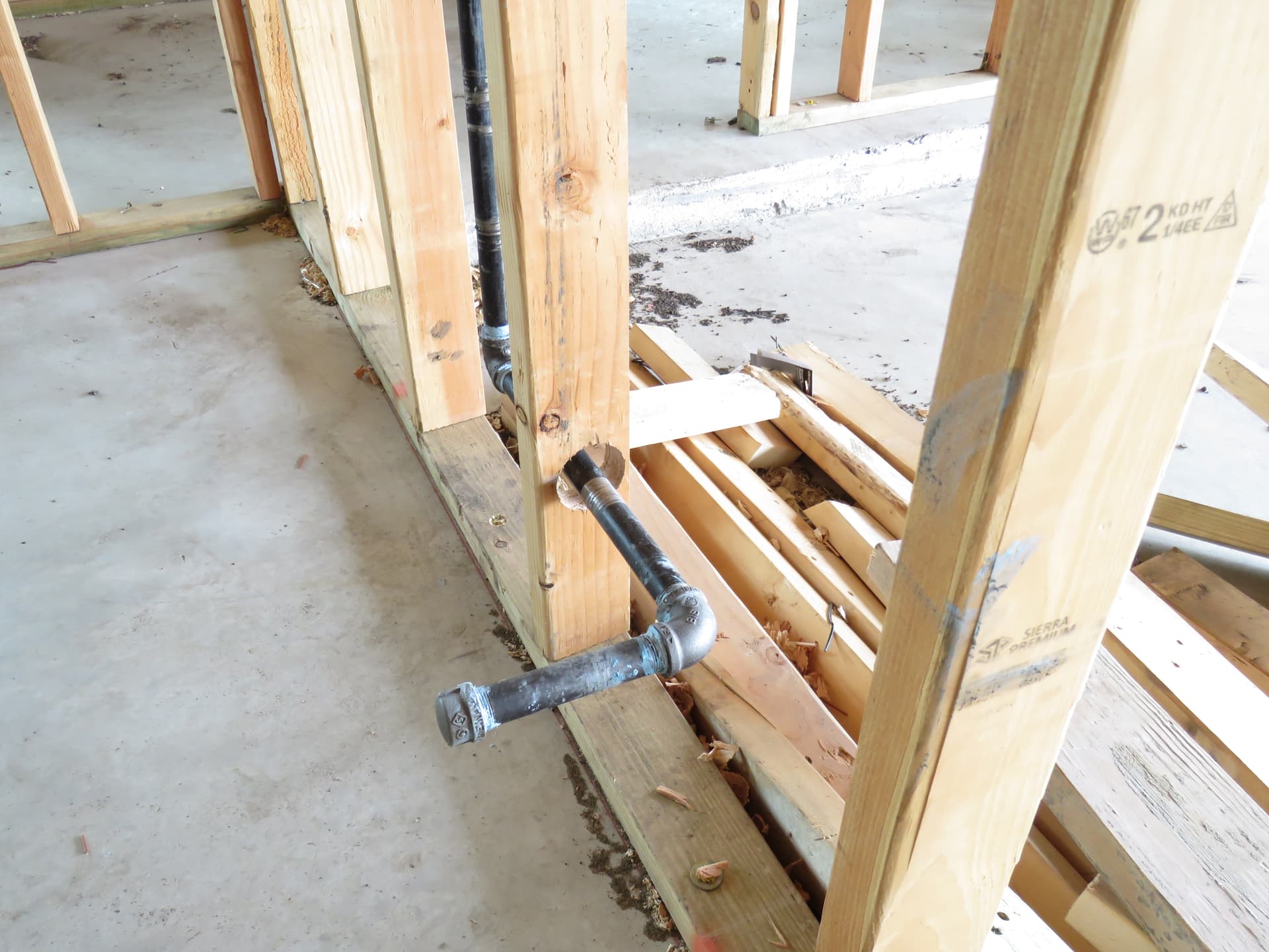

What is the common problem in these four pictures? Also provide the specific problems related to it that can be seen. To help you without giving it completely away think of the worst case scenario with this common problem and that is what is there. Remember the pictures are high resolution if you want to expand them for closer views. Yes this is a pre-drywall inspection however you can easily see something like this in any finished home in areas that have no wall coverings.

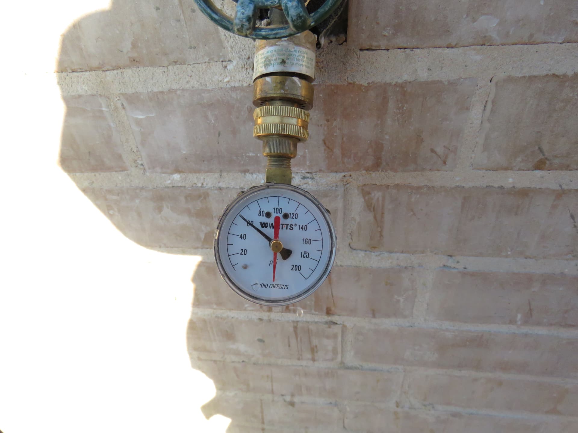

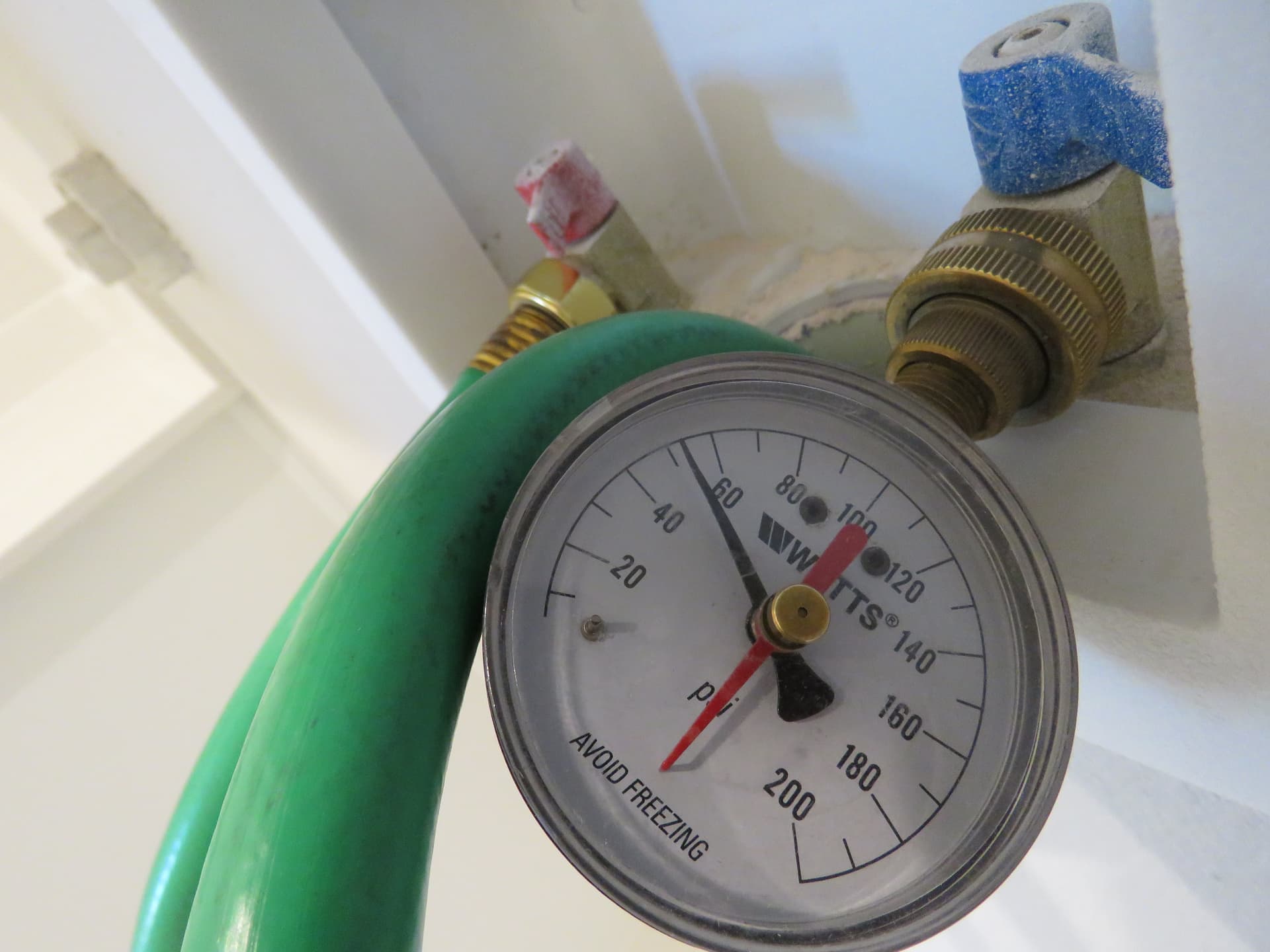

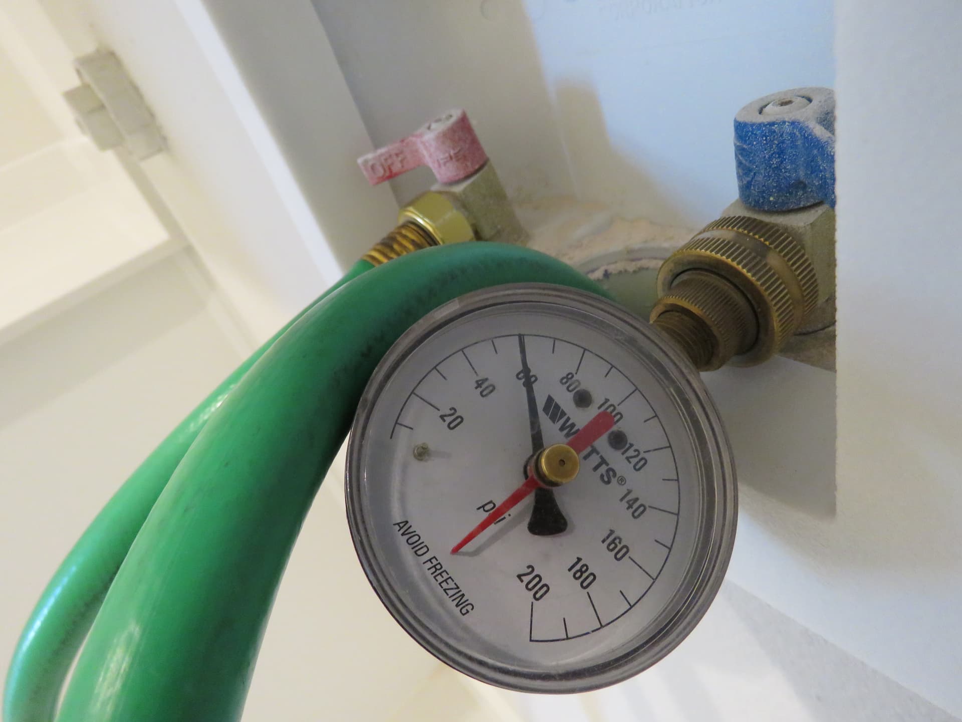

One reading was taken from the exterior early in the morning at the start of the inspection. The second from inside near the end of the inspection. What’s wrong here?

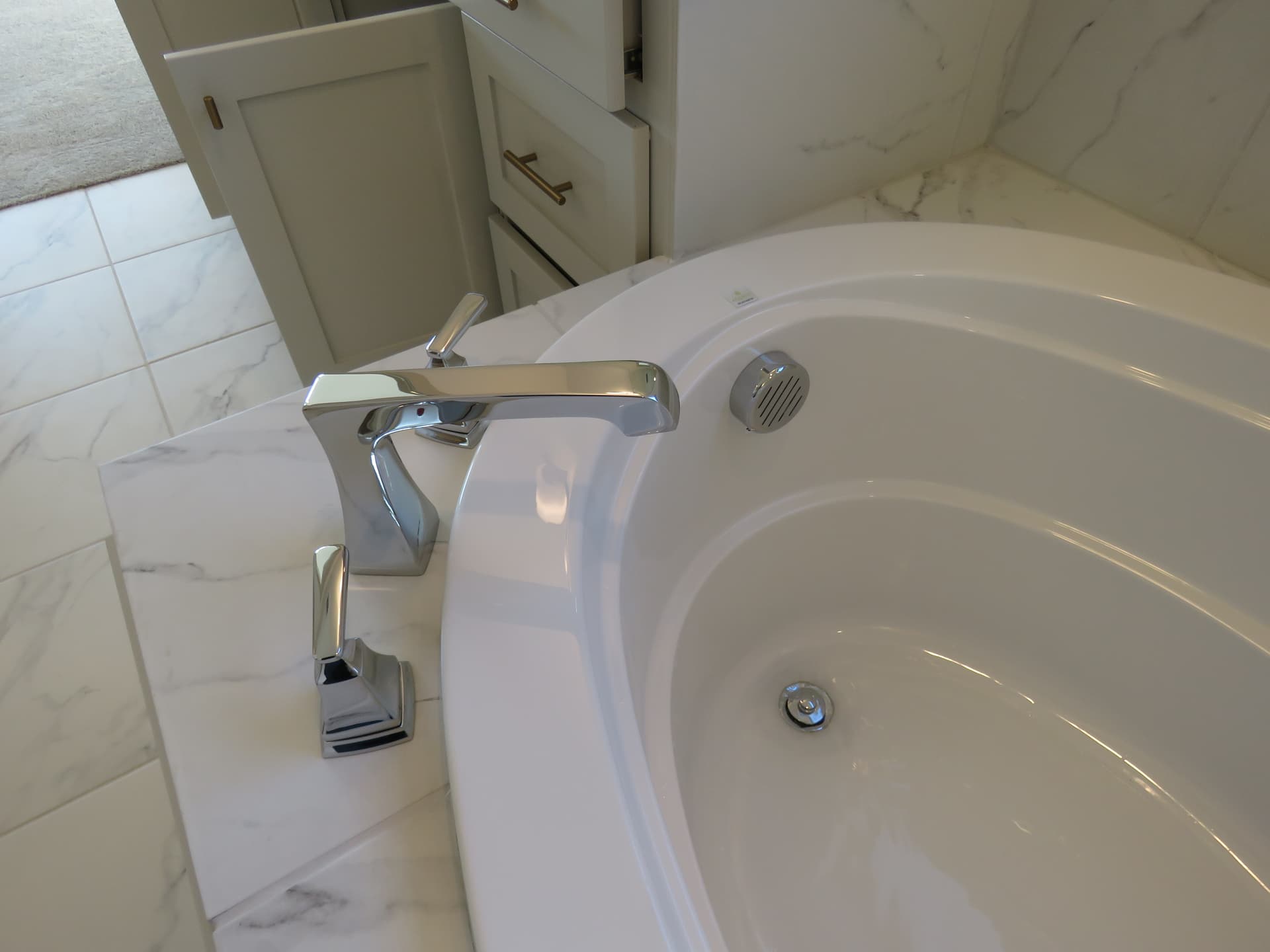

Given that the plumbing fixture has been properly installed with its aesthetics also accounted for what is wrong here?

  1. Ok, so we have a new house of Horrors here. At first glance I would say you are kidding. I would say the common problem is a complete lack of any kind of quality for all the trades that thought they were doing something right. The common problem is the other trades complete lack of regard when installing their JUNK. Let’s start with the worst case as I see it. The walls have been compromised with the terrible modifications to install everything. The gas line holes are drilled oversize and removing any structural integrity and there is no support for the lines. Can we say movement and a possible gas leak when the pipes move. EXPLOSION. All of the plumbing is a terrible install with no clearance to the edge of the studs. Water lines and drain lines are all bad. What a terrible job in the protection plates. They are not even flush with the surface. Next we can proceed to the electrical wires. Randomly run and I say that mildly, with no supports to keep the wires away from the edge of the walls to allow the sheetrockers to drill through at several places to trip the GFIC breakers if in fact there are any installed. So in summary. We can have a gas leak then a spark to cause the explosion but on the bright side we can have the water spraying all over to put out the fire.

  3. The maximum pressure indicator was not set so there is no way to tell if there is a pressure spike that would be controlled by the pressure regulator.

  5. The handle is not installed properly and the over flow although functional? Is not installed properly. If you can see this it makes you wonder what is wrong that you can’t see.

1: The common problem is a lack of concern by the plumber for the job of the other trades (framer and electrician and sheetrock to name a few). The studs have no remaining integrity due to excessive bore sizes and poor plumbing layout, and the nail plates are a joke.
There are electrical wire issues also, but not common to all photos.

3: So the static pressure dropped 10 psi during the day. Hmm. I have no answer, just more questions like what was the outside reading at the end of the inspection. Maybe the sprinklers went off, and the house has insufficient flow?

5: The handle is backwards?

For #3 if you’re running a full flow test on the hot, and the cold dropped 10 PSI on a new house, I’m at a loss for why. Unless it was the same plumber that drilled all the stud holes, then all bets are off :wink:

  1. Simple 1st-over notching. Then, the gas pipe is not secure.

  3. There is a water leak somewhere.

  5. Faucet handle backwards
