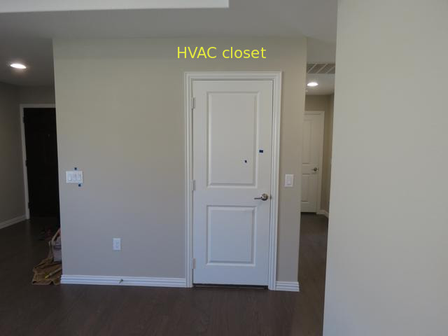

  1. This is an example of a single story home with an interior HVAC closet containing the cooling system evap coil as well as heater/air handler. The second and third images display the evap coil primary condensate discharge point and configuration. What is the black device being pointed to in the last image and what is its purpose?
HVAC1
HVAC2
HVAC3

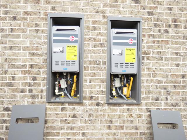

  1. The following are images of a pair of Rheem RTG-84XLN-1 tankless water heaters installed in an exterior brick veneer wall with 2 X 4 wall framing behind it. There are at least two issues clearly visible here that you don’t even need the manufacturer information to determine. What are the two issues?
Tankless1
Tankless2

  1. Condensate drain line float switch.

  2. Pressure relief valve piping reduced in size.
    Condensate drain line missing

  1. A waterless min trap. Allows free condensate flow while blocking sewer odors. Redundant with a pvc drain trap installed.
  2. Missing conduit bushing/fitting where the electrical conduit enters the enclosure. The union fittings at the T&P relief pipes.

  1. condensate line backflow preventer that prevents sewer gasses and water from backflowing up the line.
  2. Improper flexible gas hose. The shut off switch inside the enclosure right next to the TPR :drooling_face:

  1. Looks like a backflow preventer, like a FloodGuard
  2. Not an expert on these yet, but I can’t see where the pressure relief is plumbed to, and so the home owner wouldn’t see if it was leaking.

  1. Drain trap seal
  2. TPR piping appears to be ½” piping
    Interior rated switch

  1. Waterless trap seal
  2. Electrical entry missing bushing
    Reduction in size of tpr pipe
HVAC1
HVAC2
HVAC3
Answer – The device is an inline drain trap seal. This particular device is manufactured by Rectorseal and is used in lieu of a trap primer and as a protection against sewer gas escape back into the HVAC closet. You can read about it here https://rectorseal.com/product/sureseal-waterless-inline-drain-trap-seal/ .
Tankless1
Tankless2
Answer: The most obvious issue is the improper use of an interior rated switch instead of a proper exterior rated switch for the electrical cut-off function. You could add a third issue in that the switch should not be located inside of this cabinet but that would require looking up the manufacturer information. The second issue is that the penetration points in the bottom of the cabinet are not being properly sealed. This cabinet does extend into the framed wall cavity. Any leakage from the unit or penetration of water from the exterior can drain into the framed wall stud bay.
Note After The Game: I should have warned Y’all away from the relief valve piping. Those are all slip fittings for 3/4" pipe but can be very deceiving. Even I had to do a double take during the inspection to make sure.
