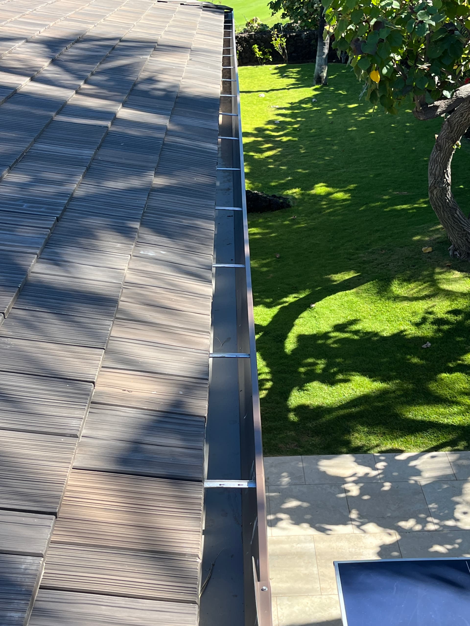

Did a home inspection yesterday on a 6000 sqft home, new roof and new rain gutters but no downspouts anywhere ? So I went back up on the roof to have another closer look. The rain gutters have horizontal openings that appear to travel through the large overhang soffits and possibly through the wall structure of the house. Could not find anything in the attic or exiting the exterior of the house.
Anyone ever see this before ?
Internal leaders, which I’ve never seen before on residential.
How dose this work ? where dose the water go ? sewer system maybe

Google “Hidden Gutter Systems”
Heres one example…

Actually, hidden gutter systems have been around since the 1800’s!

Nothing hidden on those gutters, only the downspouts are hidden. Looks like fun to keep clean. :stuck_out_tongue_winking_eye:
The buried pipe is connected to the storm water sewer system, sometimes to sanitary sewer or sloped out to daylight.
Some municipalities do not allow it to be connected to the sanitary system. Often, there is no underground storm system. These factors as well as cost will dictate the design.

In my area a truck rolls around every few years, blowing smoke up the sewer
Anyone with smoke coming out a gutter or drain gets a correction notice.
