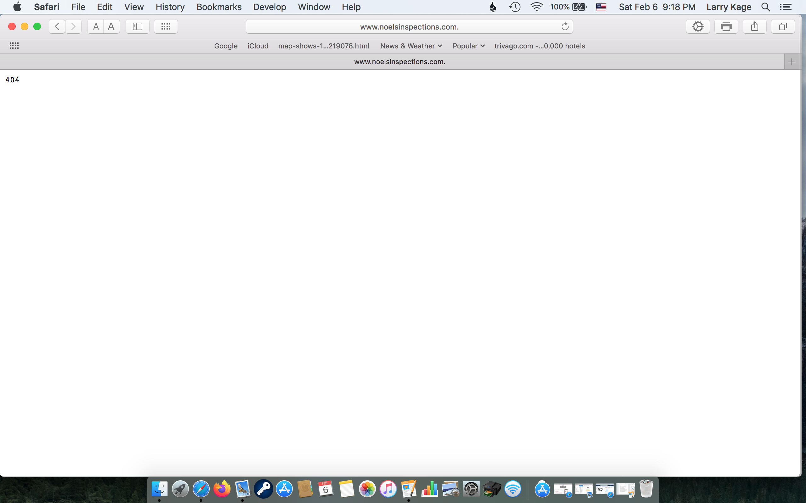

Angela, your website brings this up:
I thought you’d like to know.

Larry, there is a period in the hyperlink on Angel’s InterNACHI profile. The link works fine without it!
This link works fine, Saman.
