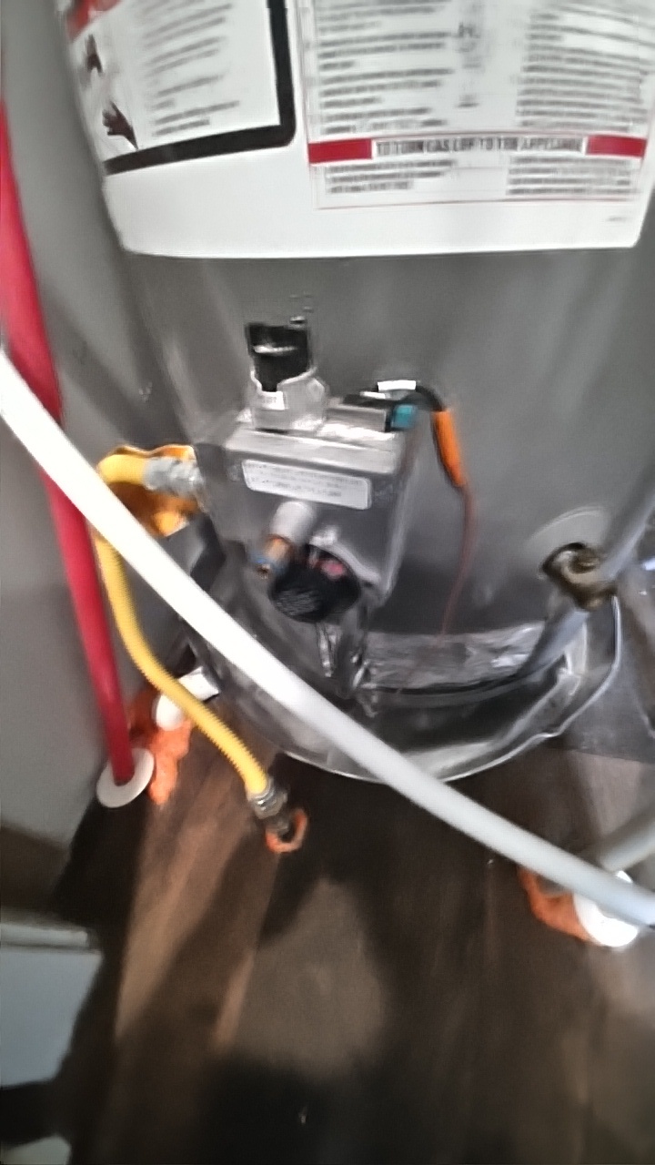

Heat shield raised (no vent hood present) and flue directly connected to WH chimney. Loose, unsecured clamps:
For a WH with no power vent, this is new to me - no vent hood. I can’t locate installation information on line. What do you know or have seen?

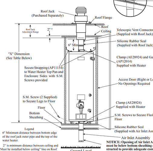

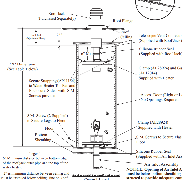

With that drip pan under the tank, I would doubt that there’d be a combustion air intake coming through the floor. That’s where a picture from floor level is very important to confirm whether or not it’s pulling combustion air from the crawlspace. It probably should be pulling combustion air from the crawlspace.
The exhaust flue components are consistent with other water heater installations that are manufactured specifically for manufactured homes. When you say “no vent hood,” I think that you are referring to the lack of a draft diverter. For this specific type of water heater, I don’t think that we should expect to see a draft diverter. Did you touch those “clamps” to confirm that they were loose? I’m not yet convinced that there’s a loose clamp in your photo.

@ruecker got it right. Thanks for this information! There is an air intake under the floor in the crawlspace. I wasn’t able to see how the pan was penetrated, but it actually had a drain. New WH conbustion configuration for me.
