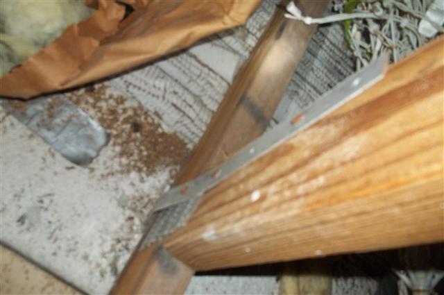

I can not tell the wall attachment. I am not quite sure of your what you are asking.
Roof to wall would be balloon frame or conventionally Truss or rafter on double sill plate.
That attachment looks to have greater than 1/2 inch spacing making it a toe nail. However, the truss appears to placed next to a girder or double truss. Can’t tell what is next to it from the pic. If it is within 5 feet of the inside or out side corner, on a hip or valley jack, it is to be ignored.
This is why I posted the picture along with the question.
That is near the rafter jack and should not be counted. However, someone told them it would be marked a toenail on the form. I told them how to correct it in the event that someone else comes out to look at it.
See picture one below.

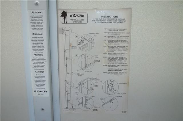

The second and third pictures are the ones that went into the report and are two trusses away from the other one.
As for the roof, another inspector said it was a non-hip roof due to the roof not coming down as far as the rest of the roof.
The sections of the roof at both ends of the pool would be non-hip. If the length of these is less than 10% of the total roof length, it is hip. That is assuming that there are no other areas like that.
As to the strap, it can be 3 feet long but if it does not wrap over the truss and have nails on the other side, it is a clip. The strap in the first picture would not meet the requirements if is is not within 5 feet of the corner (although I would still give them credit if I only saw one or two).
Good comments Jay! On the roof shape question , looks like a hip roof with a short half gable on the cut out section. This is easily included in the percentage section of 1802.
The length of that “non-hip feature”, was 27 feet. The rest of the roof is a hip roof. The total perimeter of the roof was 274 feet.
I took the picture of the wrap in the first post that way to show the triple truss next to it. As that is next to the valley, it wouldn’t be counted. However, if someone were to take a picture of just the wrap and put that in a report, it would go from a clip to a toe nail. That is why I told the client how to fix it as it is the first clip visible in the attic.
Although since you fall into the 10% or less with your version of the amount of non hip portion, I disagree on what you are calling non hip. The wide area of the cut out portion of the roof is still part of the hip structure. The only non hip portions are the small half gables on each end of the cut out portion. From looking at your pic I would say they are about 6 ft. in length each. Those small have gables are the only non hip sections.
The entire length of the clipped gable end is NOT non-hip…only the sloped rake ends. The horizontal roof edge is hip. If this is the only non-hip sections on the roof, it is likely HIP without doing the math.
You didn’t say that Eric, you said the entire elevation was non-hip - 27 ft. The only non-hip on that elevation is the sloped rake on the end and the sloped rake adjacent to it on the other roof line.

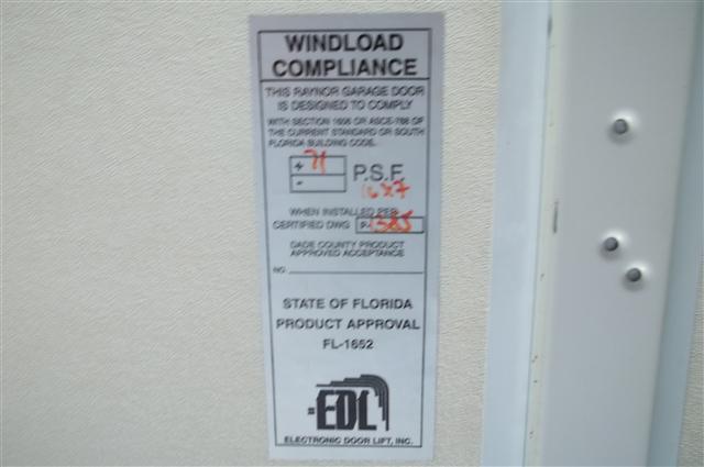

Look up the FL# on that garage door. Dasma 108, E330 is wind-load not impact. Some doors require the vertical bracing for wind-load approval.
Yes I did. I said another inspector included that area and that is where I got the measurements from. I didn’t bother to measure the home for the same reason you mentioned.
As to the garage door, if you look on the sticker, you will see this is a “Prisma” door. The 1385 report is not for a Prisma door. Someone put the wrong sticker on the door.
Attached is the proper sticker from the installer, EDL.
As to the door, the reason I mentioned it is that in some instances, things aren’t always what they appear to be.
I told the client that something isn’t right here as this door was installed with permits and inspections. It also had the additional vertical bars. They contacted the installer and then the installer came out and put the proper sticker on, which, I had already looked up.
