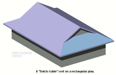

Is a dutch gable 100% hip?
Check out NACHI’s “How to Perform Wind Mitigation Inspections” course - Section 5 (Roof Geometry) under Hip & Non-Hip Roof Calculations.
Nope. There are 2 gable ends on that roof that need to be counted for.
NO, the small dutch gables are non-hip

I understand why a dutch gable would be considered non-hip (structurally and by measurement) but I don’t see where on the form it specifies anything but perimeter features. Anyway, the Nachi course says: “To determine if the roof is a hip: the total length of the non-hip features are divided by the total perimeter.”
So, basically, even though the question is asking about perimeter, I should really just add up all rakes and eaves regardless if they are on the exterior perimeter or interior roofing?
You have to ask yourself what exactly does “perimeter” mean. I know what the general consensus is according to past training, but what does it really mean? Who here thinks it only means the absolute footprint perimeter of the building, and who thinks it is all roof lines? That is the question…
iT only MEANS ONE THING. tHE PERIMETER…rOOF LINE. nOT OPEN FOR DISCUSSION BY DEFINITION OF PERIMETER…
Damn Caps :slight_smile:
Say it loud and proud:D
AgAiN…i HaVe TO aGRee WITH mIkE!!! :mrgreen: :mrgreen:
length of **all **non-hip fascia / length of **all **hip fascia = >10% = C Other Roof?
