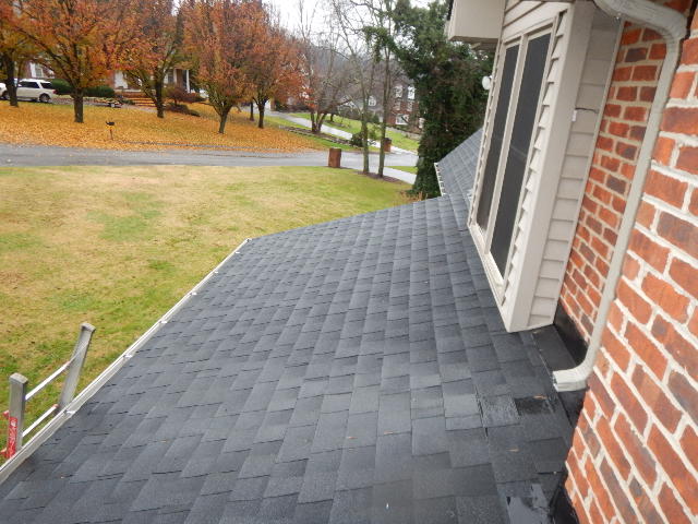

What s the difference between apron flashing and headwall flashing. I inspection a house today with a new roof. My question is why don’t the installers recess the flashing top edge into the brick mortar joints. They have installed the flashing flat against the brick wall and caulked the top ?? This was the porch roof only, the rest of house was recessed into the brick.

I believe they are the same.
They are the same. The OP’s flashing is missing the counter flashing though. Continuous counter flashing doesn’t always have to be inserted into the mortar joint, as there are two types available. One has a sealant outward bend at the top.
