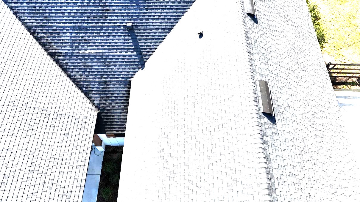

I think this some of the roof has been replaced by the color change noted in the pictures. This house is only 5 years old. Then the other issure is the shingles appear buckled. There appears to be no issues with leaking. Attic appears dry.

Not sure that I can see any buckling, but the discoloration may be from a different lot package for the shingle bundles.

What about the ridges in that roof.
As Thomas said the different color shingles has to do with different shingle bundles at time the roof was installed.
The “buckling” from here is related to trusses and/or underlayment. Nothing to report in my opinion.

Improper sheathing spacing can cause shingle buckling.

Darker areas could be due point moisture evaporation and the time the sun light warms up the roof surface.
One image - 268KB, sheathing appears compressed laterally. Where there H-Clips or gaps in sheathing.
There is only two ways this particular roof has different shades of shingles, one is it was a repair, two it has two different dye lots of shingles, just my opinion,
Unlikely. The OP is in south central Florida and the photo was taken at 11:30 in the morning. The morning dew would have burned up hours ago. The dark pattern has the telltale sign of mismatched shingles.

I wonder if he checked to confirm that the shingle tab glue was adhered, especially at the eaves. If he is in south Florida, I’d think that is an important condition to confirm.
He didn’t. He used his DJI drone to inspect the roof and I don’t see a ladder rack on his Kia Forte, so he probably didn’t have a ladder either.
