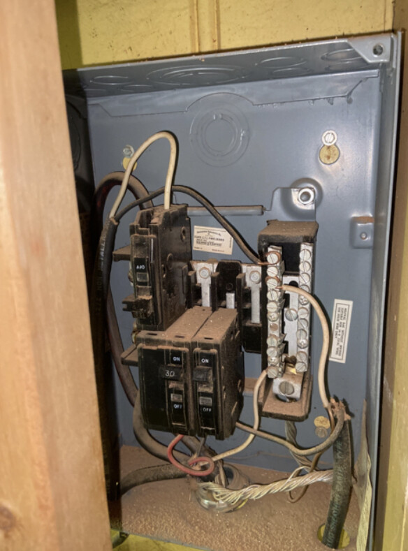

What do you mean when you say that the panels had no grounding system?
I mean that all of the conductors coming into the panel box lacked a ground wire. So they were all two wire romex style wiring that was connected to the breakers without a third ground wire connecting to a bus bar. I was under the impression that since technically everything coming off the breakers/conductors is ungrounded (since they lack the grounding wire) that it should be marked up as such. Please correct me if I’m not understanding that correctly.
Below is the sub panel I’m talking about. Its all two wire romex without a ground wire within the panel. Something you mark up or not?
I took “no grounding system” to mean no ground rods, water pipe bond, etc. Ungrounded two-slot outlets well may have a grounding system at the panel… just not one that extends to each outlet and light fixture.
Looks like a couple of grounds to me…
46BB34F5-7E4B-4D9E-B4E8-36D32C4D2F0B
I could of sworn there weren’t any but that sure does look like a ground wire. Either way it’s something I run into a lot and am curious how you guys mark it up if you do at all. Here’s another sub panel I ran into the other day with only two wire romex coming into the sub panel. Do you mark it up for the lack of ground wires?
