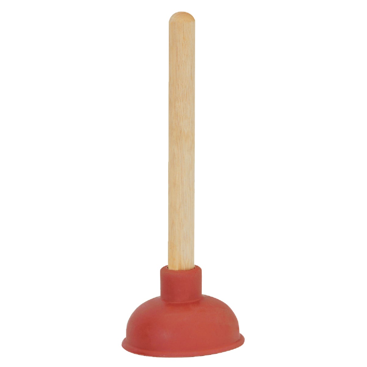

Cut out top of red plunger
  1. I have 3 that I picked up at garage sales or thrift store for a quarter or some such nonsense, even new at hardware supply cheaper than PE widget

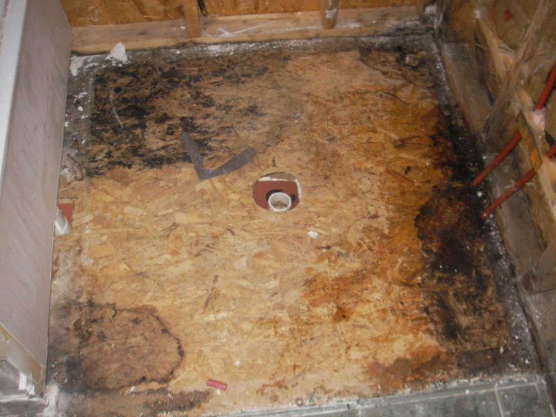

Check out this pic of a house I inspected last week. No tester would work on here.

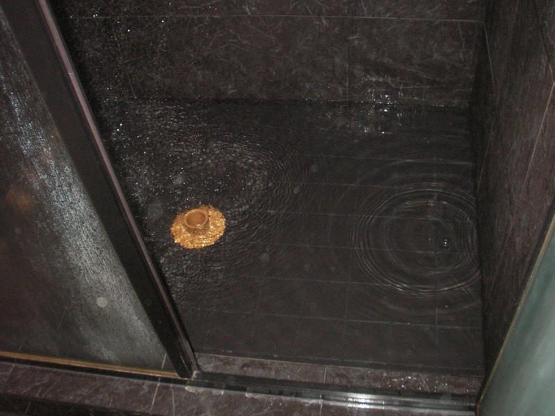

Its not all that scary, once the water get 2" high it reaches the top of the stopper, flows over and down the drain. I do this with both site built showers and shower receptors. When I first enter the bedroom the bathroom is connected to I head to the shower. I visually inspect the shower for damages, place the plug, turn the shower on, inspect the bathroom looking back at the shower from time to time, if its not full when I’m done with the bathroom I inspect the bedroom, when the shower is finally full I take a photo of the filled shower with the stopper. I let the water run with the shower full for several minutes, pull the plug, turn off the shower, if it’s upstairs I go down and check the ceiling/walls nearby, and I go back into the bathroom a few mintutes later to see if there is a delayed leak onto the floor.
I find about a dozen leaking per year, a site built shower pan can easly run between 3k to 6k (I had one leak Monday in a 3 year old 800k house), and I’m in the middle of fixing a leaky shower receptor right now for a construction client and that bill has hit 4k+.

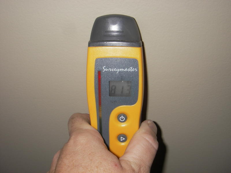

As far as the ceiling below goes there was not a single stain on the ceiling of the leaky shower I’m repairing, the owner saw it on the wall beside the shower, but my thermal camer and moisture meter nailed the water on the ceiling below. The ceiling on the one that leaked during Monday’s inspection was painted a color, the only ceiling in the home that was not ceiling white ( I wonder why).

I take pictures under the pan and use the moisture meter in the same finished areas. I do note in the report that " no present signs of leaks were noted at the inspection, however, these type of structures are known to leak and are very costly to repair." Thats about as much time I feel I have to spend on them. The stopper sounds like a good idea, but how long does it take for a leak to show itself in finished areas, alot of the time not in the two to three hour inspection.
