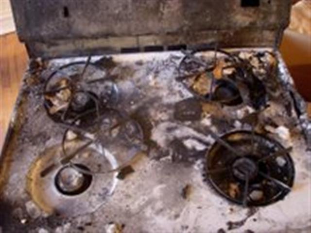

Funny coincidence …as I just got a call from someone regarding a stove fire.
He is going to send me pics tonight.

Other than being a Home Inspector , I also encourage peope to come to me for help .
I just had this photo E-mailed to me about one hour ago.
This is what can happen if getting involved is to much of a hassle.

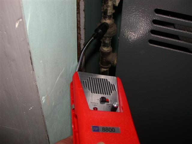

I have a tif 880A. It’s very very sensitive.
The tenant told me she had been smelling gas in the whole apt.
Four children.
I smelled it as soon as I opened the front door.
The HVAC unit was in a closet outside the apt unit, with a return that was cut into the closet as the duct was missing.
Look on the left for the wall vent cover to the interior.
[ATTACH]

If you can smell a leak Bob, why use the gizmo?
The tiff meters detect leaks about two magnitudes smaller than allowable.
Mechanical joints leak, period. Just because YOU can not detect a leak does not mean there are no leaks.
You want no detectable leaks, get a welded system.
With the proper use of pipe dope and/or teflon tape and the small amount of pressure (usually less than 5 psi.) actually on the gas line inside the home, there should be no leaks. Yes the Tiff is very sensitive and will pick up small leaks at several magnitudes lower than what would cause a problem, but a leak is a leak and should be repaired regardless of the size. I recommend that any and every gas leak I find be repaired by a licensed plumber.
Do I turn the gas off…depends. The LEL (lower explosive limit) for natural gas is 5% or 50,000 ppm in room air. We smell the mercaptan added to the odorless natural gas at around 1% or 10,000 ppm. The TIFF 8800 detects flammable gas as low as 50 ppm (.005%). Gas does readilly disipate into the air and a small leak will not build up in a large area fast enough to cause an immediate problem.
Without an exact measurement on the gas amount in the air, if the TIFF detects gas and I do not smell gas in a large area, it needs to be repaired but gas stays on. If the leak is in a small area (closet, utility room, etc) that could be closed off to allow the gas to build, the gas should be shut off if you can smell it at the leak(s). If I do smell the gas in the area away from the leak, it is at least 1/5 of its explosive limit and the gas should be shut off to get the leak safely repaired.
BTW, I also use a TPI775 that digitally displays between 50 and 50,000 ppm flamable gas to get a more accurate reading of the area.
