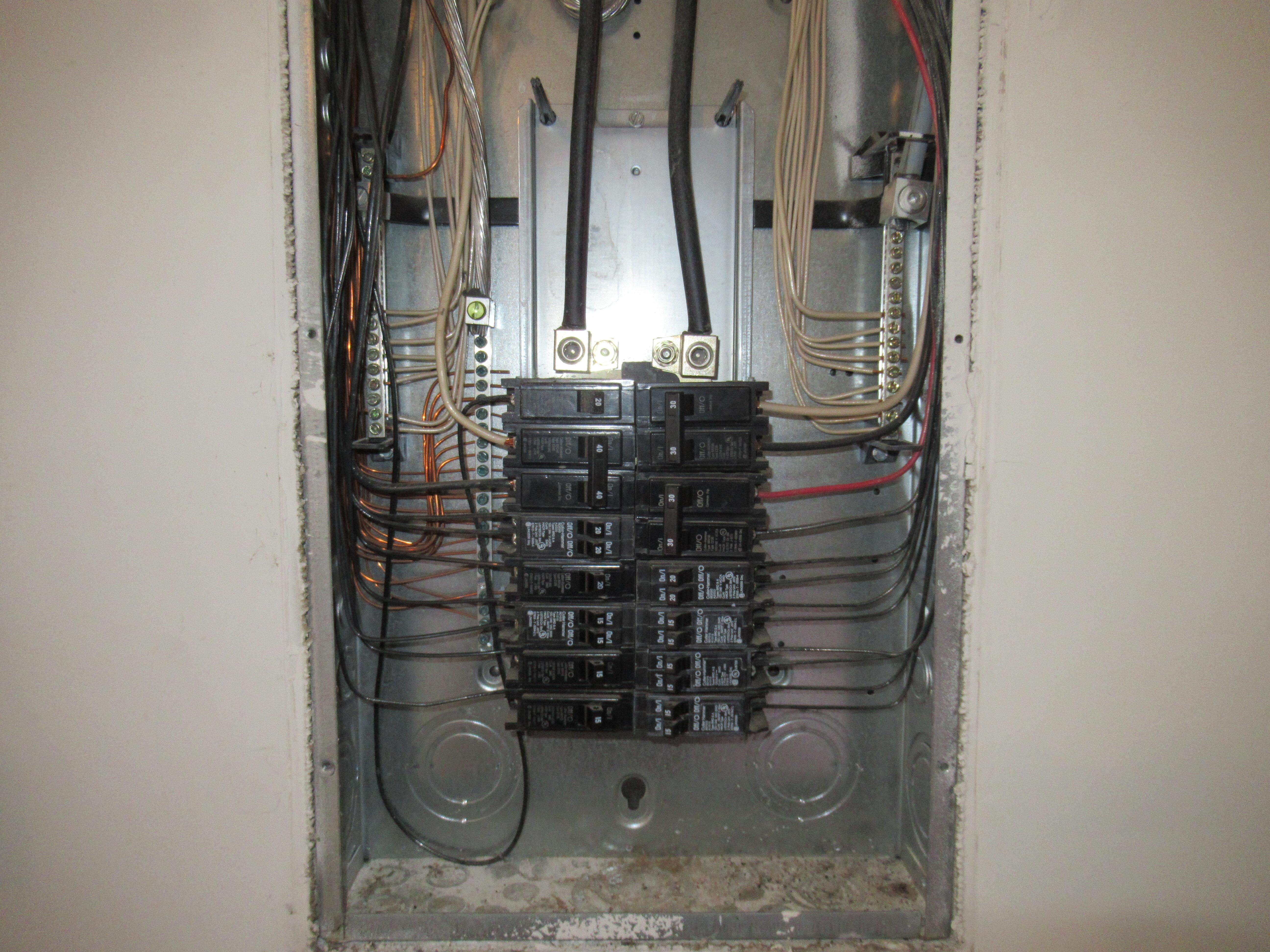

Hi All,
I came upon a situation that I haven’t seen before. I’m a fairly new inspector. The shut off switch is on the outside meter. In the panel the neutral and ground buses are separated except for one ground wire inserted into the neutral bus. This looked strange to me. Is it incorrect?

Yes, it is incorrect, the (the grounded and grounding) wires should be separated on a remote distribution panel.

Yes, the disconnect is at the meter. There is just one lone ground wire inserted into the neutral bus. Otherwise they are separate. I just uploaded the pictures. Thanks for your help.
I agree with Larry, that single bare conductor should not be there. Did you trace out where it went? It appears to be larger than a #10 solid conductor that would be in a cable. I would also be concerned with the bare equipment grounding conductors to the left of the neutral bus contacting the neutral bus.

Likely work done after the initial installation, some of the newer wiring is sloppier than the original wiring. Yes its incorrect.

250.24 Grounding Service-Supplied Alternating-Current Systems.
‘If’ the main service panel happens to be the same place that the grounded (neutral) conductor is bonded to the grounding electrode, then there is no problem mixing grounds and neutrals on the same bus bar (as long as there is an appropriate number of conductors terminated under each lug).
If the two bus bars are not connected; as would be the case anywhere other than the main disconnect ( exceptions exist ), then you cannot mix them.

There is an exception. From what I understand, you need to bond the neutral and ground ‘at the exterior’ disconnect and then run 4 wire feed to the interior panel which this panel appears to have.
Take a close look at the 4 feeder cables and the 2 neutral bus bars and ground terminal.
You are correct. Since this panel does not contain the service disconnect it is not a service therefore it requires a 4-wire feeder and the separation of the neutrals and EGC’s.
