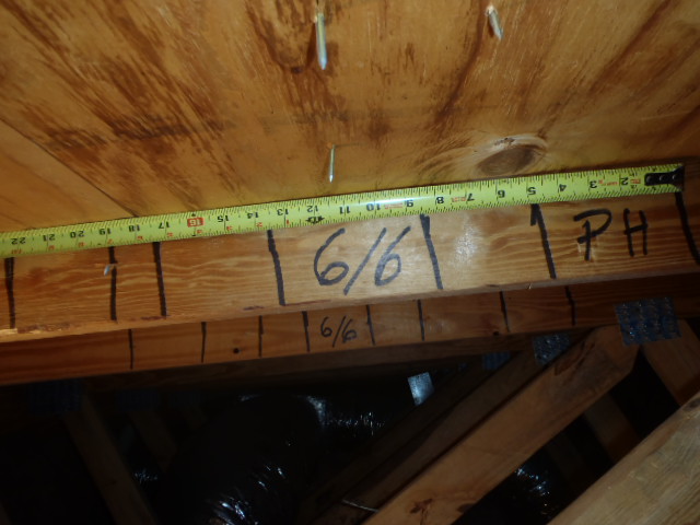

Spacing picts
The first two were taken done by the previous inspector. The second two were mine.
If you are doing to do a wind mit you should be marking in a clear 3-4 ft area.
I suggest all do what fits you best as an inspector.
I use a 6 inch ruler showing the distance between 2 marks and then the ruler acts as a scale.
I HAVE NEVER had a problem with my method and believe it is safer and easier to do than method above.
Also many cameras do not have a wide enough view for the pictures you take. Mine does.
Each inspector should prove it in his or her own way to AVOID standardization.
Standardzation makes all appear equal in the eyes of the client and makes them feel all should cost the same.
If you feel the way you do is best do it that way so you stand out.
DO NOT try to tell others how they should do it as everything being the same on every report is bad for all of us.
Just my 2 cents.

I posted it because some people would like to be better at their job. When I see reports(and marks) that clearly show the inspector did not know how to do a good job or did not want to I feel it makes us all look bad. In this case the metal gusset plate would interfere with their measurement marks. It is about getting it right, not about standardization. I am sorry you do not see that. Why is it you do not want to do a good job or the best job possible?
I fixed it for ya Mr. Anderson! :wink:
I have seen all different markings that put quite simply, cannot be possible. I posted one picture awhile back with 10 marks in a six inch space. What type of nailing pattern would that be?
If I remember correctly, at the conference John put on a year or so ago, he stated that the insurance companies were looking for a certain number of nails in a certain space ( 6 nails in a 36 inch space, I think).

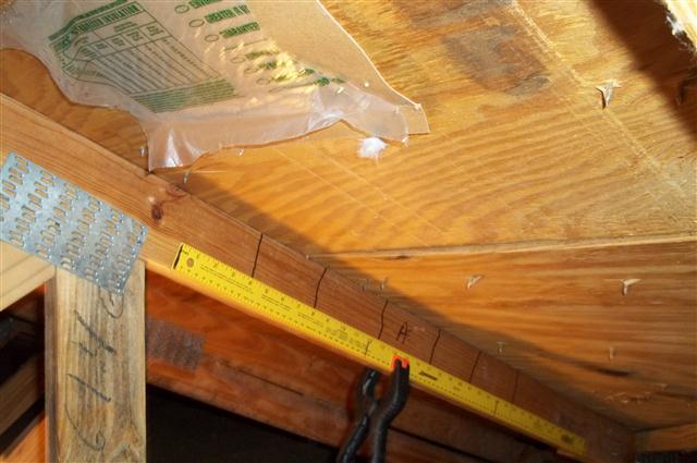

It would seem to make sense to use something that shows that, which is why I use a yardstick. Clamping it in place makes it easier to take the picture.

It depends on what you use on the scanner to make your mark. I use the side of the scanner. I know the center is what reads the nail but regardless the spacing is the same. My post only shows a short distance off the plywood seam but I do scan more than what are in my pictures. Sometimes due to the attic space you can only photograph so much.
I was questioning why you posted the pict we all could see the others work was terrible but i assumed you were saying your way was the only way. I did not take note that you were saying it should be done in open areas or spans.
Nothing wrong with my method as I to like darker marks but do not use the long ruler or tape method. it is difficult enough to get 2 trusses with marks in one shot. AS STATED BEFORE I have NEVER had problems with my marks and measurements.

I don’t try to get both trusses in the picture. I write A on one and B on the other. “Most” can figure it out.
i take more pictures than I use in the report and try to show 2 trusses WHEN POSSIBLE with the ruler on the front and next pict the back. If I ever have a question I can show the other pictures. Sometimes it is way to tight to do it.
