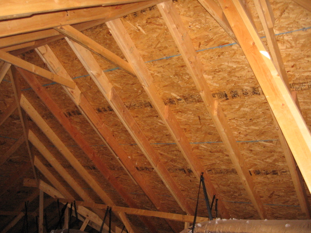

2005 construction. Spliced rafters observed in several areas. This was approved by city building inspector. I recommended further evaluation by a structural engineer. How would you report this?

In my opinion, and I know everyone will not agree with me, splices will work if properly supported. These splices were done in an ameteur fashion and I wouldnt want them in my house. Good luck in finding a 30 foot long 2x for framing here in Texas. Its hard to say, but is that a purlin support in that picture. If so it doesnt appear to be the same size as the rafter and some of the collar ties appear to be improper spacing. By the way, what was the spacing on those rafters?

I think that’s a gambrel roof showing on the right side of photo 2 not a purlin.

I was refering to the member near the a/c ductwork in the first picture about mid span. If it is purlin it doesnt look like it has sufficient bracing and looks like a 2x4.
Conroe! Holy smokes…you have to compete with John McKenna now, right? Austin’s still doing well, we have not been hammered by the RE down turn like other parts of the country (yet) and Sept was my best month so far this year. Anyway, I agree, that does look like a purlin in photo #1.
Spliced rafters are not permitted by the IRC, period, whether they work or not.
I can’t see any splices, all I see are 2x’s nailed to the sides of rafters.
Look closer. They’re definitely spliced.
That they are.
Looks like they used rafters from another building to build this one, but they were too short. ha. ha.

Yep. Yep, I had trouble, but see it now. Bad framing.
